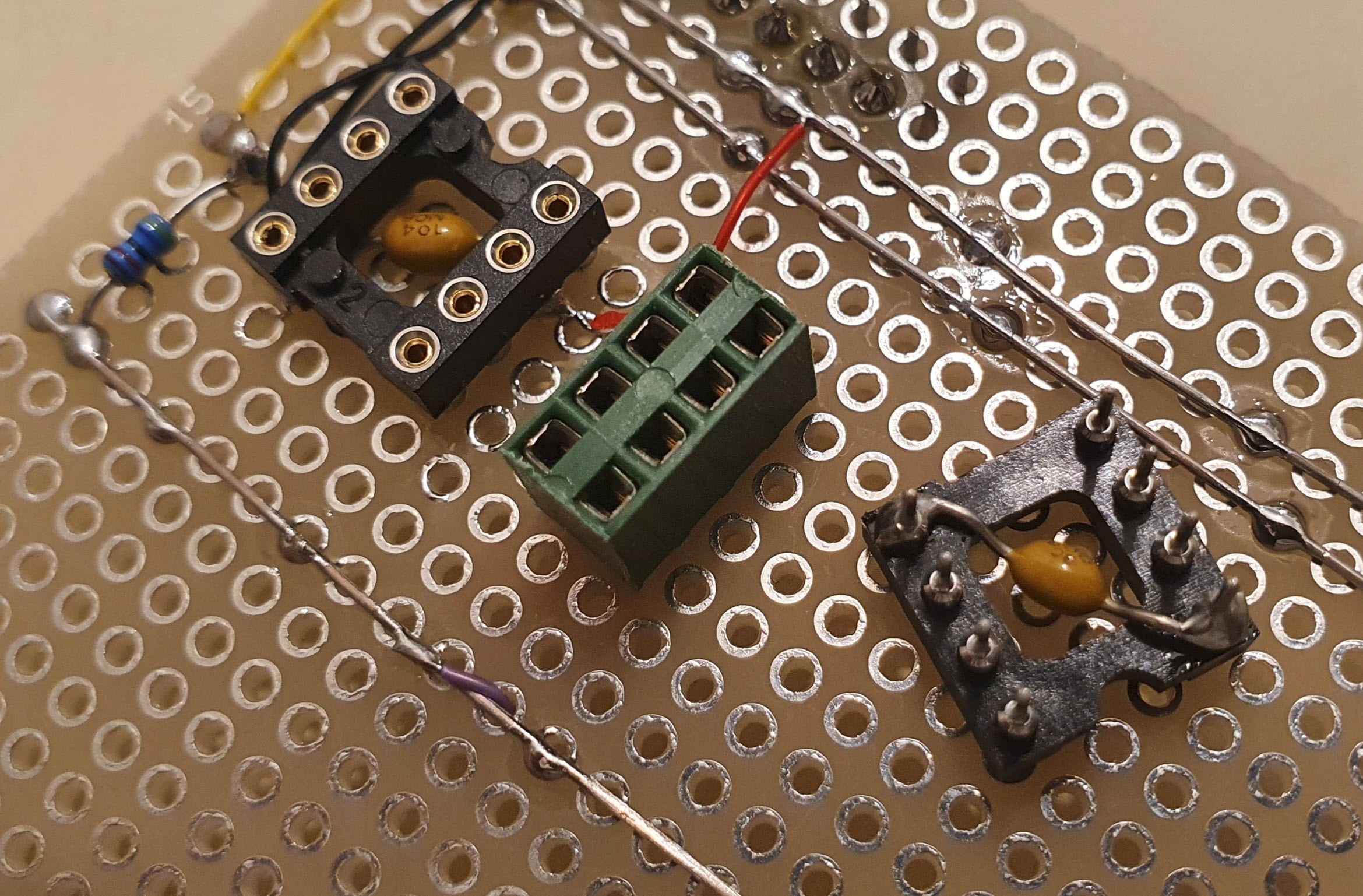

Op amp supply decoupling capacitors when prototyping
shabaz
shabaz over 4 years ago
This used to be popular with DIP logic ICs, but it can come in handy for op amp circuits too.. saves having to straddle the supply decoupling capacitor taking up valuable board space that's needed for all the resistors etc that are needed for the op amp configuration.

    Good, simple idea. Applicable I suppose to any IC that requires decoupling, particularly those with s datasheet thst says connect the VDD and VSS with a decoupling capacitor with as minimum a path as possible…

    Good, simple idea.  Applicable I suppose to any IC that requires decoupling, particularly those with s datasheet thst says connect the VDD and VSS with a decoupling capacitor with as minimum a path as possible (and then places these on pins 8 and 16)
