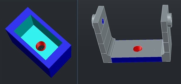

3D Mounts:
Designing and 3d printing the servo mounts had a few challenges to overcome.  Each servo manufacturer seems to have their own spline shape and size, so once you pick one, you're stuck with it.  My 3d printer doesn't print servo splines well either, the hotend tip diameter is 0.5mm.
I used some micro servos from https://www.banggood.com/
I had to go through several iterations to get a good part that printed well.  I found a way to make the 1/4in-20tpi base camera tripod thread during the printing process without having to cut the thread after with a tap.
My files for the FLIR DUO mount for a DJI phantom 2 are available here:
https://www.thingiverse.com/thing:2845703
The FLIR DUO is slightly smaller than a GoPro, so this mount will not hold a GoPro.

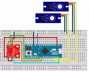

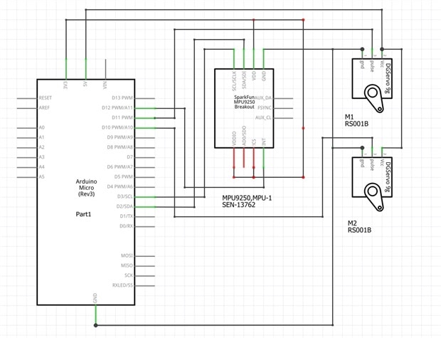

Hardware:
Here's the wiring thus far.  The Fritzing program didn't have the embedded masters MPU-9250 board, so I have the sparkfun board shown.
Note that the servos use +5VDC, and the MPU-9250 uses 3.3VDC.
