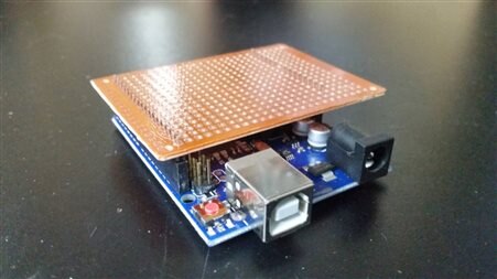

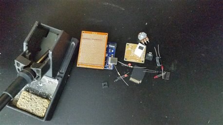

So I had a project in mind for a while I love working with lm386 chips and working on making better audio with it so I decided the best route to do that was to make a custom arduino audio player that I could connect my lm386 audio boards to it and be able trouble shoot design and test with it.  Having this available to test was a awesome making the SD Card player to test out my boards so I can incorporate them into further projects and assure they are working 100% before doing so.  Now why would I do that when the kids are really cheap?  Well because its fun and great for learning and teaching about electronics.  So I have decided to use this as my main prototyping setup for it and will add some features here and there as I get parts in so that I can fully use it to my advantage.  The Arduino is a wonderful tool to help with prototyping and designing with ease.  I certainly wouldn't have thought I would have gotten into them so much.  But I have, and grateful for being able to design and implement things quickly with it versus having to go other routes.  Plus if I blow a arduino its not going to be the end of the world instead of a expensive board that I might not be able to replace quickly.

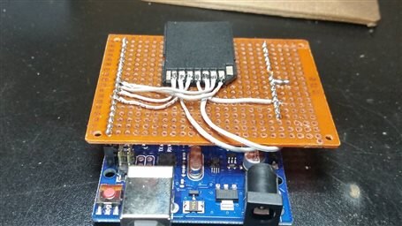

So I started with making the SD Card Reader / uploading the player to the arduino.  (I decided to use the pinout and files from Bitcows | DIY SD Card Reader and audio player for Arduino UNO )
Files needed to talk to the card to play music:  https://github.com/djmason9/TMRpcm
You will have to add this to your arduino library.
Connecting the pins as taken from the site there:
Arduino Pins | Card Pins
pin
10          | 7  | CS / DAT2 /
pin
11          | 6  | DATA IN / CMD
pin
12          | 1  | DATA OUT / DAT0
pin
13          | 3  | CLK / SCK
3.3v            | 4  | VDD / VCC / PWR
GND
| 5  | VSS1 / GND
GND
| 2  | GND

I used pin 9 on the board to output the audio file to the lm386 audio board, not sure if other pins would be more ideal but haven't tested this further.  I mounted it to the right hand side of the arduino so I would be able to solder and test and diagnose any issues I may have with out covering up the sd card area.  So now with my LM386 audio board on I had to wire it up I think I will make connector posts on the SD Card board after might be a better route as well a add a more suitable speaker setup for portability.  I used a 3.5mm headphone jack to output to my speaker. (I will be adding an on board output for the speaker at some point as well.)
