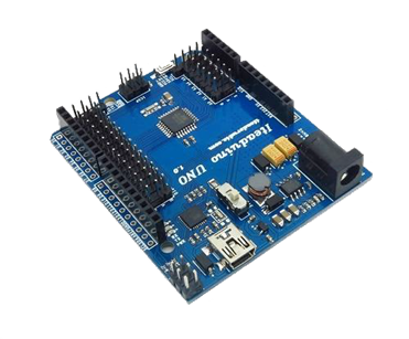

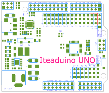

Arduino

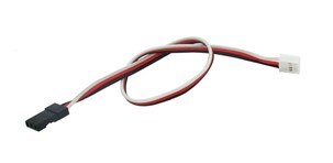

For these lessons we use the brick connectors, and these have a Grove style plug and one end, and a three pin female header the other.
The boards have the normal Arduino connectors but they also have three pins that provide Power, Ground and Signal for each of the I/O pins.
For I2C they provide a 4 pin header as well making it neat and easy.
While you can get shields to do similar, why add more and extra cost.
An additional feature of these 3rd party boards is the switchable processor supply so you can have it running 5v or 3v3 and connect 3v3 devices without having level shifters.
When you're doing the development of some projects this makes it really easy.

 Arduino Pin assignments
 Pin D0 Rx
 Pin D1 Tx
 Pin D2 Temp sensor DS18B20 data pin with 4k7 external pullup resistor to +5v
 Pin D3 Buzzer (Low to operate)
 Pin D4
 Pin D5
 Pin D6
 Pin D7
 Pin D8
 Pin D9
 Pin D10
 Pin D11  Relay (High to operate)
 Pin D12  Pushbutton (with onboard pullup)
 Pin D13  On board Led
 Pin A0   Rotary sensor (pot)
 Pin A4 (SDA) to SDA
 Pin A5 (SCL) to SCL

We use the "brick' style sensors from ITEAD studios as they are cost effective for the numbers we needed.
It removed any incorrect connection problems, but it doesn't stop the students plugging them in the wrong way or the wrong pin.
