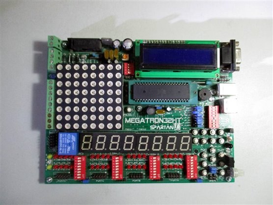

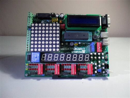

Megatron32:
It's a Development Board based on Atmega32 AVR microcontroller.
However Atmega16 and similar 40 pin AVR MCUs can be used too.
This board can be programmed using a C compiler.
I have used various IDEs like AVR studio, Bascom and MikroC Pro for AVR.
Recently I came to know and checked that Arduino IDE can also be used in case of Atmega32 and Atmega16 with additional header files.
It uses on board USBasp programmer to down load the hex file.
This board has some builtin sensors, displays, motor drivers but all the pins are accessible to the user through IDC10 terminals.
It can be directly powered by USB, whereas external supply can be used too.

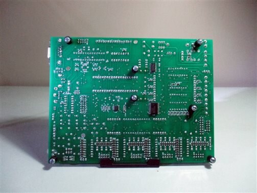

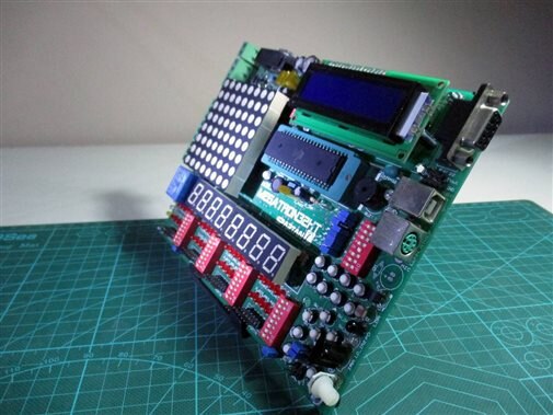

Top and Bottom views -

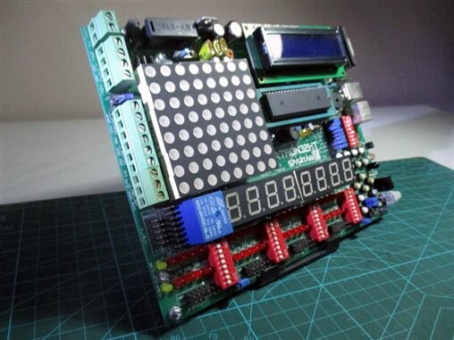

Side views-

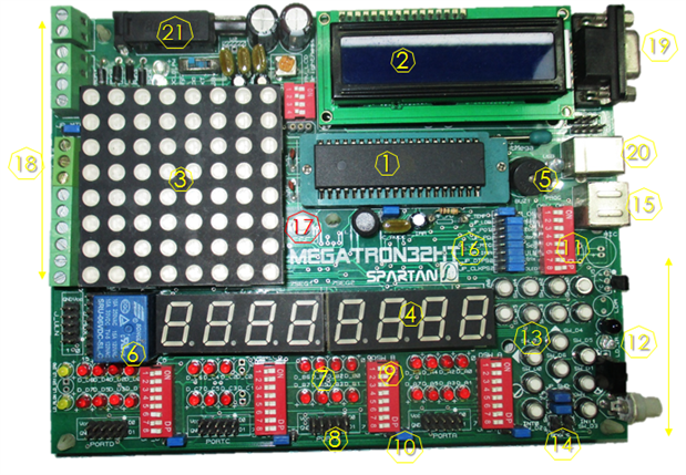

Hardware Layout:
1. Atmega 32 mounted on zif socket
2. 16x2 alphanumeric display
3. 8x8 Dot matrix display
4. 8 seven segment LED display
5. Buzzer
6. Relay
7. 8x4 LED for indication of PORT pins status
8. IDC10 header to connect external devices
9. DIL 8 switch to pull up or down PORT pins
10. Jumper to select PORT pin pull up or down
11. DIL 8 switch to enable onboard modules
12. Analog sensors and transducers
13. 8x2 button switches for digital input
14. Jumper to select button pull up or down
15. PS2 port
16. 8 jumpers to isolate analog circuitry from digital i/o of PORTA
17. Reset switch
18. Terminal blocks to connect external power and Dc motor [4]
19. RS232 port
20. USB port for USBasp programmer
21. External 5v 2A supply

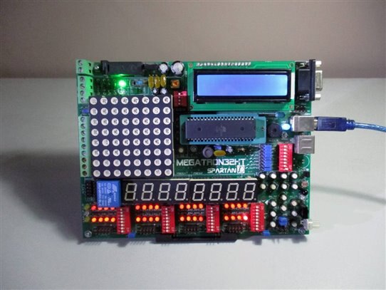

Blink LEDs -image
As usual the very first code is to blink LEDs. image Target is to toggle all the PORT pins on every 0.5 seconds.

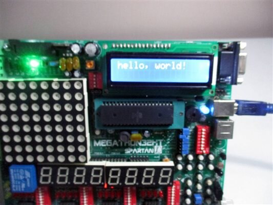

hello, world! -image
The 2nd code is the LCD library  project. It displays the "hello, world!" on the 16*2 LCD display and scrolls through out the screen.

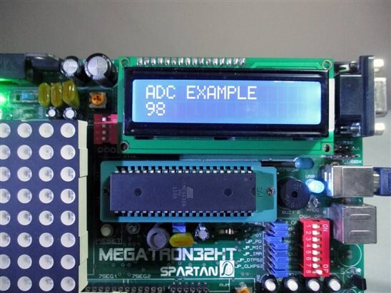

ADC example -
The third code that I tried is the analog input project. It reads the voltage from a Potentiometer connected to ADC[2] and then toggle PortB.0 [digital pin 0 in Arduino].
The delay between the output switching/toggling depends on the analog voltage [ADC value], which is displayed on the LCD.
In this board, PORTB.0 [digital pin 0 in Arduino] is connected to a buzzer, so this code will generate a pulsatile sound which can be varied by the potentiometer.

  // declare the ledPin as an OUTPUT:
  pinMode(BUZPin, OUTPUT);
  // set up the LCD's number of columns and rows:
  lcd.begin(16, 2);
  // Print a message to the LCD.
  lcd.print("ADC EXAMPLE");
void loop() {
  // read the value from the sensor:
  sensorValue = analogRead(sensorPin);
  // turn the ledPin on
  digitalWrite(BUZPin, HIGH);
  // stop the program for  milliseconds:
  delay(sensorValue);
  // turn the ledPin off:
  digitalWrite(BUZPin, LOW);
  // stop the program for for  milliseconds:
  delay(sensorValue);
  lcd.setCursor(0, 1); // bottom left
   String stringOne =  String(sensorValue);
   lcd.print(stringOne);
   lcd.print("  ");
Attached video contains the demonstration of some sample codes for MEGATRON32.
