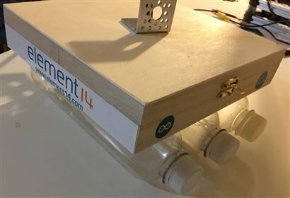

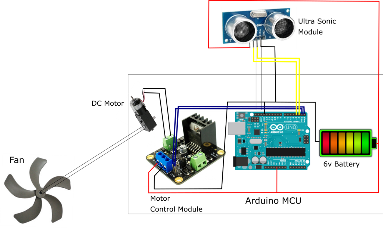

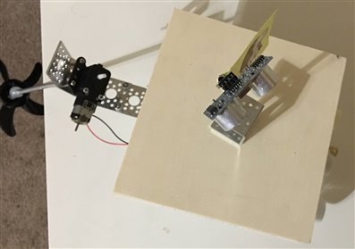

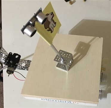

Cycloboat is a recycled boat robot that uses plastic bottles to float on water.

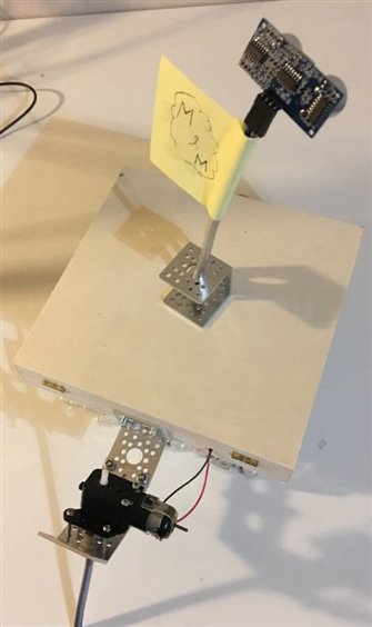

It can detect objects and avoid it using ultrasonic.
I will be posting more videos with some more description later.

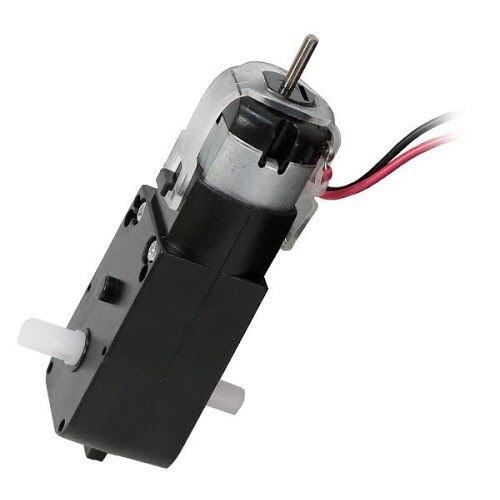

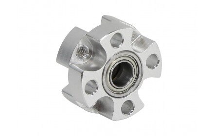

1. Right Angle Gear Motor: voltage is 4.5-6V with a no load current of 190mA, output shaft is 9mm long and the gearbox ratio is 48:1 with a wheel speed of 140 RPM (unloaded)
2. Dual Ball Bearing Hub

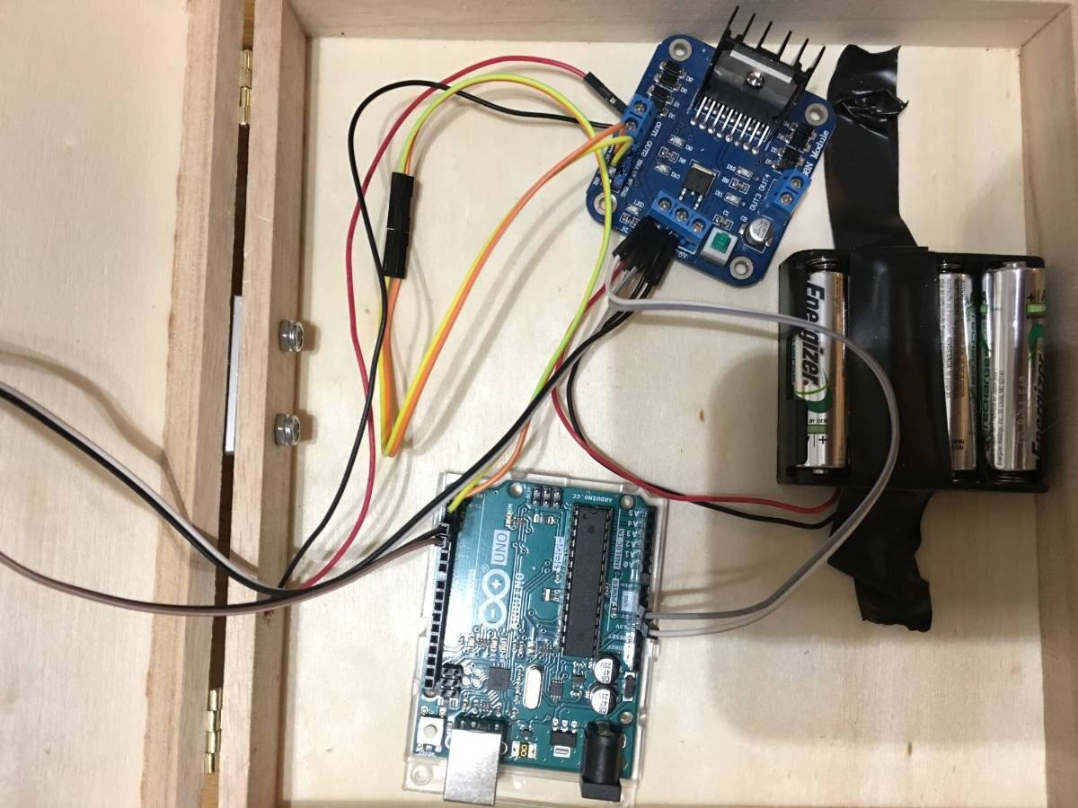

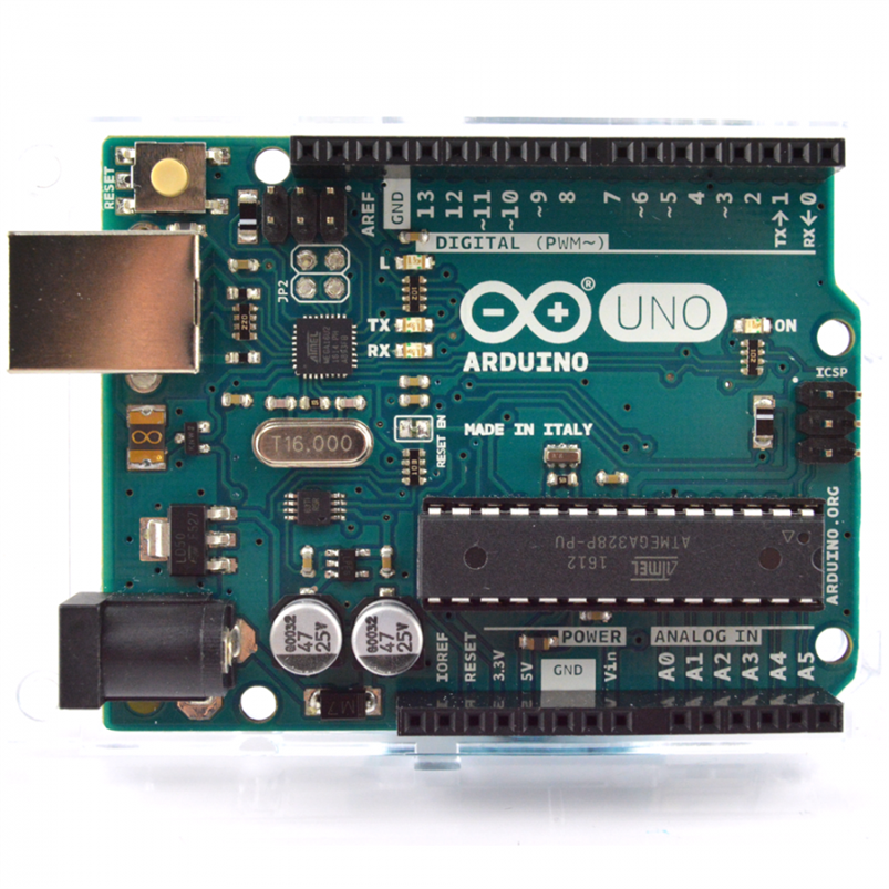

3. Arduino Uno as a brain and control system of Cycloboat

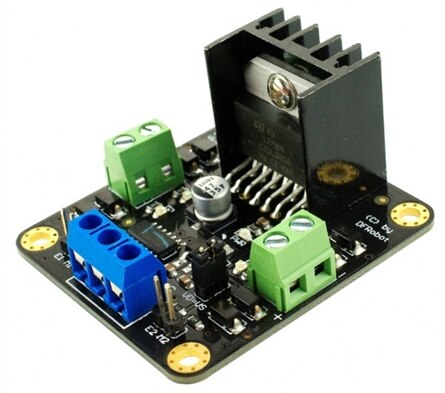

4. L298N Motor Drive Controller Board Module Dual H Bridge.

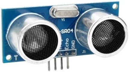

5. Ultrasonic Module
6. Batteries 4 x 1.5v each total of 6v dc
7. Fan recycled from old fan
8. Sealed wood box.
9. Aluminum Pole and mounting channels hub.
10. Recycled plastic bottles X 3.
Figure (1): Right Angle Gear Motor
Figure (2): Dual Ball Bearing Hub
Figure (3): ARDUINO UNO MCU ATMEGA328p
Figure (4): L298N Motor Drive Controller Board Module Dual H Bridge.
Figure (5): Ultrasonic Module.

Full System
Code:
$regfile = "m328pdef.dat"
'$regfile = "m16def.dat"
$crystal = 8000000
Config Pind.2 = Output : Dc1 Alias Portd.2 : Reset Dc1
Config Pind.1 = Output : Dc2 Alias Portd.1 : Reset Dc2
Config Pind.3 = Input
Config Portd.4 = Output
Portd.3 = 0
Portd.4 = 0
Dim Distance As Word , W As Word , I As Byte
'-----------------------[LCD Configurations]
Distance = 0
Cls
Do
Pulseout Portd , 4 , 20                                     'Min. 10us pulse
'Waitms 100 'meant for testing error
Pulsein W , Pind , 3 , 1                                    'read distance
Incr I
If Err = 0 Then
W = W * 10                                                  'calcullate to
W = W / 58                                                  ' centimeters
'W = W / 6 ' milimeters
Distance = W
Gosub Move_backward : Waitms 200
Else
Distance = 0
Gosub Move_forward : Waitms 200
End If
Waitms 200
Loop
Return
'--->[Move Renbot with 4 motors forward]
Move_forward:
   Set Dc1 : Reset Dc2
   Waitms 100
Return
'--->[Move Renbot with 4 motors backward ]
Move_backward:
   Reset Dc1 : Set Dc2 :
   Waitms 100
Return
First test:

    Hi Molham, A great idea. I was particularly taken though with those neat pre-drilled brackets, and when I searched for 'dual ball bearing hub' I found a site that makes them....they look really useful…

    Hi Molham,
    A great idea. I was particularly taken though with those neat pre-drilled brackets, and when I searched for 'dual ball bearing hub' I found a site that makes them....they look really useful and I'll have to do some more browsing regards purchasing some from the UK.
    Good luck with the design and please keep us updated image
    Rod
  • Molham
    Molham over 8 years ago in reply to 14rhb
    Thank you, you can buy them from the state as wel I am not sure of you actually live in UK they are on servocity website.
  • Molham
