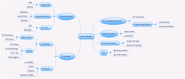

Concept
It was obvious that I'd use an Arduino as the controller, and wireless power outlets as the device to replace the mechanical timers.
The issue was how to program it, and get that information into the unit with the skill set I had. (it was 2012)
This Design process was a piece of software on my tablet, and I found it very useful to draw out the various options.
( I must start using it again )
As you see from above, the choices for the controller were standard with shield or add-on cards, or special version Arduinos.
I'd put this as Step 2 in my Electronic Diet - Engineering a Solution blog
I identified that an SD card could hold the data, and was able to be removed and programmed with the times, etc.
Keeping time was going to be handled by an RTC.

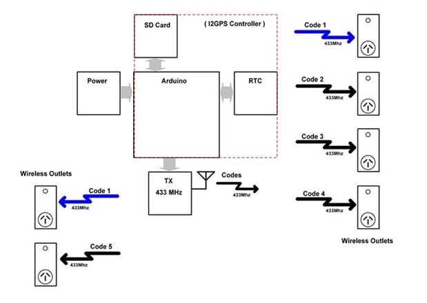

Initially we thought about hacking a remote control to provide the 433MHz RF, but while looking around I stumbled across RCSwitch
https://github.com/sui77/rc-switch
This allowed an Arduino and RF transmitter to communicate with these outlets, which also allowed more codes than the remote had.
Hence the following block diagram became the plan.
Having a plan always makes it easier to focus on the various parts required.

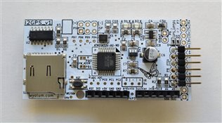

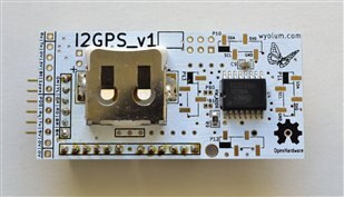

I identified that we would use an Arduino, but needed RTC and SD card along with a connection to the RF Transmitter.
We had in mind that this would be useful to readers so a complicated build was out of the question.
Luckily I ran across some clever guys at Wyolum (sadly the website is not around any more) who created a nifty board that slotted into an Arduino to interface with a GPS receiver.

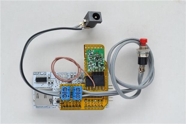

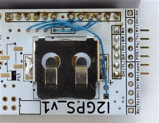

It included the microSD card, RTC and had a few I/O pins to interface to the outside world.
I did run a few jumpers to connect the Analogue inputs to the header where they normally would reside.
     PC0 to P5 pin 1, PC 1 to P5 pin2, PC2 to P5 pin 3 and D to P5 pin 4 along with power to where Vin would be.

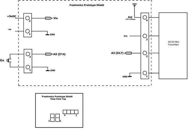

The transmitter and connectors were fitted onto a piece of a prototyping shield.
The button is used to start it running.
Programming is via an FTDI cable.

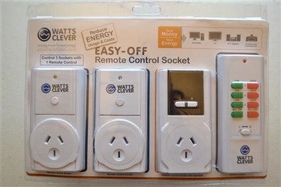

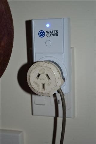

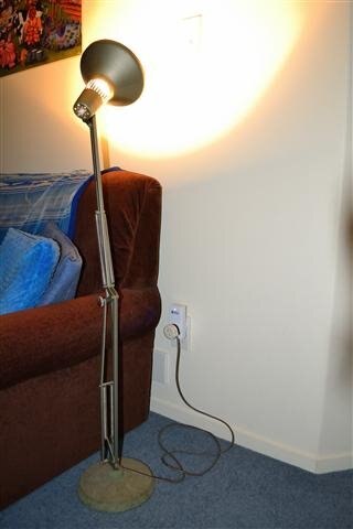

OUTLETS
I used the WattsClever and discovered that they could be programmed for codes greater then the remote provided.
The codes are attached below
It appears that bit 21 is changed between the On and OFF, so it's very easy when controlling these devices.
One of the units had a light, and it seems that all the units have two channels, with bit 24 controlling the 2nd channel.

The outlets can't be placed too close to each other as they interfere, so the placement for a video to cpature both might need some thinking.
*** video to come ****
I do have some photos showing a single light placed in the Hobby area which is near the front door.
Yes my plug looks rather battered ...
The result of just this light on from outside is :-
So careful placement of the light could give anyone the impression that someone was home.
Feel free to ask questions ... after you download the zip file ... and I'll do my best to answer them.
