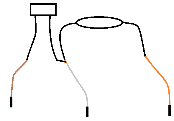

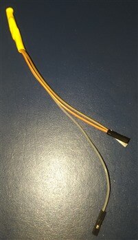

Next, let's get the light-sensitive resistor ready.
For this you will need:
The photo-resistor
3 Header wires (different colours) - I will use grey, brown, and orange here.
The 10K OHm resistor.
Soldering iron and solder.
Heat shrink tubing.
Prep the header wires just like you did for the RGB LED.
Solder one end of the grey wire to one lead of both the photoreistor, and the 10k resistor.  Solder each of the other wires to the remaining leads of the photoresistor and resistor.
Here is a simple diagram:
In this case the brown is for 3.3V, the grey is the analog output, and the orange is ground.
When you are done it should look something like this:

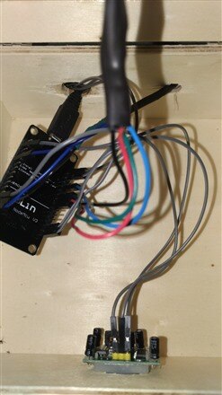

Now we can hook everything up!
The RGB LED will connect like this:
The white (or black) wire should be connected to a ground (GND) pin on the ESP8266.
The red wire connects to pin D5.
Green connects to pin D6.
Blue connects to pin D8
For the photo-resistor:
the grey wire connects to pin A0
The orange wire to another GND pin.
The brown wire connects to a 3V pin (this is 3.3volts).
For the DHT11:
+ goes to a 3V pin.
- goes to a GND pin.
out goes to pin D1.
Finally, for the PIR:
VCC goes to the VU pin.
GND goes to another GND pin.
out goes to pin D0.

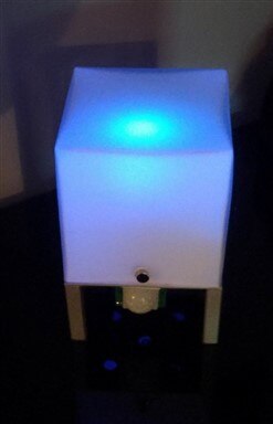

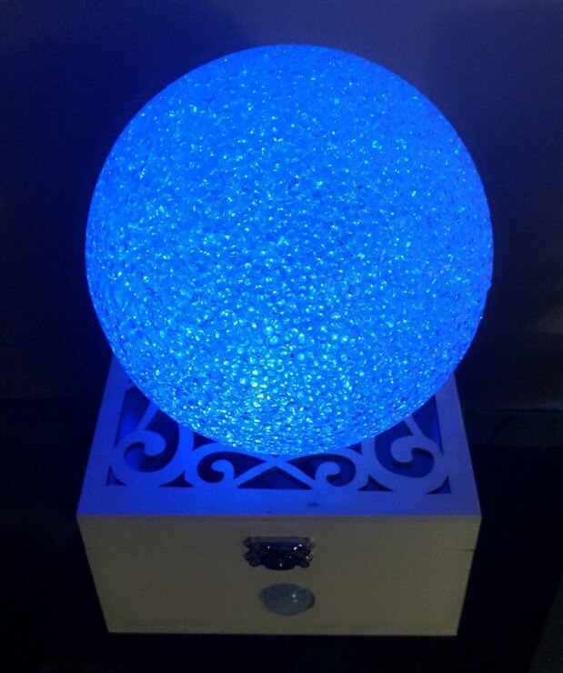

You should arrange the sensors in your enclosure so that:
  • The DHT11 and the photo-resistor are on the outside, preferably out the back where it will not be seen.
  • The motion sensor is pointing towards the area you want to track.
  • the RGB LED will light up whatever feature you decided on.
Here is how it looks in my example:
And here is the same hardware in a lamp I found in a thrift store - I gutted the light and put my own stuff in it:
