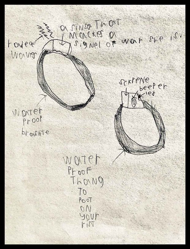

My grandson recently came to visit and was excited to tell me that he had a good idea for a project that also served a pressing need.  Specifically that his two year old sister was constantly getting into things (e.g. the Lego project that he had just completed) and it had to be stopped.  I asked him to draw up a proposal and here it is:

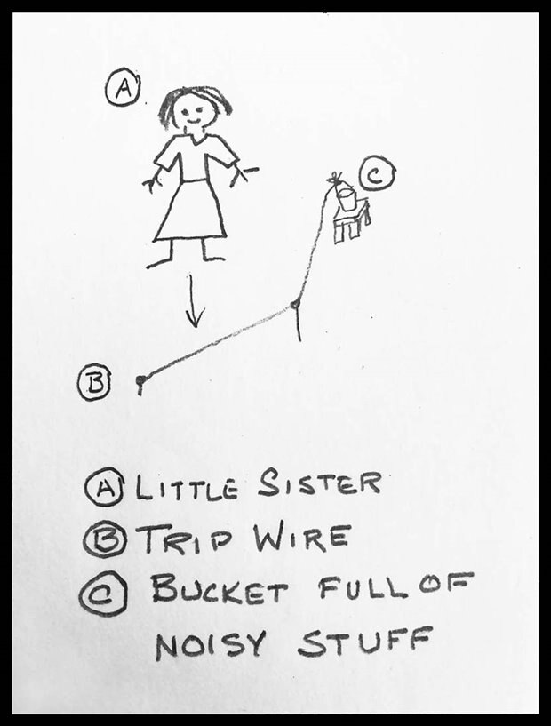

He is just learning to read and write so I will interpret it for you.  The object in the upper left is a waterproof bracelet that transmits the location of the toddler by radio.  The object lower right is a waterproof thing that you can put on your wrist that has a screen, beeper, and LED to alert you when the toddler is somewhere she shouldn't be.  They are waterproof because they are planning to go to a waterpark and it might get wet.
Back in the day, when I was a boy and way before the Arduino, I would have solved the problem like this:
It pretty well explains why I became a mechanical engineer and not an electrical/electronics engineer or computer science major.  Clearly this will not do and an Arduino is required.

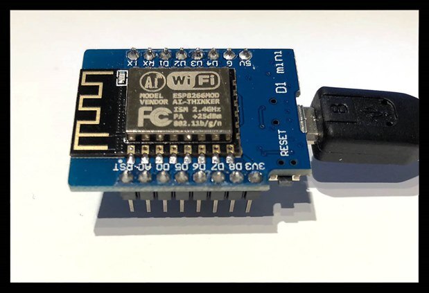

ESP8266
This project will use the Wemos D1 mini, an easy to use ESP8266 board that can run on the Arduino IDE and is shown above.  They can be purchased from the usual Chinese and internet sources.  The github page is here for the Arduino implementation and it also has links to documentation and the boards manager.  I had no problem installing it via the boards manager in Arduino 1.8.4.  I did run into a conflict with my virus protection software (McAfee) which occasionally would not let it compile on Windows 10.  Microsoft virus protection ran without a problem.

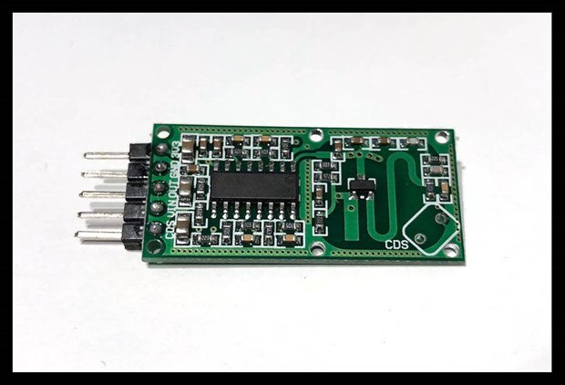

RCWL-0516
Shown above is the RCWL-0516 "radar" sensor.  Once again, Andreas has a YouTube video on these sensors which he covers in episode 135.  There is considerable discussion on the internet about how these work and whether they are really radar and I suggest interested persons to google.  In addition there is some very good discussion by element14 members in the comments below.  The origin of the RCWL-0516 seems to be detection for turning lights on and off in a way similar to how PIR sensors are sometimes used.  They are quite inexpensive and again can be found in the usual Chinese sources.  An interesting feature is that they can "see through walls" as I will demonstrate shortly in a video.  A simple sketch I developed can be found here on Github.  It sends message to the serial terminal when motion is detected.  Note that there is a pause between readings that is set by the sensor and cannot be changed in the code.

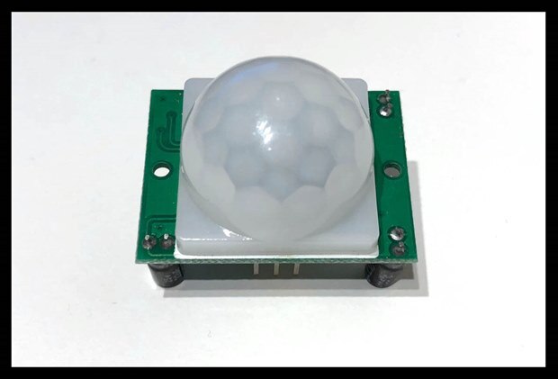

PIR Sensor
Members of element14 will be familiar with PIR sensors and their use.  The PIR sensor I used has a delay set by the hardware before it signals high again after a trigger which cannot be changed in firmware.  I have posted my own short sketch on Github for the ESP8266.

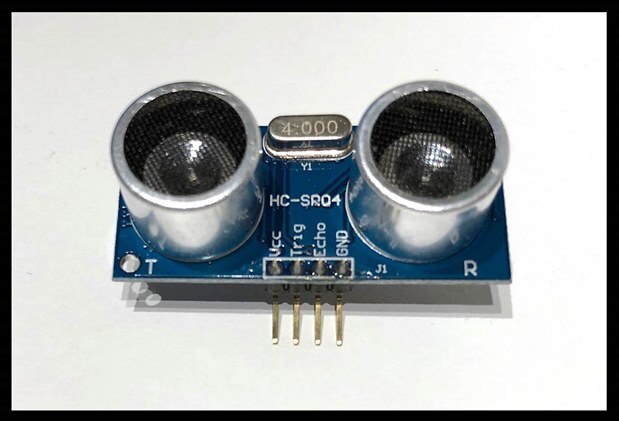

HC-SR04
Again, I imagine that most element14 members and users of the Arduino are familiar with Ultrasonic sensors as seen above.  The inexpensive version here is readily available from Chinese sources.  The theory is described in some detail in my Github code for the ESP8266 linked here.

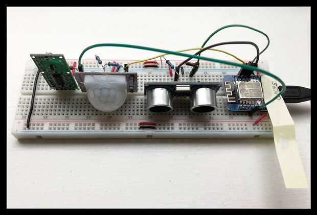

Sending Unit
It is time to put it all together and the sending unit can be seen above.  From left to right there is the RCWL-0516 radar, the PIR sensor, the ultrasonic distance sensor and the ESP8266.  Note the voltage dividers being used to protect the 3V3 pins on the ESP8266.  All of the sensors are being powered by a 5V rail coming from the ESP8266.  The pins being used are the same ones outlined in the individual sketches above.
My code can be found here on Github.  If you have worked through the sketches above it shouldn't be too hard to follow but I am available if there are questions.

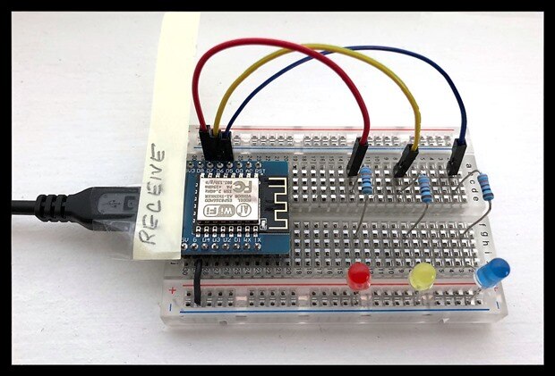

Receiving Unit
The receiving unit can be seen here.  Left to right is the ESP8266, a red LED that toggles when the "radar" goes high, a yellow LED that toggles when the PIR goes high, and a blue LED that toggles when meaningful changes occur in the distance sensed by the ultrasonic sensor.  Output is also sent over the serial connection to the Arduino terminal if connected.

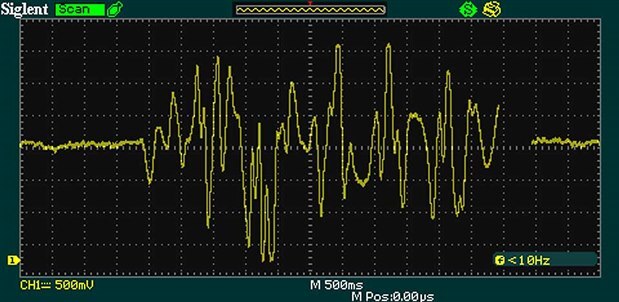

Exploring the Analog side of the RCWL-0516
The RCWL-0516 has an IC onboard labelled RCWL-9196.  Pin 12 of the IC has the amplified analog signal from the antenna.  When connected to the oscilloscope we see activity like that in the figure below.
When there is no activity the trace has an offset of about 1.7 Volts.  When movement is detected excursions of plus / minus 1.7 Volts around the offset occur with high activity.  Higher activity closer in gives the greatest excursions and this can be used to indicate activity in addition to that indicated by the LOW / HIGH digital output.  A simple Arduino sketch was written which reads the analog signal and can plot it or output it to LEDs indicating the level of activity.  Further discussion of the development can be found in the comments below.

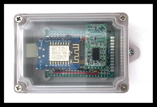

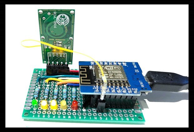

Prototype
A prototype was built on 4 x 6 cm plated through-hole perfboard that would be more permanent and rugged.
Note the yellow lead which attaches to pin 12 of the IC on the RCWL-0516 and the analog pin on the ESP8266.  I've also added LEDs for this version which indicate the analog signal strength as read on the analog pin of the ESP8266.  The red LED triggers at about the same point as the digital output of the sensor and the code is located here. The layout can be rearranged with the sensor laying down and placed in a enclosure for additional protection.
