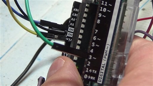

The Arduino Uno:
To prototype this design, we used the Arduino Uno - but not just any Arduino.  This was a made in Italy version found on Element14.  What makes it special is the headers are labelled.  You don't know you miss that feature until you experience it the first time.  If you have an Arduino nested in the belly of a robot, you'll definitely want this style.  You can see the pin labels from any angle - perfect for prototyping as well!
Arduino Uno with Header Labels for All Viewing Anglesimage

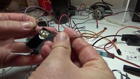

The Motor:
We needed a high torque, small motor.  A Servo motor came to mind because of their good gearbox.  They are actually just a hobby motor that spins fast.  With a few plastic gears between the motor shaft and the output shaft, they become a slower turning, high torque means of rotation.  The servo output shaft is direct coupled to a potentiometer which tells its circuit board how its position.  However, they typically only have 180 degrees of rotation and are designed to seek a point in the rotation and hold the position.  What we need is infinite rotation that we can control the speed of.  So, we did a little modification.
We had a couple of broken servos laying around.  We combined parts to get one good set of gears.  We removed the potentiometer and circuit board altogether.  We now have a high torque, DC motor in a tight package.
Marshmallow Rotisserie Repurposed Servo Motor - Modified to be a High Torque, Variable Speed DC Motorimage

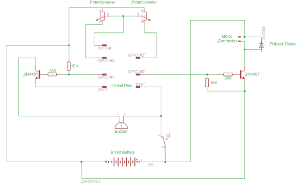

The Resulting Circuit:
As always, we captured the circuit in CAD - in this case Autodesk Eagle.  This allows us to remember what we did, but also gives us the option to order a custom PCB if we desire.  It also does some design checks and can allow us to make a 3D version of the board to aid in the end package design.
Marshmallow Rotisserie Circuitimage

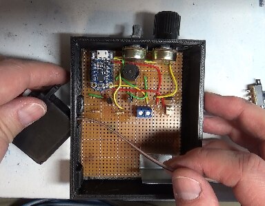

Step 4:  Populating the Proto Board
Populating the board is always a fun, therapeutic thing to do.  Using a highlighter with the printed circuit, I went after one connection at a time.  Using an ohmmeter, I made sure there were no short circuits or bad solder joints - which there were a few!
Once it all tested, I used conformal compound.  The compound I have brushes on, but they are more commonly found in spray form.  This puts an invisible, nonconductive, water resistant protective layer over the exposed circuits to prevent a mishap.
Marshmallow Rotisserie Protoboard Populated with all Components

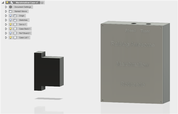

Step 5:  Designing the Case
We always design our mechanical side with Autodesk Fusion 360.  This is in our top 5 must learn software to be awesome.  You may find our 3D Printer files linked above.
To start, we made all parts.  We didn't need to be overly detailed.  We just had to get the "obstruction" geometries in place so we could build the case around it.  So, we made a primitive looking servo and perfboard.  We used a digital micrometer to precisely design it.
Here are our top tips for Autodesk Fusion 360:
    • Never delete a body or face.  Instead, use the remove feature.  This will preserve the timeline.
    • When extruding your first sketch, have it make a new component versus just a body.  For any bodies you have, be sure to make them components or move them into an existing component.  Stray bodies looks rookie.
    • If your part will have text, be sure the font is large so the 3D printer can lay at least 3 rows of filament to make each character.  Raise it at least 1/8" off the surface.
    • For parts that won't be printed, but are needed for sizing your printed part, only spend time on the detail you need or you'll just be wasting time.  Often, you just need simple blocks or cylinders to serve as reference obstructions and cutting tools.
    • Before modifying a body, consider modifying the sketch way back in the timeline that created it instead.  It's awesome.
    • When sketching, use dummy lines from reference faces to precisely land center points for circles and rectangle corners.
    • For cutouts where components will be installed, chamfer the edges so the opening is wider on top.  This will give you a tolerance to allow a tight fit within minimal filing.
    • If you need it to have strength, add fillets to corners.  Also, "webbed" parts such as you see with crane booms and bridges are more sturdy than printing solid.
Marshmallow Rotisserie Autodesk Fusion 360 Designed 3D Printed Caseimage

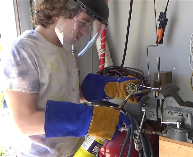

Step 6:  Making the Marshmallow Stick
The Marshmallow Stick had some design needs of its own.
      • We don't want to thread a marshmallow 3 feet down a stick - ewwww
      • The stick should not not melt or burn
      • It would need to be light enough for the servo to drive it
      • We don't want the marshmallows sagging and spinning once the center melted
      • We want to do up to 4 marshmallows at once
So, we with 1/8" carbon steel rod to make it.  You can pick it up at a home store for around $3.  We bent it such that marshmallows could be inserted on the axis (for even roasting) without them having to be pushed down the entirety of the rod as shown here:
Marshmallow Stick being Soldered with MAPP Gas
We used MAPP gas and solder (for sweating copper pipe) to join it all together.  There is no concern with the soldermelting at the fire pit because if we were hot enough to melt solder, we'd long burn our marshmallows to dust.

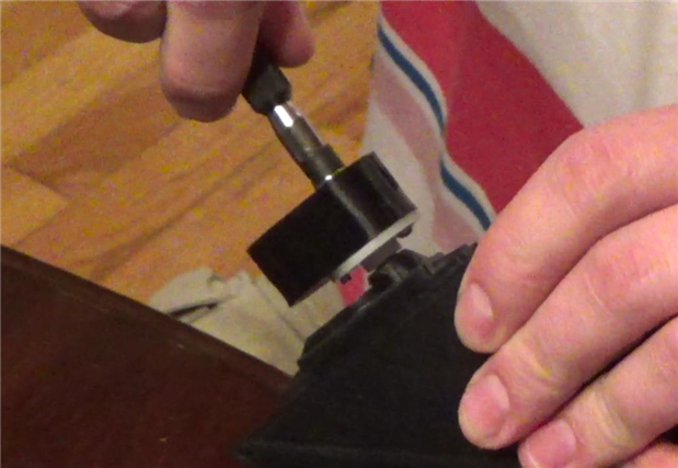

Step 7:  Assembly
With the precise measurements using the caliper to design the 3D printed parts, assembly was a breeze.  We just slid the potentiometers into the holes on top first, did a little filing for the servo to fit, and it was quickly together.  We used the other scrap servo's case screws to screw on the lid.  They are so small in diameter, you hardly notice them.image
Assembling the Populated Perfboard to the 3D Printed Case
To connect the marshmallow stick to the servo, we 3D printed a hub.  It was then screwed to a servo horn, which was then screwed to the our motor output shaft.  The splined end of the shaft kept it firmly in place with no slipping of the hub or stick.
3D Printed Hub Screwed to a Servo Horn to Attach the Stick to the Motor
