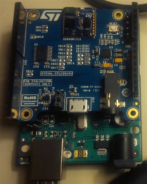

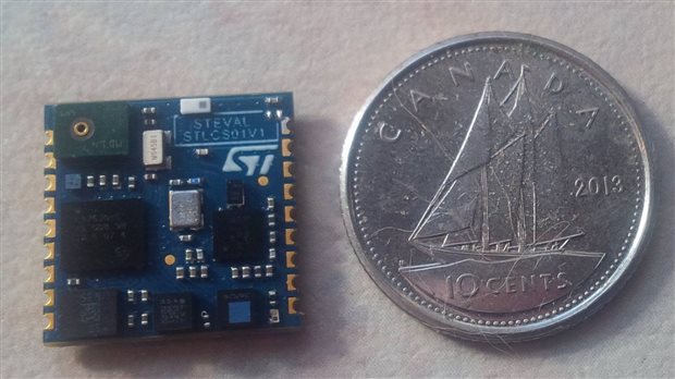

I am using a STEVAL-STLKT01V1 development kit. The sensor tile is the smallest IOT module I have seen. The sensors I am going to focus on are:
1. LSM6DSM - inErtial module, 3D accelerometer and 3D gyroscope
2. LSM303AGR - eCompass module with a 3D accelerometer and a 3D magnetometer

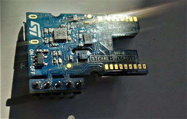

When Element 14 sent me the Arduino Uno I had no idea that I could program the sensortile using Arduino sketches. That simplifies the programming process and certainly makes it easier. The Arduino Uno has a connector layout and it was just a matter of attaching the sensortile cradle expansion board on top of it and then attaching the sensortile.

Once the Sensortile has been programed than I will solder the tile to a smaller cradle. The cradle will be powered by a tiny battery and be placed in a plastic case.
