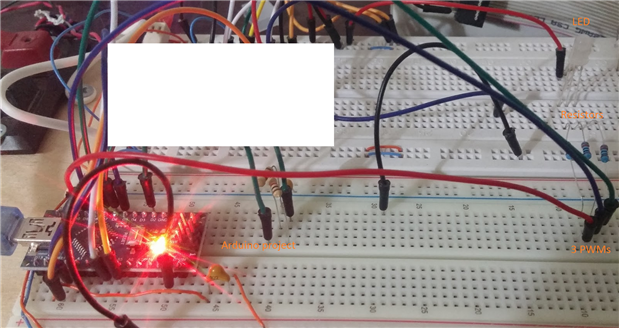

And goes like this on breadboard:
I removed some unrelated circuitry from other projects that still on my breadboard

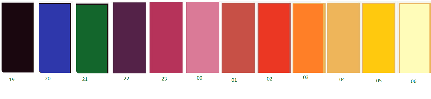

How to remember colour-hour index?
Since remembering 24 colour by heart is too much I thought using some nice colour palette that will represent sunrise/sundown so remembering the exact hour won't be that hard.
Also, I don't really need 24 hours but only dark hours, so I only included 19:00 -> 07:00 hours.
My draft is:

For start, I would like to say I accidentally connected the RED pin to a non-PWM pin in arduino (pin 8), I moved it to pin 6 and now the colors are much more rich than I thought. +1 to cheap RGB led image

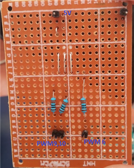

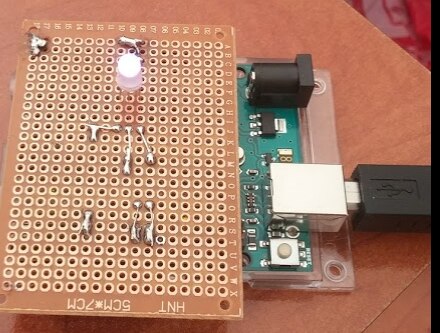

Making it like arduino brick
I have decided to try and build the module as an arduino brick.
The pins of the board will suite exactly in the right arduino's pins so it will be easy to make it portable and extensionable.
In the video below you can see clearly how the brick fits inside the arduino uno.
I also provided debug hooks for allowing to test the colors of the LED in a more quick way
By pressing r,R,g,G,b,B one can change the values of the LED for finding better colors as he wish.
Prints to serial are also included, I also made the debug code enabled with macro for saving MIPS in operational mode (hopefully for better clock accuracy)

Pretty simple, 5v cellp hone wall wart with type B USB cable

The most accurate method found so far is putting the clock inside an open box and during the night the emitted light is very soft and accurate
The sunrise/sundown colors are easy to remember and the quality of my life has been improved, at least at night image
