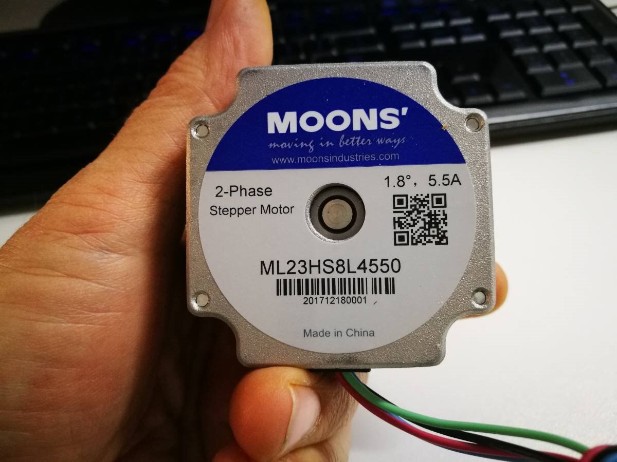

The first decision I took was using a robust stepper motor to grant the right stability an precise positioning along the curved path. The point is that the path is very uncommon respect what we are used to managing motion controlled by stepper motors; instead of managing distances, like what it is done by a 3D printer, in our case we should manage time: we need to complete the rotation semi-circular path during a predefined time. Just a few seconds of variation can be accepted and rotation should be very slow.
The image above shows the stepper motor I have used for this project. It is a 1.8 DEG per step, that means 200 steps every rotation. The average path the tool should rotate is around 90 DEG. Consider the following:
  • Angular rotation (easier to calculate than linear motion)
  • 90 DEG angle is our path
  • Time to travel: l minute (from 0 to 90 DEG)
Based on the above parameters, we deduce that
90 DEG = 1/4 of a full rotation
Resulting (theoretical) Motor speed = 0,25 RPM
At the speed of 1 RPM motor will run too fast!
A couple of gears reduction (in our case I have used a 42:75 steel gears) only solve partially the problem. Applying the reduction gear what we get is a 90 DEG rotation in about 200 steps. This is a too low limit and very difficult to control along the time. The scheme below shows the axis motion along distance respect the time needed.
To dramatically improve the steps performances without introducing a too complex gear mechanics, the solution has been completed with a motor driver supporting micro stepping.
Due to the industrial application of the target I have used a Moon's SR stepper controller. As a matter of fact, the same theory and development can be applied using cheaper components (stepper and motor controller) without any change to the design architecture.

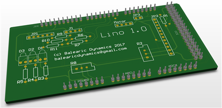

The circuit itself is not particularly complex but should work in not properly clean environments. For better stability, I have designed it as a Mega shield. The image below shows the schematics and the rendered PCB
The project has been developed with Altium CS
