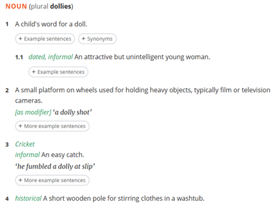

When you read the title it's rather easy to make the wrong assumption about the term "Dolly".
However the Oxford Dictionary clearly defines it as
https://en.oxforddictionaries.com/definition/dolly
And just to be clear this is related to the small platform ....

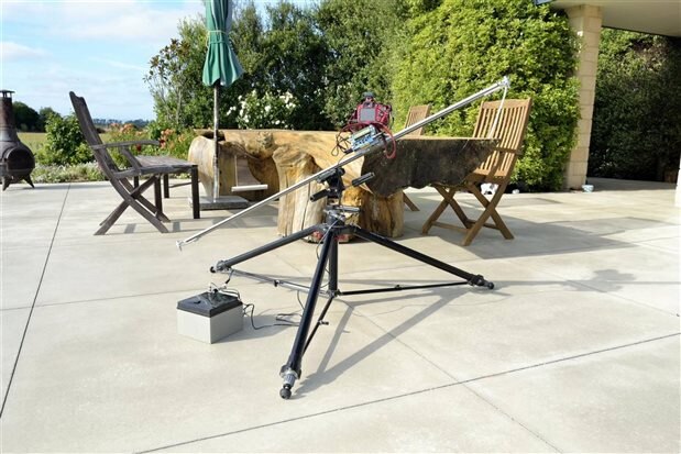

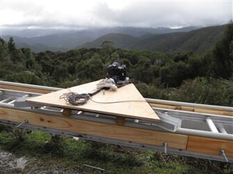

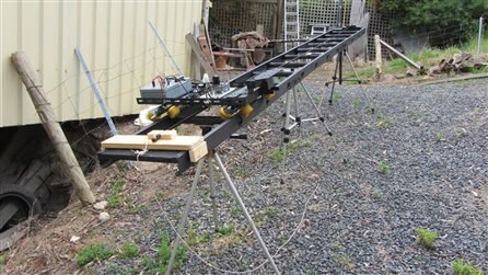

This one is a three part device and they write about it here.
https://hurleydolly.wordpress.com/
It's based on an aluminium extension ladder.
Not sure where this one came from
I saw lots of versions and most needed tweaking once you got there.

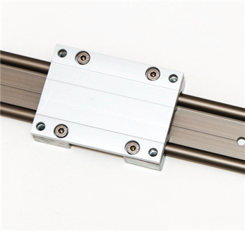

I kept coming back to the IGUS extrusion and the advantage of this system is that it was locked onto the rail, came with the carriage that ran on the rail which had plastic replaceable drylin glides.
As luck would have it a NZ company was a distributor and I ended up paying NZ$250 +GST and freight for a 1.5m (59 inches) length.
They even drilled and taped the tripod mount holes as part of the price. image

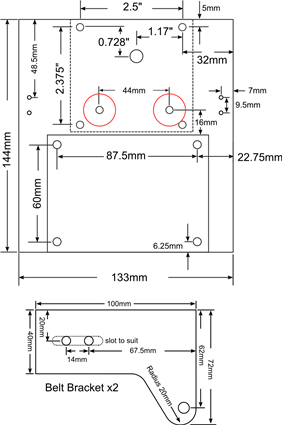

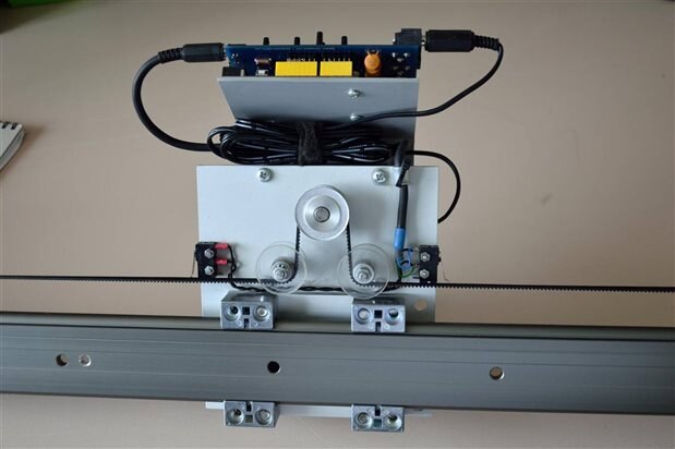

Once the motor/gearbox was sorted, the next task was the drive system.
CNC router, and 3D printers have made it much easier to find affordable T5 drive belts, and so a length and pulley was ordered.
The plate dimensions are here (if anyone is interested)

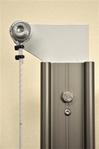

The idlers are common bearings (624zz), but I added a plastic washer to ensure the belt couldn't slip off.
As you can see there is 180 degree contact around the drive wheel, which ensures multiple teeth share the load.
This is using a different drive wheel and belt than some of the other images .We finally sourced something that would fit the gearbox shaft size without having to drill it out.
The pictures above show the belt fixing and the controls.

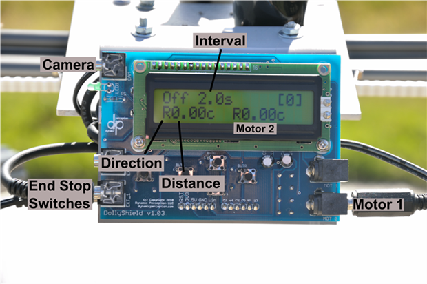

SOFTWARE
When I first started on this I thought the software would be a breeze.
Move the motor, take the picture, move again, etc.
Little did I know how many settings that Dynamic Perception included in their product.
There is a means of calibrating the distance, which changes with the motor rpm and the size of the drive pulley.
You can even calibrate the speed horizontally, at 45 deg and 90 deg angle
You can control the ramp up and ramp down speed to help stabilise the rig when you're moving a large camera.
The manual gives all the options and I'd never of thought of half of them.
The code is attached as it's too much to post as I've done for other posts.
All I can say is thank you to Dynamic Perception and their belief in Open Source .image

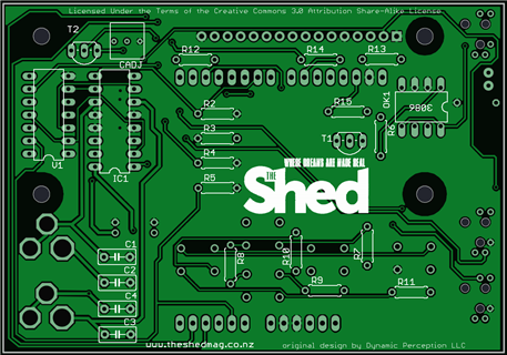

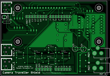

SHIELD
So the issue with a lack of support was cured by making some boards.
I used Hackvana and added TheShed logo to differentiate and ensure that support questions didn't go back to Dynamic.
