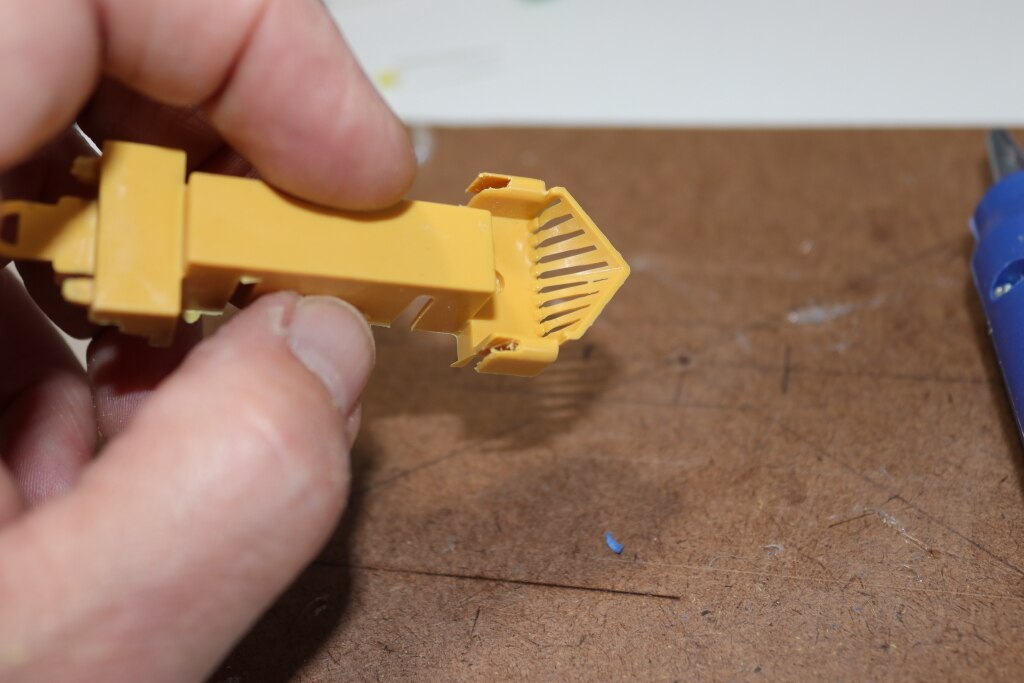

The components selection has not followed a precise logic; at least not a human logic. The first idea born seeing a spring-loaded micro train I bought from the near Chinese bazaar for 2 Euros. I thought it was great to try to improve this small game with some electronic. Then during the next two weeks, I went to the Chinese bazaar very frequently, almost every day image
Handling this simple toy, things seemed possible so I started developing a motor control for the Train. The steps of the assimilation of the train by a different technology are shown in the gallery below.
{gallery}
Spring elimination from the train mechanism
Reassembling the hacked mechanism
Now it can rotate freely
Geared DC micro-motor hot glued inside the train cabin
The micro-motor shaft exposed
Added the front-light
Cut the train chassis to host the rail contacts
The new train engine
To make the sliding contacts of the train I have used two pieces of desoldering wick. Micro-motor rotates at a max of 50 RPM; in the first version I made the transmission to the wheels engine with a 1:1 3D printed gears but the speed was too high for the engine so I designed a second group of gears with the 3:1 ratio. The below image shows the rendering of the first version (left) and the adopted version (right)
