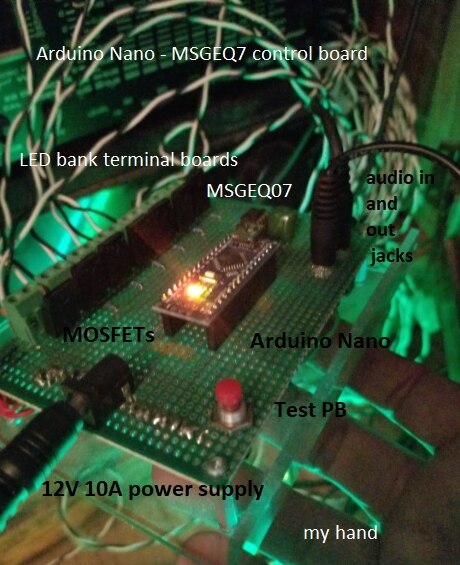

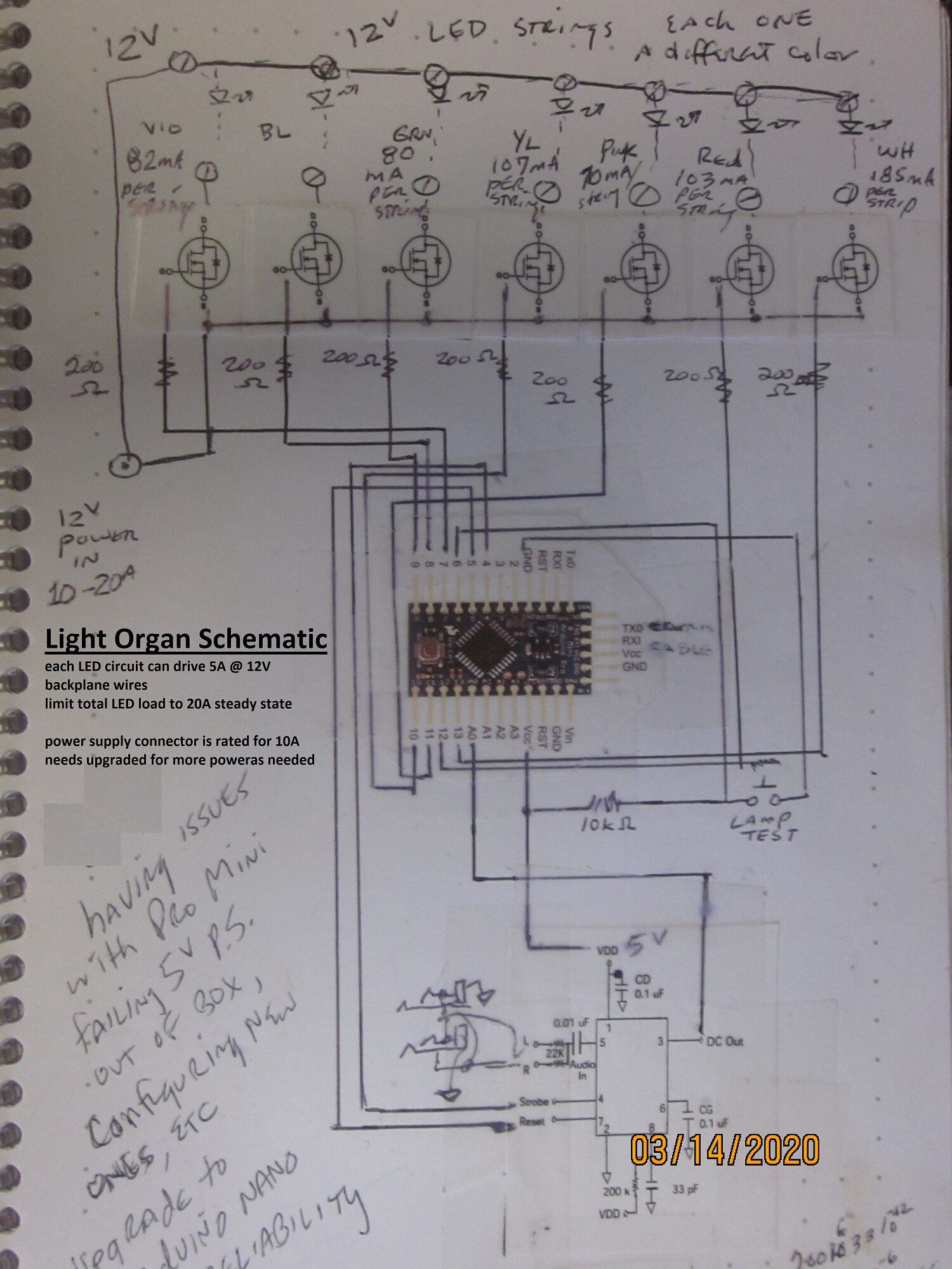

The MSGEQ7 graphic equalizer IC inputs mono audio signal ( a stereo input jack is used and sums the left and right side together) , sorts out the audio into 7 different frequency bands, and provides an analog output of the the amplitude of the selected frequency band.
This output band desired is selected by the Arduino, and the MSGEQ7 analog output read by the Arduino.
The Arduino compares the analog input level to a threshold setting, if the amplitude exceeds the threshold, the output turns on the MOSFET, driving the LED bank. The 7 band scan scan is so fast, the process appears continuous.
The Arduino can sweep thru the 7 channels so fast, there are some delays intentionally set for the MSGEQ chip read/write timing.
The number of LED banks that can be used (power limit) is dependent on the 12V power supply, MOSFET current, and wire size of the power circuit.
This can get really big as is , and even bigger with little change and no sweat.
Note the pushbutton for test mode, that can be activated at any time. It is very helpful in troubleshooting, or just putting on a short light show itself.

  Arduino D7 = 63Hz LED , LOW = ON
  Arduino D8 = 160Hz LED
  Arduino D9 = 400Hz LED
  Arduino D10 = 1kHz LED
  Arduino D11 = 2.5 kHz LED
  Arduino D12 = 6kHz LED
  Arduino D13 = 16kHz LED
  Arduino A0 wires to MSGEQ7 pin 3 Vout
