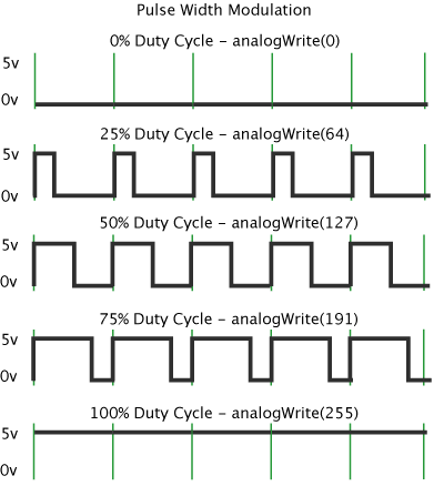

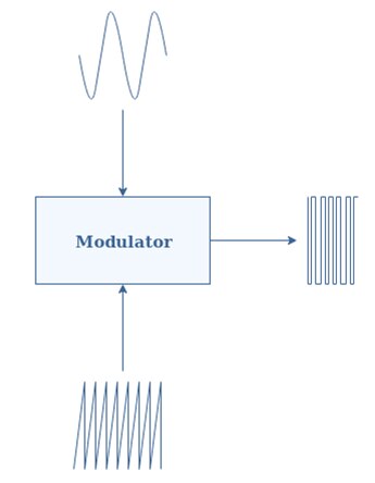

Pulse Width Modulation
Pulse Width Modulation (PWM) is one of the most used modulations.
It is in fact used not only in telecommunications but also in applications where there is the need to vary the brightness of a lamp or to adjust the speed of an electric motor in direct current.
It is in fact used not only in Telecommunications but also in other applications for example when there is the need to vary the brightness of a lamp or to adjust the speed of electric DC motors.
The PWM modulator is a circuit that receives two signals at its input, the modulating signal, that is, the one that regulates the width of the square wave (the duty cycle) at the output and a triangular wave signal with a fixed frequency. At the output we will find a square wave signal that has the triangular signal frequency and a variable duty cycle that depends on the amplitude of the modulating signal.
                                       (From Arduino Site)imageimage

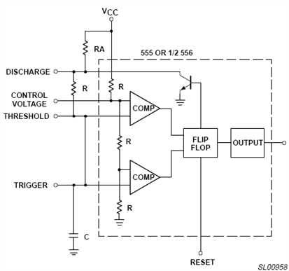

Many years ago this topic was treated at school using the "mythical" NE555, an integrated circuit that used with three or four other passive electronic components could be used as a monostable, astable or bistable multivibrator, as a PWM and PPM modulator, as a comparator, etc.
Since Arduino entered our schools, making a simple fader for a LED or a speed control for a small fan has become even simpler.
In these simple cases, the standard PWM frequency of the most popular Arduino boards is 490 Hz, a perfect frequency for our purposes so it will not be necessary to access the registers to set higher frequencies.
Even Arduino Nano has several PWM output terminals, in particular, the pins that can be used are 3, 5, 6, 9, 10 and 11.
The default frequency of the PWM signal is by default 490 Hz but it can be varied using a little more code complex but in any case, you cannot exceed a few tens of kHz.
To get a PWM signal on Arduino just use the analogWrite () function. Its syntax is very simple:
     analogWrite(pin, value)
Parameters:
  • pin: the Arduino pin to write to. Allowed data types: int.
  • value: the duty cycle: between 0 (always off) and 255 (always on). Allowed data types: int.image

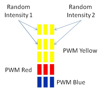

We will use this function to try to recreate the colors of the candle flame.

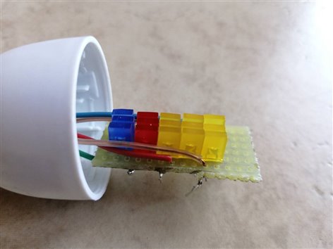

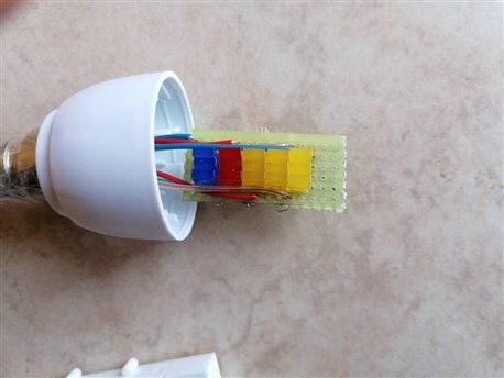

We will use a matrix of 15 LEDs organized as shown. The candle flame will be represented by 5 lines of three LEDs.
Starting from the bottom there will be a blue line, a red line and three yellow lines. In practice, we will use PWM to manage the three colors so that the light produced resembles that produced by a candle.
The two central LEDs of the fourth and fifth row will be controlled together with those of the third row while the two pairs of yellow LEDs on the right and left are piloted by two other doors in order to light up with a random intensity at each cycle.
Their flashing will simulate the random movement of the flame and its variation in intensity.

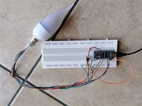

The Circuit
Per quanto riguarda il circuito non c’è molto da dire, lo schema è piuttosto banale e basta leggere il codice per connettere i Led ed il gioco è fatto.
The code is very simple, I added lines of code that could be avoided in order to make it more understandable.

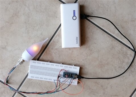

The effect obtained is quite pleasant, even considering the fact that everything was made in a very short time and with materials that I was at home.

    Yes jw0752 , let's say that if you see the "candle" lit at a certain distance it is quite likely. Making the changes proposed by genebren  the result will be even better. Even now the slight bluish tinge at the bottom and the flashing of the upper part managed by the random function are very faithful to the originals. As soon as I make the changes in the colors of the LEDs, I will do the test you proposed to me, I think that talking about AI at school is necessary and teachers need to take advantage of every little opportunity to do it.

    True genebrenusing different colored LEDs, the result could have been better. If I replaced the red LEDs with the orange ones and the yellow ones with the warm white ones, I believe that the result would be even more similar to that of the photo.
    Bringing such a simple project to school, I believe, can be useful as it allows you to become familiar with an important concept such as PWM to create simulations of simple analog physical phenomena.
