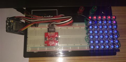

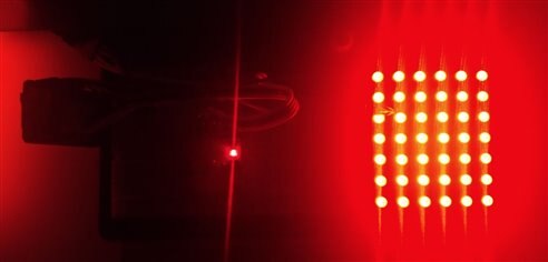

Hence, in this blog I have tried to demonstrate Color Classification and Recognition on ESP32Cam; a 32-bit popular WiFi-BT MCU with integrated camera and costing <= 5 USD.

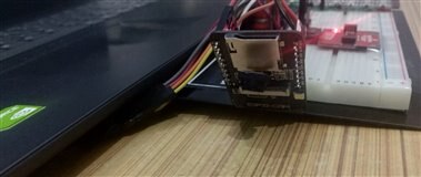

An ESP32Cam is a 32-bit MCU developed by Espressif Systems and Ai-Thinker, with an in-built 5KB SRAM, can be clocked upto 160MHz and comes pre-equipped with OV2640 camera with image output formats of JPEG, BMP, GRAYSCALE. A color-model based on individual pixel identification, is used to train the hardware. There are methods where a still image is shot and stored as RGB pixel array value and post-processing is performed for further classification. Yet I have tried to use continuous frame capture from camera stream by storing individual bits while performing color format conversion per frame and further down-sampling and extracting image feature vector. Though this approach suffers from noise due to ambient light-conditions. Since, there are numerous parameters that influence the accuracy of color-model, like stray movement of camera, false-labeling of ROI, direct light exposure on sensor and unavailability of color filter on sensor module. Still, the concept works and can be improved with detailed training-dataset.

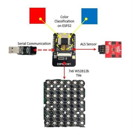

Hence, on classification between Red or Blue, the ESP32Cam programs the pixel value obtained from approximate feature-vector into WS2812b tile, that changes the color of LEDs accordingly. In addition, an ALS(VCNL4040) has been used all-together with ESP32 that aids in getting ambient brightness of ROI, and performs 'adaptive-brightness' on 7x6 WS2812b tile.

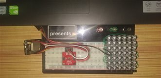

Stuff you'll need..
- ESP32Cam from AiThinker (works with other variants too)
- CP2102 Converter for programming the ESP32Cam (FTDI/Prolific..whatever)
- Sparkfun VCNL4040 ALS
- WS2812b LEDs
- An Element14 Breadboard(must have) & some jumper wires.
Connection flow diagram:

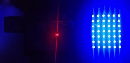

Conclusion: For a limited dataset, the classification between Red and Blue achieved a score of 93%, and the accuracy increases during the dim light conditions/ pitch dark. While, the present model lacks classification of green color, in short there is still a plenty of room for exploring computer-vision on low-cost microcontrollers and initiatives like TinyML further pave path for further development. In coming days, I would like to integrate dynamic data with WS2812b for some serious LiFi Communication.

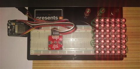

    Thanks Dubbie, as this project is based on ESP32Cam that is trained to recognise color values(R and B ) and ambient light levels through sensor, thus overwriting the neopixels with approx. pixel value of the detected color. It is yet another fancy color picker based on computer-vision.
