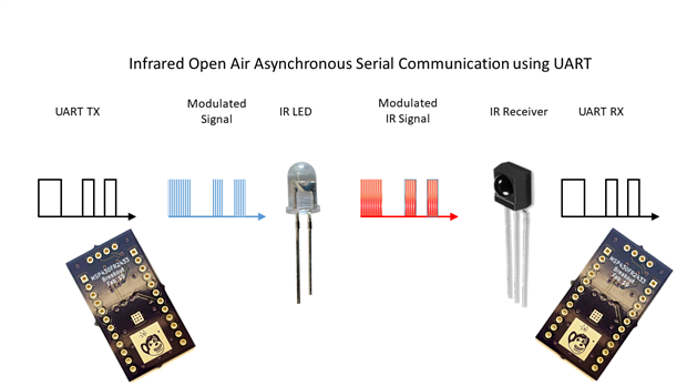

Photonics:  Wireless Communication with Infrared
fmilburn
fmilburn
22 Feb 2020
This blog describes how infrared receivers such as the Vishay TSOP38238TSOP38238 work and rather than using a library or built-in hardware it describes an oddball way of wireless communication of my own design. A microcontroller will be used to turn UART transmissions into a modulated signal which can then be read into UART on the receiving microcontroller using the TSOP38328.  While located with the Photonics Project14 Photonics entries, it is not an official entry and it is not my intention to have it eligible for a prize.

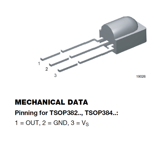

TSOP 38238 IR Receiver

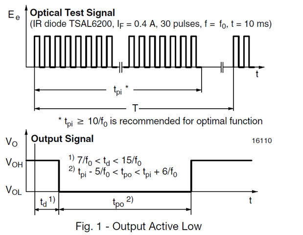

The diagram below is from the Vishay datasheet for the TSOP382.., TSOP384.. dated 11 Nov 15 and subject to their disclaimers.
The TSOP38238TSOP38238 is a 38 kHz version of the series of IR receivers for infrared remote control.  It has a receiving diode with highest sensitivity at a wavelength of 940 nm and circuitry that provides demodulation of a narrow 38 kHz receiving frequency and a preamplifier.  The receiver can be connected directly to a microcontroller for decoding.  In order to understand how the sending unit is programmed and built it is necessary to understand the receiver in greater detail.
The current and voltage supply requirement is less than a milliamp and will work down to 2.5V.  Great!  This makes it a good choice for the coin cells used in the tiaras.  The transmission distance is up to 45 meters typical with good directivity and by using more powerful transmitters can be even further.  If indoors with reflective surfaces it does not even have to be line of sight from the transmitter.  Note however from the spectral sensitivity shown below that it can't be just any IR LED.  It needs to be 940 nm.  There are other versions with less sensitivity to fluorescent lighting.

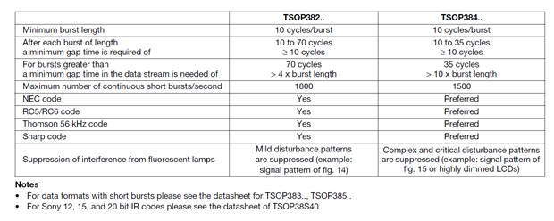

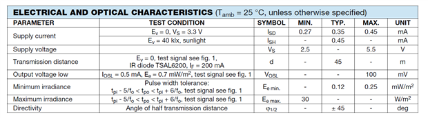

As noted above, the incoming signal needs to be modulated at 38 kHz for this particular receiver.  This is done to filter out other ambient IR sources.  The output is active low as shown below.
And the incoming signal must meet certain requirements.
The table states that the minimum burst length is 10 cycles at 38 kHz (38 kHz period is 26.3 micro seconds).  Doing the math it can be seen if common serial frequencies are used then 2400 Baud is the maximum (38000 / 2400 = 15.8 cycles which is greater than the minimum of 10).  So rounding off, we will use 16 cycles per burst with each cycle being 26.3 micro seconds long.  If there is a start bit, 8 data bits, and a stop bit then a full character will take 1 / 2400 * 10 = 4.2 milliseconds and the total number of cycles is 10 x 16 = 160.  Looking at the table above the minimum gap time between character bursts must be 4x the burst or 4 x 4.2 = 16.8 milliseconds.  For safety, use 20 milliseconds between bursts.  Phew... Pretty sure all that is correct.  Now we are ready to design the transmitter.

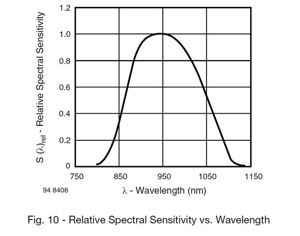

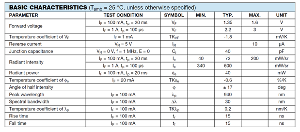

TSAL6200TSAL6200 IR LED
For this design the Vishay TSAL6200TSAL6200, a 5 mm through hole LED is used.  This is the same one used in the datasheet for the receiver.  The basic characteristics taken from the datasheet dated 13 Mar 2014 are as follows:
Note that the peak wavelength is as desired and the spectral bandwidth is quite narrow as desired.  The relative radiant intensity is fairly narrow which could be an issue but in my design I drove a number of LEDs with a MOSFET so there was increased power and no problems were encountered.

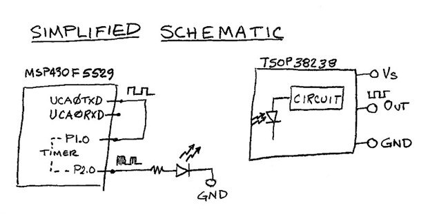

Microcontroller
The schematic is shown below for this demonstration:

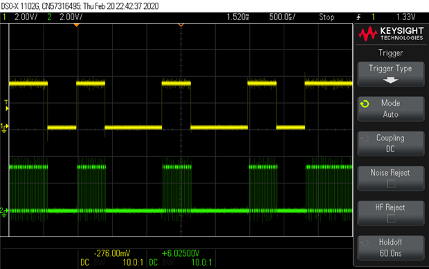

The serial output from the microcontroller is routed to input P1.0 which triggers an interrupt whenever the input signal transitions from high to low or low to high.  If it triggers high, than a PWM timer operating at 38 kHz outputs on pin P2.0 to the IR LED.  If it triggers low, then the PWM timer on pin P2.0 is stopped.  This modulated signal is then picked up on the TSOP 38238 which can be decoded by a microcontroller or in this case displayed on an oscilloscope.

That took more coding effort than I thought it would.  The output signal from the TSOP38238TSOP38238 is inverted but that is easily fixed in the GPIO interrupt of the transmitting F5529.  It is pointed out again that this is not the most straight forward way to do IR communication and it evolved from a project with unusual design objectives.  It isn't recommended for your project but does show how a number of modules in the F5529 can be programmed with DriverLib including the following:

Here is an oscilloscope screenshot that better shows the modulation and decoding.
