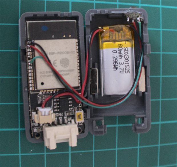

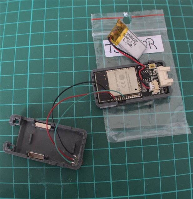

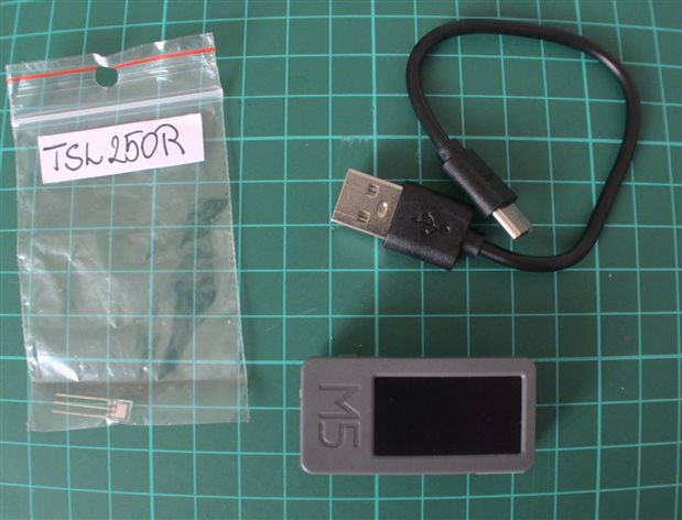

The basic idea was to create a simple device which allow to compare the quality of light sources e.g. LED bulbs. I have used TSL250R IC containing photodiode and operational amplifier with configured feedback loop. This IC is optical sensor which output voltage is proportional to light intensitivity. I have put this sensor inside to M5Stick case and connected directly to ESP32 module. Output from sensor is connected to GPIO with number 35. Below there are images with mounted sensor:

    Thanks kk99. Finally got a sensor! Now I just need to figure out how to get the board out of the case.
  • kk99
    kk99 over 6 years ago in reply to peterw1956
    You could use TSL257 or any similar light to voltage converter.

    II am in Australia and finding it difficult to source the TSL250R ic. Is there an alternative that would be suitable please?
  • kk99
