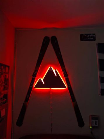

1. Introduction
     Hi, this will be my entry for the Photonics Project14 competition. For this project, I decided to upgrade an old project that I've done about 8 months ago, but haven't posted anything about here. I bought a standard RGB LED strip set, which came with 5m of RGB LED strip, a small IR remote control and a 12V power supply. One of my favorite sports is skiing and for a long time, I wanted to mount my skis on the wall, but it would be boring to do it in an ordinary way. So I cut out a mountain of a piece of wood, put the LED strip behind it and hanged it up like that, I loved how it looked and it worked okay, but with limited number of colors, and of course, only controllable using the small remote that came with it. So I decided by using an ESP8266-07 with some additional hardware, to make it better, to keep all of the functionality it has now, but add the option of controlling it by a phone app. Here is how the original lamp looked:
2. Plan

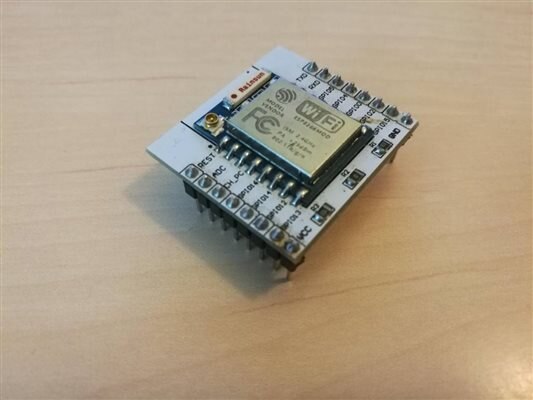

To start off, I needed to get familiar with the ESP8266 again, since I haven't used it in quite some time, I was using a standalone ESP8266-07 with an Adafruit Feather Huzzah for some troubleshooting because of the serial monitor. To program the ESP8266-07 I used a small USB to serial converter, but an Arduino Uno with the removed chip can be used also, here is how I connected the ESP8266-07 to program it:
Be careful if you are using this module, or other similar ESP8266 modules, they work on 3.3V and can get fried easily if you connect them to 5V
  • 3.3V --- VCC
  • GND --- GND
  • Tx on the board --- Rx on the converter
  • Rx on the board --- Tx on the converter
  • CH_PD (CH_PC) --- VCC (3.3V)
  • GPIO0 --- GND
  • GPIO15 --- GND
To control the LED strip I'm going to use 3 of the PWM pins on the ESP (12,15,4) that will be connected to more electronics to be able to handle the current of the LED-s, I wanted to stick to the single power supply, so I needed a way to lower down the voltage from 12V to 3.3V and the last thing that I needed to figure out is how to do the control over internet. Instead of making my own small app in Android Studio or MIT App Inventor 2 as I usually do for projects like this, I decided to go with something I've heard of before, but never used before, Blynk. It turned out to be perfect for what I needed it and very easy to use, as I'll show later in the blog. With all of the things figured out here are the parts and tools I used and then the prototyping phase.

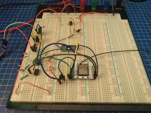

4. Prototyping
IR remote

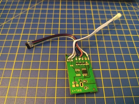

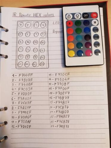

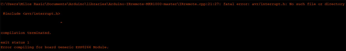

     I began the prototyping phase with enabling the thing that the RGB strip came with, IR remote. Using the IR sensor (https://www.adafruit.com/product/157 ) I connected it to an Arduino Nano using the recommended scheme from the product site, and run the example from the IRremote library called IRrecvDumpV2 which printed out to the serial all of the needed information when one of the buttons is pressed, the thing we are interested is the HEX code value, which we can later use in our code to distinguish between different buttons, it's a bit of a tedious job, but I covered all of the buttons from the remote:
One thing to watch out for is that the ESP8266 doesn't support the standard IRremote library, if you try using it, you will be greeted with a message like this:
To go around this error, we have to use the ESP8266 specific library which can be found here: https://github.com/crankyoldgit/IRremoteESP8266
The library is pretty much identical to how it's used compared to the standard one, which is a great thing
With all of the values written down, and the library working on the ESP8266, all we needed to do is compare the value we received to the list of our values and decide what to do with that button.

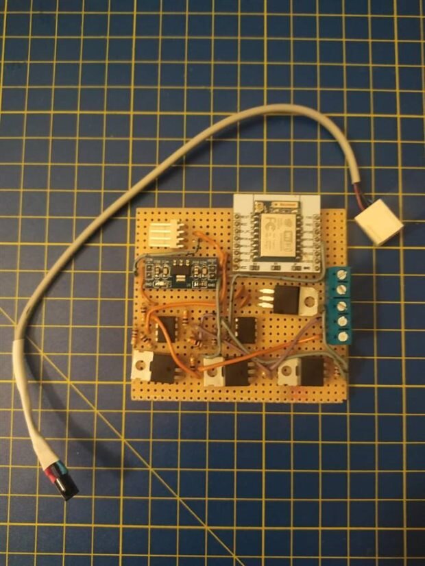

     With the IR remote out of the way I could focus on the electronics, there are 2 things I had to solve here, one is the power supply for all of the components and the other is driving the LED strips. I'll begin with the power supply problems.

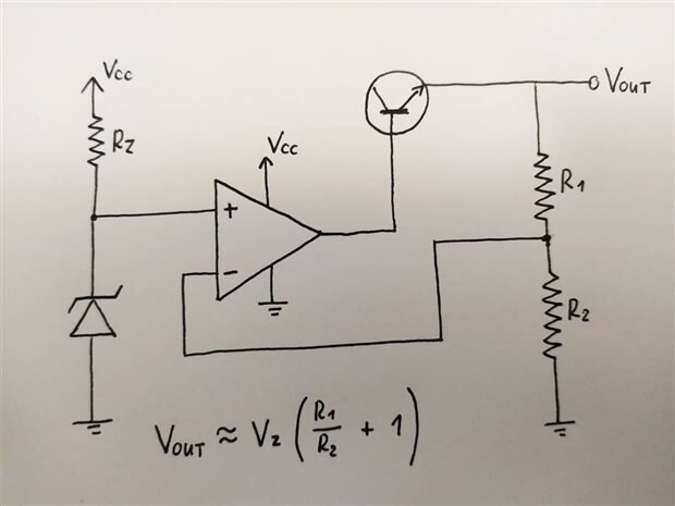

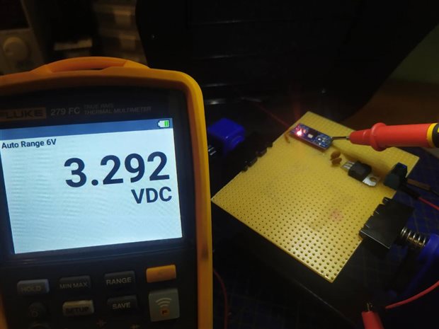

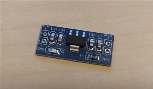

Power supply
      The power supply I'll be using is the one that came with the RGB strip, a 12V one. While it says 12V, it isn't really 12V, and is more 12.6-13V, which is fine for the LED-s but I needed to drop down that voltage to 3.3V so I can power up the ESP. To drop down the voltage, I used a small 3.3V linear regulator which I had laying around, while I was reading online about it's ratings, I think I saw somewhere that it's recommended to stay under 12V input and with my power supply being over 12V I didn't want to risk it, so I made another in between stage which would lover the voltage to 9-10V.
In the, I used an 7809 linear regulator which dropped the voltage down to 9V, but before that, I found a cool method of making a small DIY power supply using a few simple components:
This power supply really worked great, but I went with the 7809 because it's smaller overall and has less components, so there's less of a chance to make a mistake when soldering everything together.

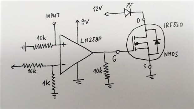

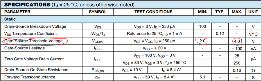

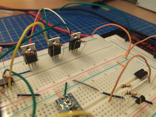

LED driver
     I stuck with the components I could find at home because of the quarantine due to the outbreak of COVID-19. For the LED drivers I wanted to use NMOS, the ones I had at home were the IRF530, but when I tried them, there was a problem:
So because of the threshold voltage going up to 4V, I couldn't rely on using the output of the ESP without anything in between, I need some kind of a shifter circuit in between, I decided to go with non-inverting comparators, since I had OpAmp-s laying around.
On the picture above is the driver for one of the channels, it was time to put everything on a protoboard and to see if it will work, and it did!
With that tested, and with all of the voltages being okay, as well as managing to run all of the LED-s without any problems, it was time to go into writing the software for this project, and after that putting everything on a perfboard, soldering it, and putting it instead of the old RGB controller.

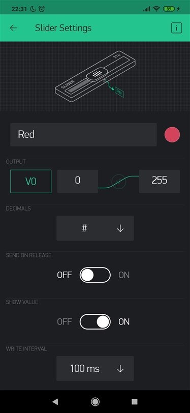

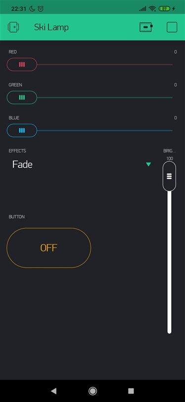

Blynk
     Blynk is a great app I've heard of before but never had a chance to use, so I thought to give it a try now. When you download the App, you choose with which device are you working, there is a big list from, Arduino to ESP and so on. After that, there are all kinds of widgets which you can place on the background and easily configure to receive values from. There is a lot of great documentation and getting started guides on Blynk's website. For my project, I needed 4 sliders, 3 of them for the R, G & B channels, and one for brightness, as well as a button for turning ON and OFF the lamp and a small drop down menu for choosing the desired effect, to which I'll get soon. You can configure all of the widgets to write to real pins, but I chose virtual, because I wanted more control over it, here is how my app looks, as well as how all of the widgets are configured:
The setup is really simple, the only notable thing really is that, instead of updating on release, I put the update on 100ms, so that the LEDs are updates as we are moving the slider, not just when we release it. On the ESP side I used just a single Blynk specific function to load the different values:
BLYNK_WRITE(V0) //Red color slider widget writes to V0
  redBlynk = param.asInt();
BLYNK_WRITE(V1) //Green color slider widget writes to V1
  greenBlynk = param.asInt();
BLYNK_WRITE(V2) //Blue color slider widget writes to V2
  blueBlynk = param.asInt();
BLYNK_WRITE(V3) //Brightness slider widget writes to V3
  brightnessBlynk = param.asInt();
  if(lastBrightnessBlynk != brightnessBlynk && breathingEffect == false){
      lastBrightnessBlynk = brightnessBlynk;
      multiplier = 0.1 + 0.039*brightnessBlynk;
      displayColor(lastColor);
BLYNK_WRITE(V4) //Button ON/OFF Widget is writing to pin V4
  int buttonBlynk = param.asInt();
  if(buttonBlynk == 1){
      if(lampTurnedOn == false){
          resetEffects();
          solidEffect = true;
          lampTurnedOn = true;
          displayColor(1000000000 + 1000000*redBlynk + 1000*greenBlynk + blueBlynk);
        else{
            resetEffects();
            solidEffect = true;
            displayColor(lampOff);
            lampTurnedOn = false;
BLYNK_WRITE(V5) //Menu for choosing the effect is writing to V5
  int effectBlynk = param.asInt();
  if(effectBlynk != lastEffectBlynk){
        lastEffectBlynk = effectBlynk;
        resetEffects();
        if(effectBlynk == 1) solidEffect = true;
        if(effectBlynk == 2) breathingEffect = true;
        if(effectBlynk == 3) changeColorEffect = true;
        if(effectBlynk == 4) fadeEffect = true;
Besides this function, I just copied the rest from Examples->Blynk-Boards)WiFi->ESP8266_Standalone

 *  For controlling the RGB strip, 3 NMOS are used as well as 3 OpAmp-s

void displayColor(int val){
    int b = multiplier*(val % 1000);
    int g = multiplier*((val/1000)%1000);
    int r = multiplier*((val/1000000)%1000);
    analogWrite(12, r); // Pin 12 is used for the Red Channel
    analogWrite(15, g); // Pin 15 is used for the Green Channel
    analogWrite(4, b);  // Pin 4 is used for the Blue Channel
    return;
 * BLYNK
 * These Functions handle all of the values we are getting from out Blynk App that we made
 * BLYNK_WRITE functions handle the data coming from the Blynk app
 * HandleBlynk function handles converting the values from the Blynk app into our color code
          resetEffects();
          solidEffect = true;
        else{
            resetEffects();
            solidEffect = true;
        resetEffects();

 * IR Remote Handler Function
 * This function handles all of the button presses on the small IR remote I got from my original RGB controller
 * In order to change colors we need to be in solid effect mode with the lamp turned on
 * Lamp Off, turns off the lamp, and sets the effect to solid
 * The brightness buttons work by consinstently pressing them or just by pressing and holding the button
 * For the color buttons we use the predefines colors I mentioned at the very beginning
void checkButton(int val){
    if(lampTurnedOn == false && val == 0xF7C03F){

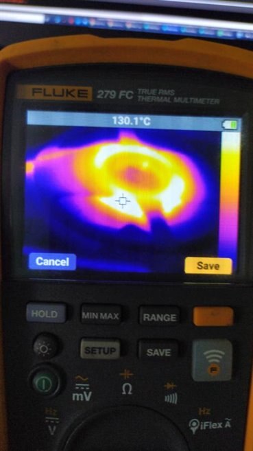

Just to give a small warning because of a potentially really dangerous thing that I've done by mistake, if you're testing out the LED-s for anything more than few seconds at a time, be sure to not keep them on the spool, they get extremely hot extremely fast, here is the situation in which I was:
It's much better to cut off a small piece or just unravel the whole thing, if you want to test out how much current will be drawn.

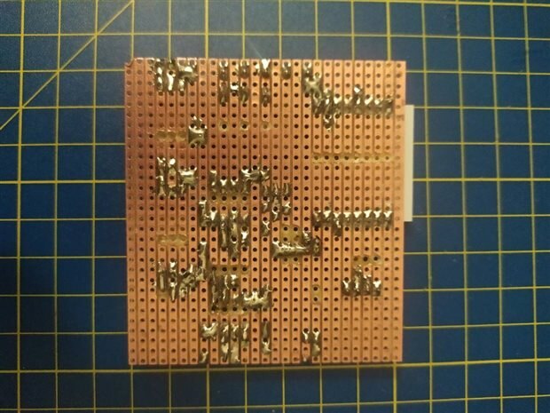

With everything working great, all I have to do is solder this to a piece of perfboard and put instead of the old RGB controller.
Just one short note, some of the colors may look weird, or too strong because I can't setup my phone to film the correctly, and some colors won't be seen in the video as they are in real life, for example, mint color looks like blue on both pictures and videos, just wanted to point that out because of some weird frames which are in some of these videos.
7. Soldering
     I needed a couple of hours to finish this up, I started up with the power supply part and confirming all of the voltages are okay, and from there added the ESP, the OpAmps the MOSFET-s and the connectors.
With soldering out of the way, all that's left now is to mount this controller instead of the old one, and mount the skis again, and we are done!

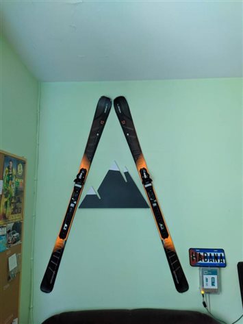

8. Putting Everything Together

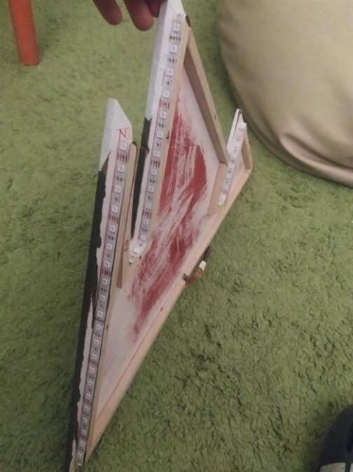

     I took the mountain off the wall and took out the old controller, here is how it looked like, a small IC with 3 small transistors:
As for the mountain itself, here is how it looks like:
To make this mountain, I took some flat piece of wood I found laying around, drew a modern style mountain and cut it using a table saw, measuring about 1cm from the edge I glued in small 1cm by 1cm sticks on the back side. I spray painted the front side, and for the snowy peaks I just glued in some white paper. With the sticks glued in the back, I had an edge to which I can stick my LED strip while leaving a small slot in the bottom for the cables to go through, I used some double sided sticky tape to attach the controller to the back of the board and some duct tape for securing the cables.
I put on some connectors on the power supply cable, as well as to the positive and negative terminal on the controller, connected them, put the mountain on the wall, put the skis back on the wall, and I'm done! Here are some pictures and videos of the finished project!
