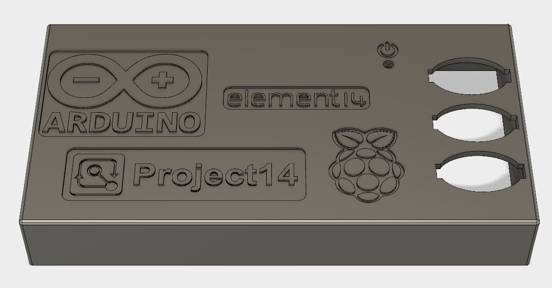

It's been a little while since an update - and this is really rather minor, it revolves almost exclusively around the PSU case design.
The initial sketch up in Fusion360 looked grand but printed less than great. Having decided (unnecessarily) to adorn the upper surface with logos I set about translating images to a printable 3D model.
These were then blended into the lid design and sat proud - the pictures looked great so I printed one - full case, upper and lower.
The case halves fitted like a treat, the stepped lip I designed in clipped into place so no additional hardware was required to bolt stuff together, but - as my previous update showed - having the logos flat against the glass bed and the rest of the large surface area printed over supports, the overall effect was . . . . . . . . well, crap!
Added to that, some logos were barely recognisable.
Back to 360 - a lot!

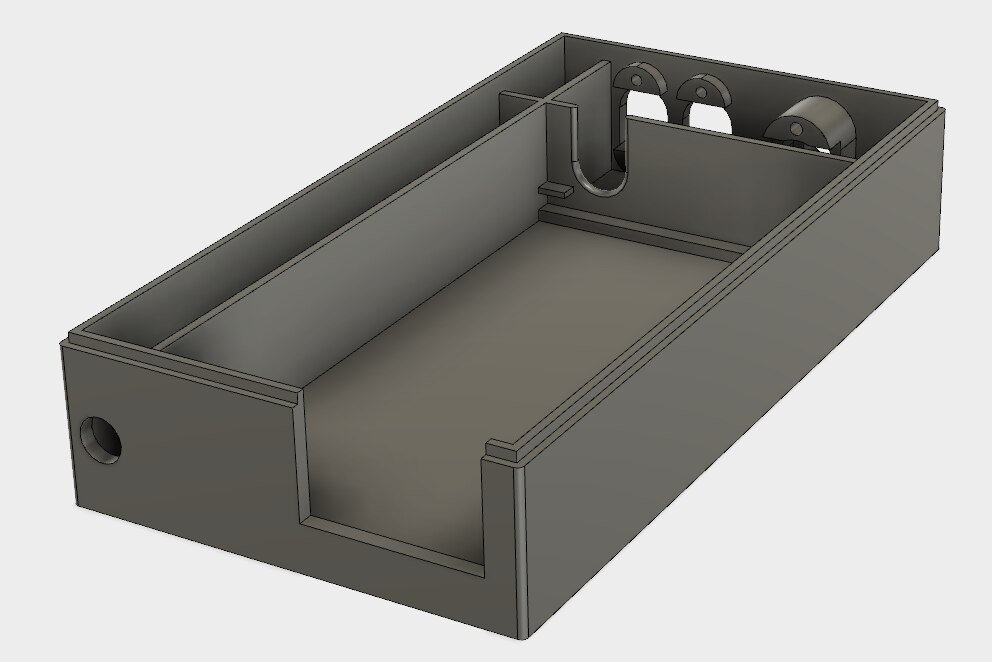

Whilst there, I opted to redesign the whole case, the bottom now guides the mains input down a side channel moulded into the case. Why? dunno, I just wanted to!
3 switches were used instead of the original 2, (I found the missing one that I didn't even realise was missing).
After 2 more lid design rehashes and partial prints (Simplify 3D allows me to set how much of a design I actually want to print - basically, the first 1.6mm (8 layers) was sufficient to see if the design worked, logos printed ok and switches fitted.
2 skinny prints later we were cooking on gas so the new lid was printed - right up until the point I noticed the nozzle was doing a lot of nothing!

Base smashed out with virtually no issues - OK, I forgot to move the feet rubber holes when I stretched the case widthways - done now, also I accidentally bought 2 x normal length 2.1mm x 5.5mm DC plugs and 1 x long 2.1mm x 5.5mm DC plug.
It sticks out a lot more and looked daft - so I redesigned the under socket mount to set it back into the case - problem solved - except It now won't let me fit the DC socket in . . . . . . . image
There's been a bit more rework of the design, but I shan't bore you with the fine(er) details.

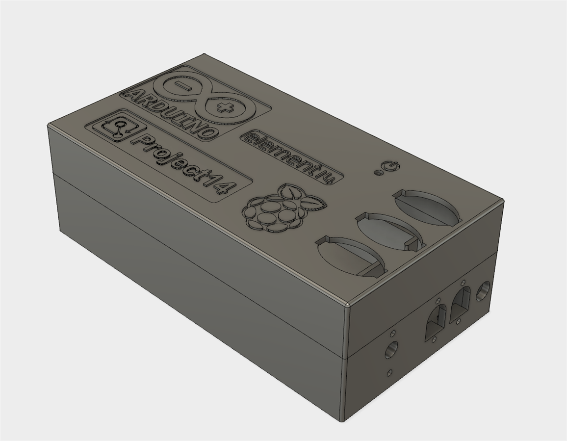

There's a standard 5mm green LED that lets you know if the PSU is powered up, now the original case has a dinky light guide leading to the top cover and all was well, I've raised the top height by some margin to allow the switches to be mounted / connected - that stuff just ain't gonna fly now.
The way I saw it was:
          1. Chop out the LED, pop a 5mm hole in the top case and mount the LED higher . . . . . . or
          2. Design a printed sleeve to drop over the current LED - stuff a bundle of plastic 'optical fibres' into the to of the LED sleeve, design & print a guide to attach to the lid for the fibres to poke thru, clad the connecting fibres / bond the 3 parts together with heat shrink and
              finally, glue the top part to the inside of the lid & melt the protruding fibres into a clear blob on top . . . . .
Wanna guess which option I went for? image image image

    The whole 'fibre optic light guide' was properly crappy!!
    A big bundle of those plastic optical fibres miget look bright, but 6 of them thru a 2mm hole? Not so much!
    Solution? Dig thru that bag of random LEDs I got in my £35 components bundle from eBay (a proper bargain IMHO) - dig out one with a Vf the same as the drive voltage being supplied to the fitted LED (eBay component tester gives Vf rather handily), change the 2mm round hole in the lid to a rectangular slot (for the red rectangular LED), glue the LED in place, solder a pair of fly leads to the PSU and plug the LED into the fitted 2 pin plug!
    Sorted.
    PSU base now reprinted with PCB retainer at one end, remodelled DC jack outlets (I got another, shorter DC plug), test fit the two halves - 'click'  -  yup, they lock together perfectly.
    Time to wire up the PSU to the switches & 3 outlets tomorrow!
