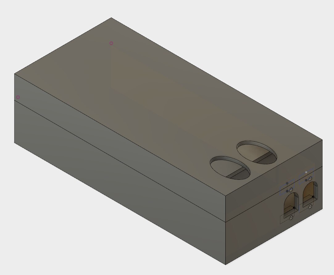

It's been around a week since the competition closed and I've made gradual progress in a couple of areas. Most of my time has been spent in front of Fusion 360 redesigning a PSU case.
Once that is complete I'll print it (and post the results here).

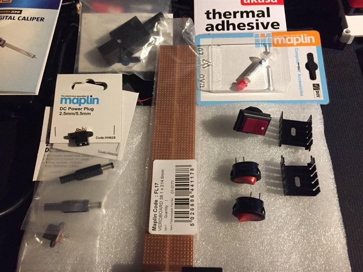

Things I didn't have lying around have been purchased from Maplin or eBay (eBay is cheap anyway, Maplin seems to be getting better at the moment - no idea why . . . . . . . . . .)!
Heatshrink - check, now I can sort those shonkily taped up mains power leads image
DC Panel Sockets & Plugs - yup, now the 12V supplies to the screen and USB converter can be properly connected / disconnected as required image
Switches, some salvaged and some bought - sorted! The screen can be powered without the Pi if required. And the 240V a.c. can be isolated image
Heatsinks and thermal paste for the Linear Regulators I already have (LM317 on a heatsink should give a comfortable 2A) - Not decided if I'm going for switched preset voltages or a proper variable with a voltmeter image
A nice strip of Veroboard also fell into my basket - perfect for simple transferral of breadboard to semi-permanent protoboard image

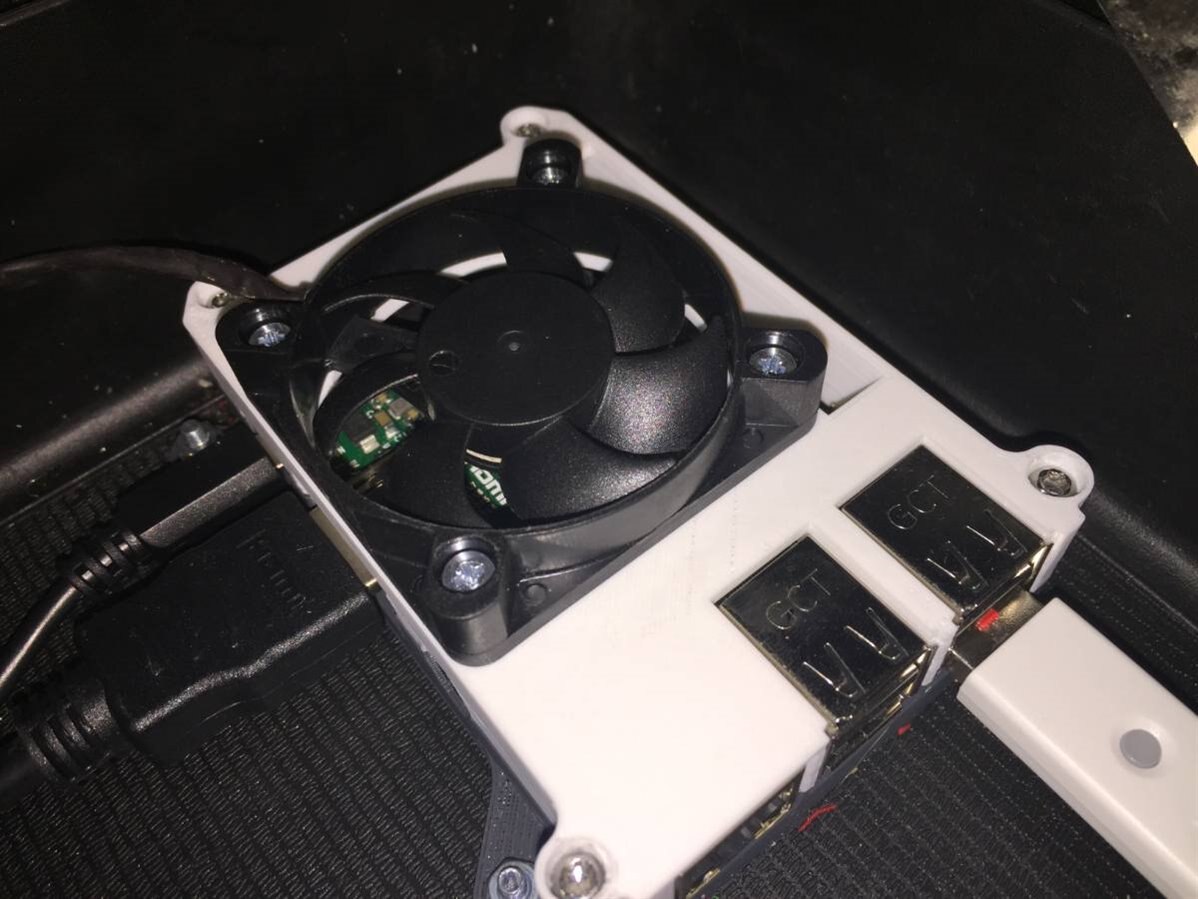

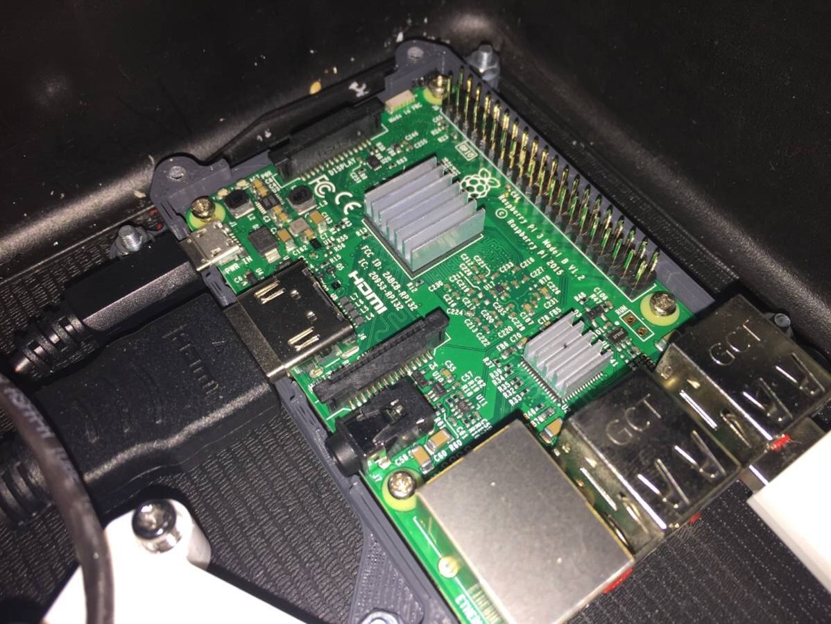

I also read at length whether heatsinks were required on the Pi3 - and I cam to the consensus that - for the sake of £1.49 delivered (UK Seler) - it wasn't worth NOT doing.
To improve things more, a 50mm fan was grabbed from Maplin (I've shopped more there in the last week than the last decade! Guilt maybe)?
I'd already considered this to be honest - the case I printed has the hole for the fan already.
Heatsinks on (didn't fit the lower - too big)

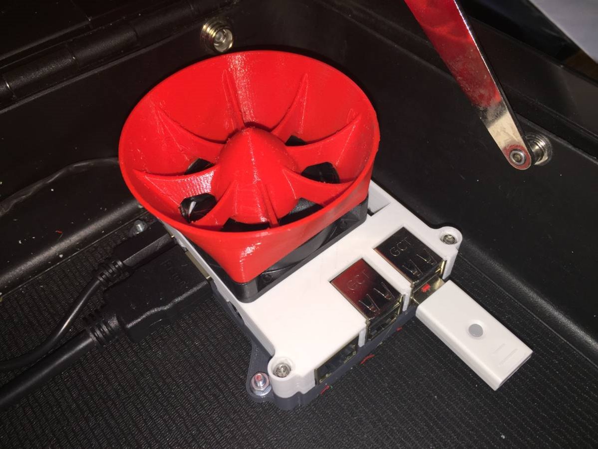

Case lid with 50mm fan attached! Looks just fine but, theres something missing.
Something ridiculous and totally unnecessary!
Ahhh, that's better! imageimageimage
The fan shroud(?!) is a remix from Thingiverse - I removed the internal mount holes and gave it studs on the rear, now It clips into the fan mount holes.
PSU Case so far (still in 3D and definitely a WIP).
