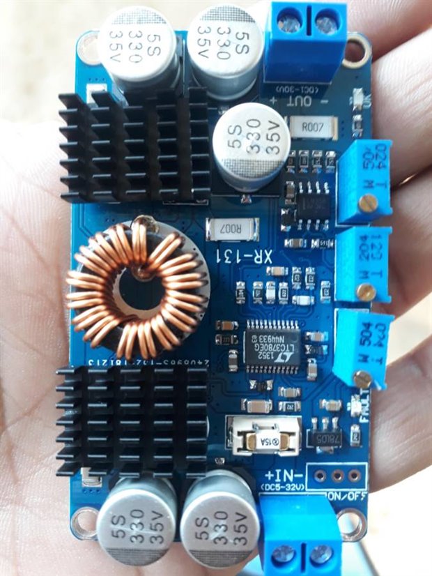

I am trying to make lab bench power supply with buck boost converter, I am using LTC3780 buck boost converter which is easily available in Chinese market. Now the buck boost converter has three variable resistors namely vout-set, cc-set, uv-set. uv-set is under voltage protection which is not necessary for my project. I need to replace vout-set and cc-set with bigger potentiometer. Vout is 500k which is available in market but cc-set is 200k which is not easily in market. So can i use any other pot instead of 200 ?image

    Hi Gurpreet, I don't know anything about this module or the chip. However, if you can find a 250k potentiometer (which should be easy) then you can just place a 820k resistor across it (it will not be…

    Hi shabaz,
    I can only get  10k, 100k, 500k. Is there a way to put a resistor in parallel with 500k and make it behave like 200k or any other way.
    0 shabaz over 6 years ago in reply to mgurpreet
    Hi,
    The further you go away from 200k, the greater the difference in effect. 250k is ok, and they are available to order from many suppliers.
    You could try a different value, see what the impact is. It may be fine.

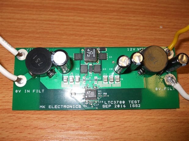

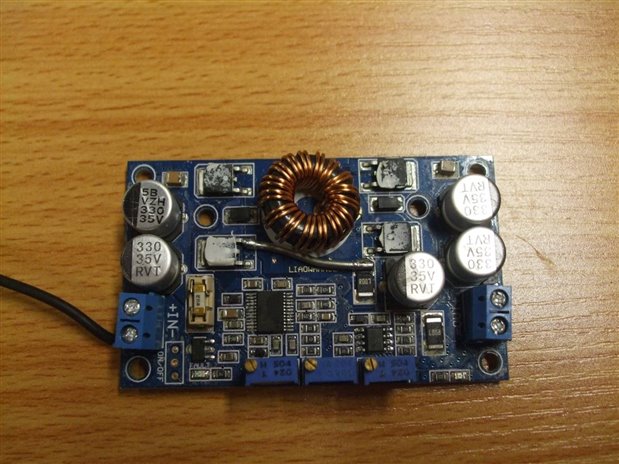

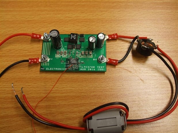

    This module, and indeed this chip, are not very suitable for a lab power supply.
    The 3780 seems to result in staggeringly noisy power supplies - in 2016 I was helping a customer with issues related to switching noise from this chip which they were using on a new board. I tested their original board, the Linear Technology demo board, a Chinese board a bit like yours and 2 different boards that I designed. They were all quite efficient and incredibly noisy. In the end we gave up on it altogether and used a buck regulator and some other design changes on the customer's board.
    I think that the buck/boost architecture, combined with the use of external MOSFETs just makes for a really noisy design.
    It does depend on what you are doing but for most people low noise and repeatable behaviour are the key things you need from a lab bench supply - go for a linear design.
    Just for fun I've attached some pictures from my archive of bad results with LTC3780:
    Chinese board (I removed the heatsink)
    First attempt
    Second attempt with extra filters - which helped but not enough.
    MK
