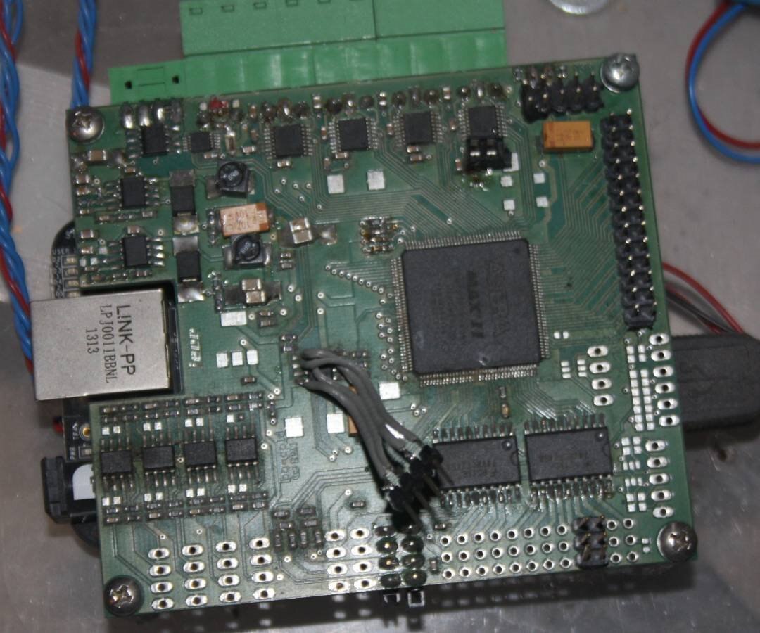

When you build robots you always have to control lots of motors or RC servos. If you use a micro controller as main computing device you are fine because these devices have plenty of PWM outputs to control motors. But when you switch to more powerful controllers like the Raspberry Pi or the BeagleBone Black you have a little problem because these only have two or three PWM outputs and you can't stick your motor drivers directly to them.
Then you usually use an additional motor controller board with a micro controller and connect it via serial or SPI to your Raspberry Pi or BeagleBone. Another option is to use a CPLD, connect it to the main CPU via SPI and generate the PWM outputs with this device. I built a board doing this and I will describe it here.
Hardware

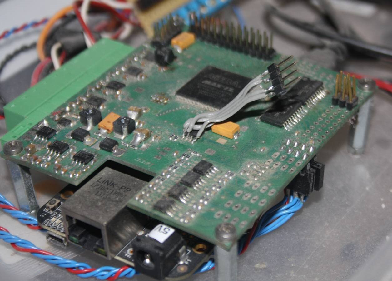

Here are two photos of the board:
You can find the schematic attached to this blog post.
The board is plugged on top of the BeagleBone black. The schematic consists of the connector to the BeagleBone. Then the CPLD Altera Max II EPM1270 in a TQFP144 package. Every free pin of the BeagleBone is connected to the CPLD but only the SPI pins are used. There are four motor drivers TI DRV8800. Additionally there are outputs to control twelve RC servos and inputs/outputs for four ultrasonic distance sensors. Finally there are some op amps to connect odometer sensors.
Also there are power regulators on the board to generate the supply voltage for the BeagleBone Black and the RC servos.

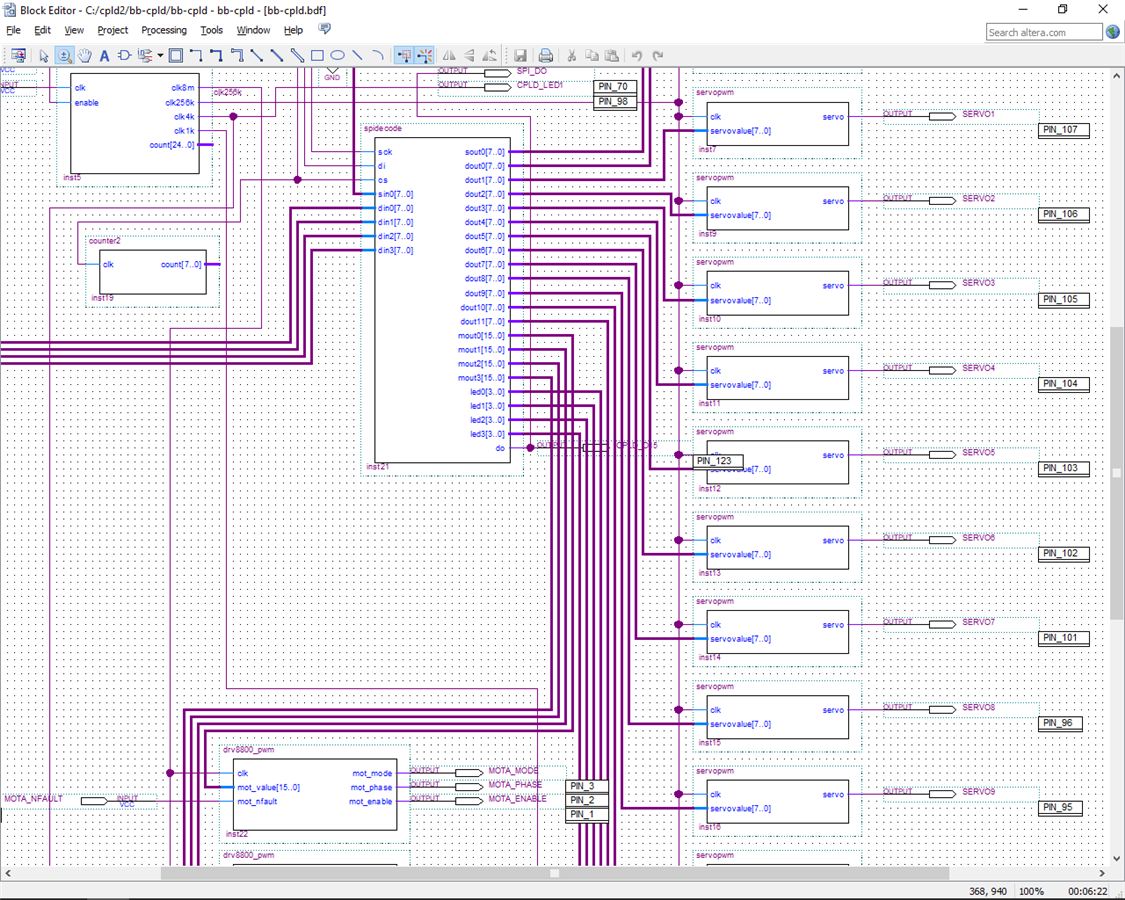

CPLD code
The CPLD code was made with the Altera Quartus II software.

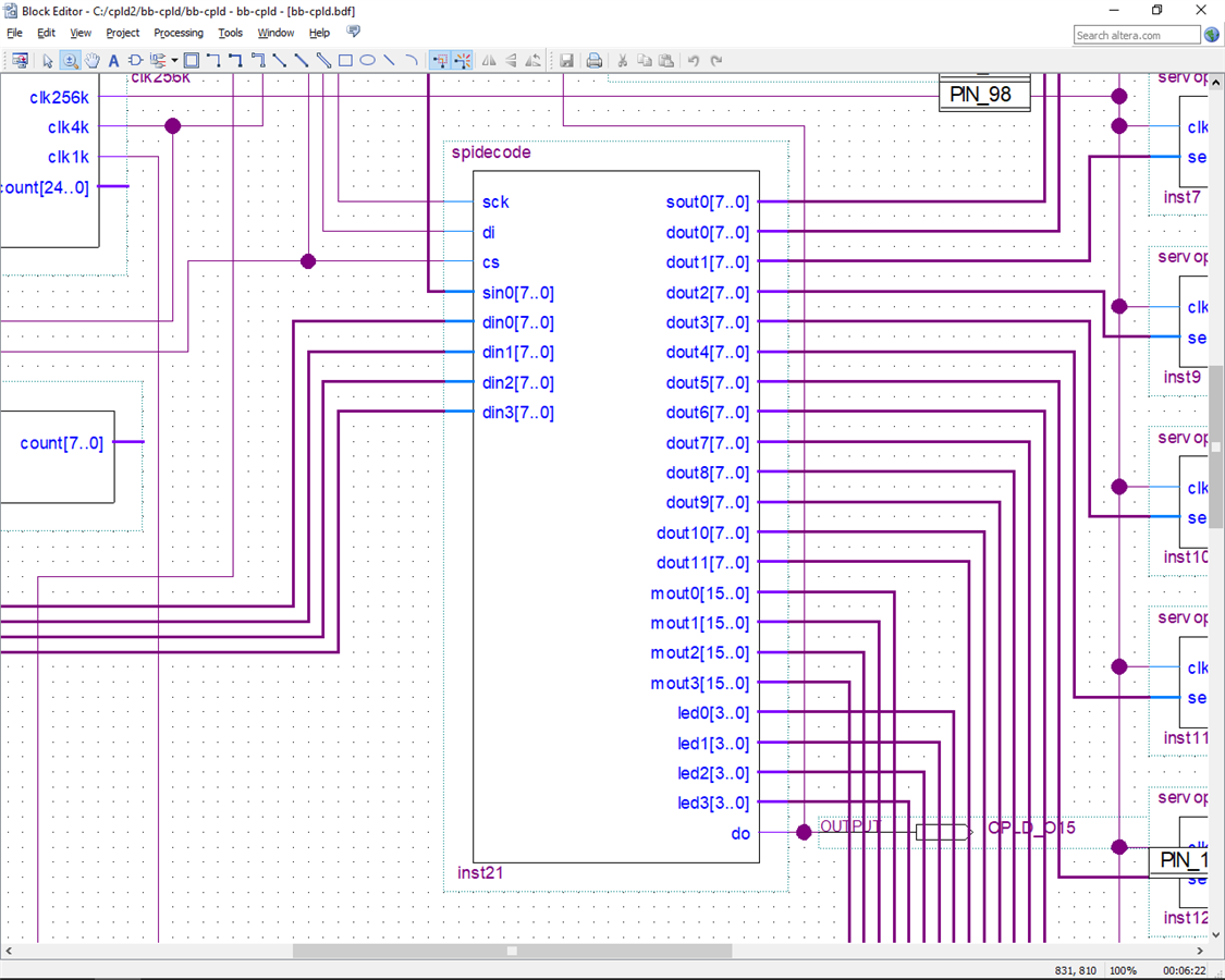

The concept is that you always send the full stack of registers with one SPI transmission. So you don't have to decode which register has to be changed. And so the code is quite simple and consists mainly of a big shifting register which parallelizes the data of the SPI port and sends them to the right function block.
There are function blocks which generate the PWM signal for the RC servos. And there are blocks which generate the signals for the DRV8800. There are always multiple identical copys of the same function blocks as the function are needed several times on the board.
The clock for the PWM is generated by a clock output of the BeagleBone and divided internally in the CPLD.
You can find the whole code on github: https://github.com/generationmake/bb-cpld
