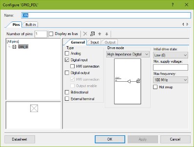

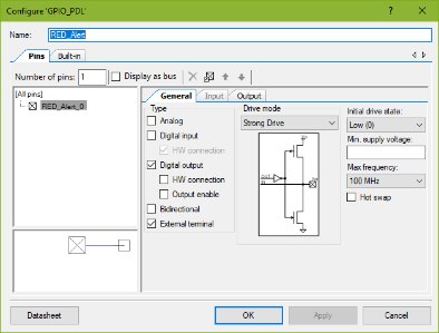

Read GPIO Pin and Set LED
     The GPIO pin used is F5, port P11[0]. You can find it as 11.0 in the Cypress PSoC6 BLE Pioneer board. The Red LED used is pin E3, port P0[3]. You can find this as P0.3 which the RGB LED on the board.
Code
volatile uint32_t pinReadValue = 0ul;
pinReadValue = Cy_GPIO_Read(DIN_PORT, DIN_0_NUM);
if(1u == pinReadValue)
    Cy_GPIO_Set(RED_Alert_0_PORT, RED_Alert_0_NUM);
else
    Cy_GPIO_Clr(RED_Alert_0_PORT, RED_Alert_0_NUM);
     You can also use the below line to write a GPIO Pin
Cy_GPIO_Write(RED_Alert_0_PORT, RED_Alert_0_NUM, pinReadValue);

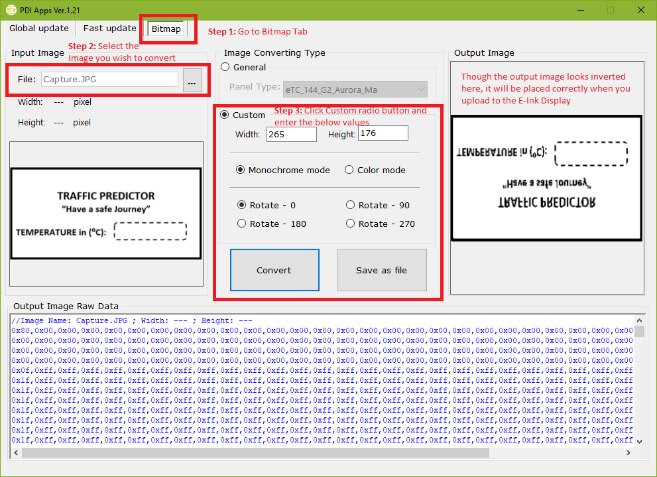

     The E-Ink Display shield display images from an array of raw data of the image as below.
cy_eink_image_t logo[CY_EINK_IMAGE_SIZE] =
/*Your Array contents from Output Image Raw Data goes here like below
0xff,0xff,0xff,0xff,0xff,0xff,0xff,0xff,0xff,0xff,0xff,0xff,0xff,0xff,0xff,0xff,0xff,0xff,0xff,0xff,0xff,0xff,0xff,0xff,0xff,0xff,0xff,0xff,0xff,0xff,0xff,0xff,0xff, // 1
0xff,0xff,0xff,0xff,0xff,0xff,0xff,0xff,0xff,0xff,0xff,0xff,0xff,0xff,0xff,0xff,0xff,0xff,0xff,0xff,0xff,0xff,0xff,0xff,0xff,0xff,0xff,0xff,0xff,0xff,0xff,0xff,0xff, // 2
     This can be obtained using the PDI application from Pervasive displays by clicking here. Step by Step instruction for the same is given in the screenshot below. The content below the 'Output Image Raw Data' is the array data of the image required to display the image in the E-Ink Display Shield.
     Declare the image variable as an extern in the header file, to use it anywhere in your project.
extern cy_eink_image_t logo[CY_EINK_IMAGE_SIZE];
     You can display your image  using the below code snippets
//Method 1 - Display image in full screen
Cy_EINK_ShowFrame(currentFrame, logo, CY_EINK_FULL_2STAGE,
  CY_EINK_POWER_AUTO);
//Method 2 - Display image from the co-ordinates you define
uint8 const  fullFrameCoordinates[] =   {0, 33, 0, 175};
Cy_EINK_ImageToFrameBuffer(frameBuffer[currentFrameBuffer],
                           (uint8*)background,
                           (uint8*)fullFrameCoordinates);
