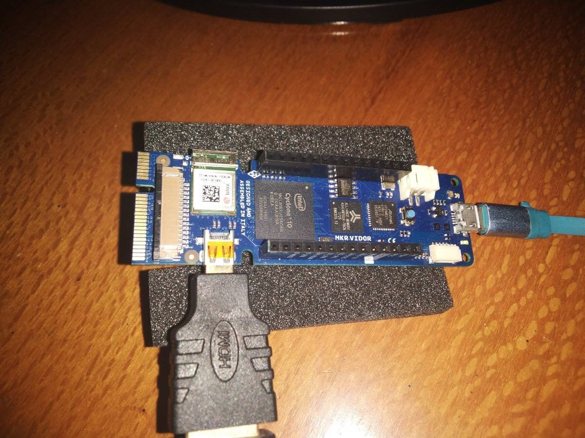

I wanted to do something useful with FPGA as I had Adruino MKR Vidor laying around which I had received for a past contest. The Vidor is still not so beginner friendly but its Graphics Library is still awesome. Also, I had almost forgotten it has WiFi and a microcontroller also. So, I wanted to make something which uses all of the microchips and which can be used on a day-to-day basis. So, the direct thought came was to do something with display because the Vidor has an HDMI (micro) port and also a great library.image

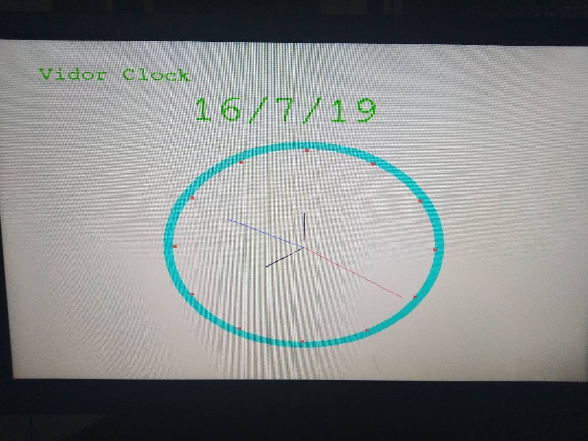

For the project, I thought of making a digital clock- which shows time in analog format and it will also show the date and other information. This will test out my trigonometry skills as well as it can use the internet. Here's how it works...
Working:
The Vidor connects to the internet with the help of its WiFi chip (Esp32) and gets the time in the world via NTP Server. Then the time is stored in the RTC of SAMD21 microcontroller. That time is then displayed in analog format with the date on an HDMI monitor. After the day is over it will automatically sync the time with the NTP Server again and hence it will also remain very accurate.
The output on Monitor is done by Intel Cyclone FPGA onboard.

A Bug in the code.

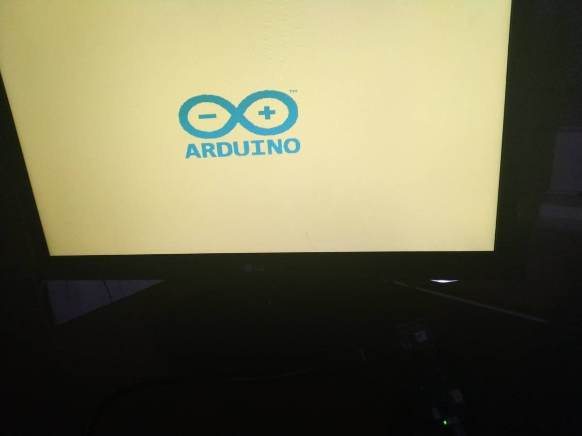

A Arduino Logo shown when programming and loading(starting) of Vidor

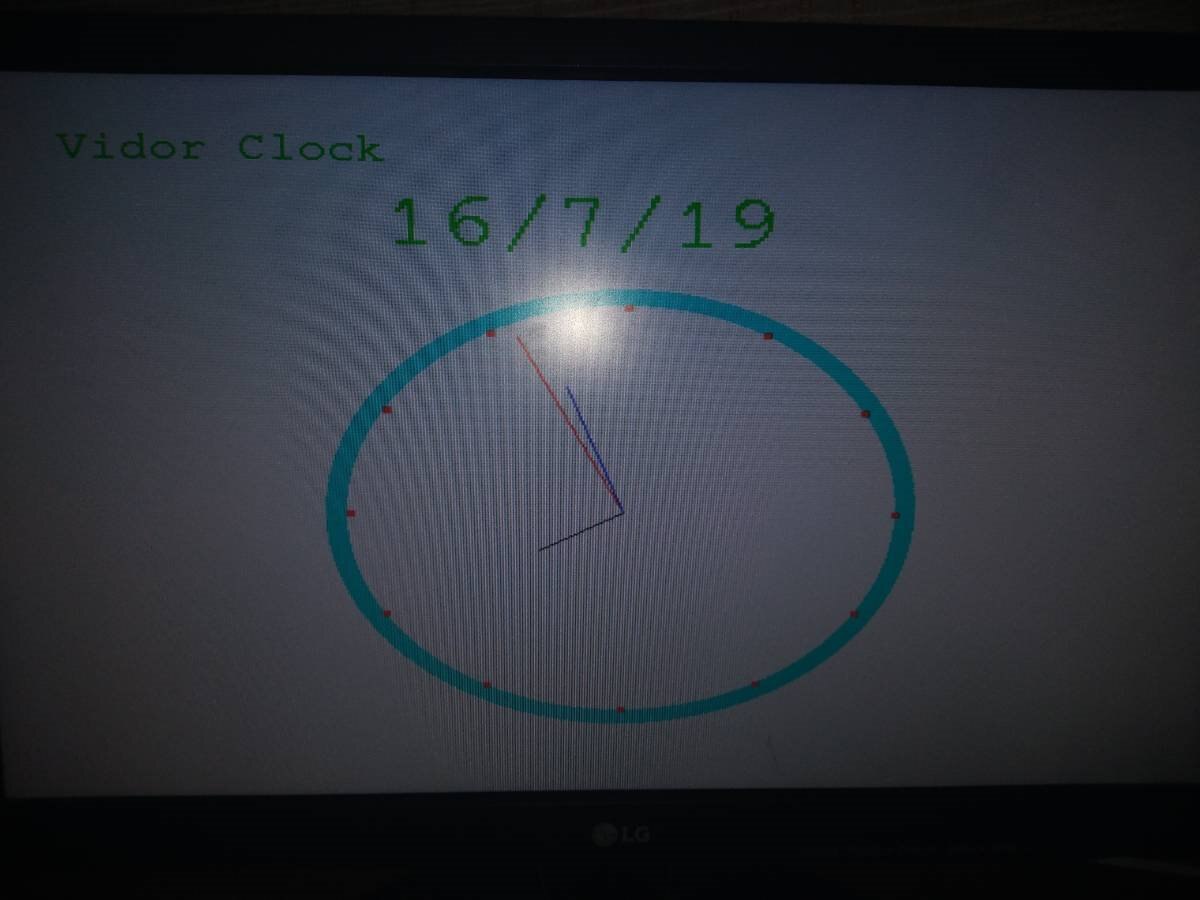

Time is shown on Monitor.

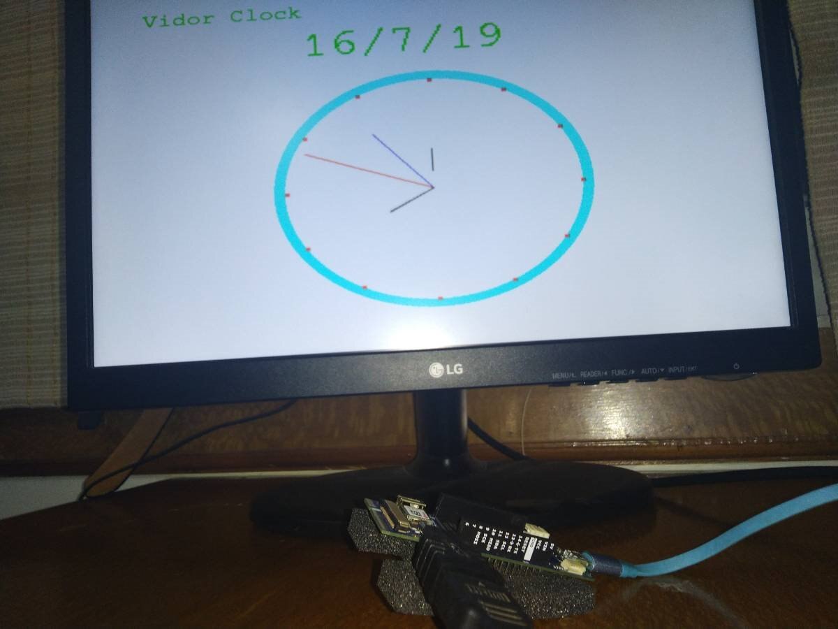

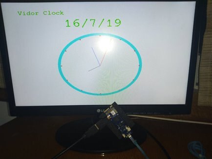

Vidor Connected to Power and Monitor
Vidor Clock in Action
