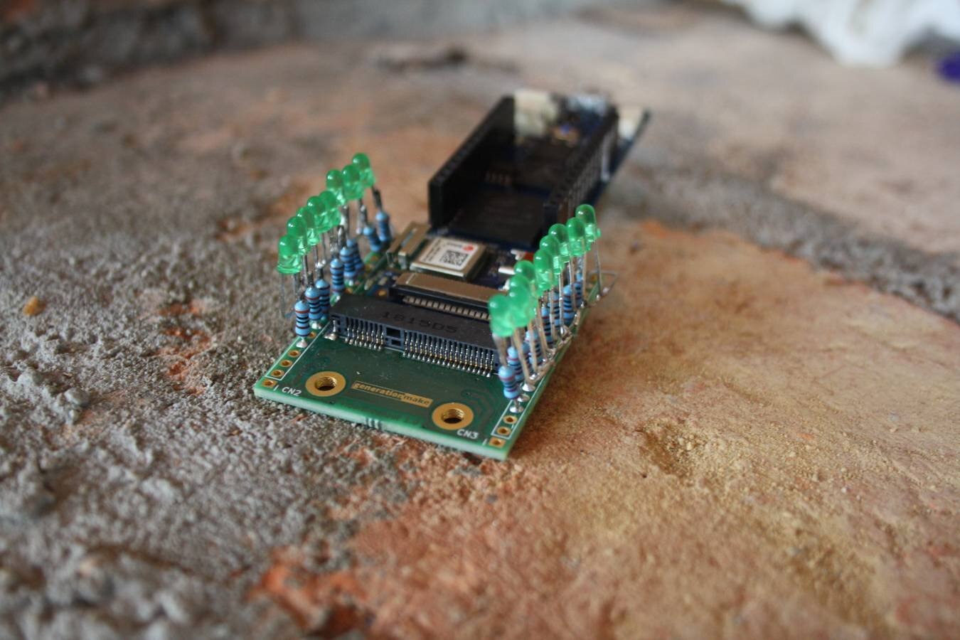

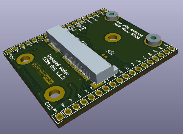

VidorBreakout board
To access the pins one could directly solder cables to the pads which is a bit tricky or use an adapter. I couldn't find a good adapter so I made my own. You can find the data here:
https://github.com/generationmake/VidorBreakout
The breakoutboard connects all GND and 3.3V pins and brings only the GPIOs seperately to the pinheader. Additionally the Vidor can be directly srewed onto the adapter with a M2.5 screw and both form a solid unit.

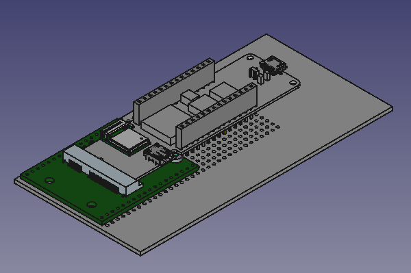

The design was made using 3D models and FreeCAD so that there is no collision.
The adapte follows the 2.54 mm grid of the Vidor. So both could plugged into a breadboard. Althought you would need a special breadboard because the adapter is wider that a regular breadboard.
To demonstrate the function of the GPIOs and the adapter I made a LED sequence using 17 green 3mm LEDs with a 3.3 kOhm resistor connected to ground.

    A great project! This is the first time I have seen the mini PCIe of Vidor being put to use! Just a question: Which service did you use to make that OCB?
  • bernhardmayer
    bernhardmayer over 6 years ago in reply to vimarsh_ +2
    Hi Vimarsh, thank you. My first idea was to get more IO pins. Because with Arduino MKR I often run out of pins. Unfortunately you only can use them as GPIOs. And the documentation is very bad. There are…
  • theusbblaster
    theusbblaster over 6 years ago in reply to bernhardmayer
    Hi Mr. mayer
    Is it possible to use these pins as analog inputs or PWM outputs?
  • bernhardmayer
    Hi Vimarsh,
    thank you.
    Unfortunately you only can use them as GPIOs. And the documentation is very bad. There are also PWM, I2C, UART and SPI cores in the FPGA. But these functions go only to the MKR pins. I would be no big deal to expand these cores also to the Mini PCIe connector. But Arduino hasn't disclosed all necessary source files for the FPGA so you can't impelement them on yourself. You have to rewrite the whole FPGA code. At the moment I have no plans to do this.
    The second challenge was to connect the breakoutboard to the Vidor and keep the MKR pins available. I think my solution is a good compromise.
    The board was designed using KiCAD.
    The PCBs and parts were ordered at Aisler: https://aisler.net/generationmake/playground/vidorbreakout
    And then I hand soldered the parts.
    Bernhard
  • vimarsh_
    vimarsh_ over 6 years ago
    A great project!
