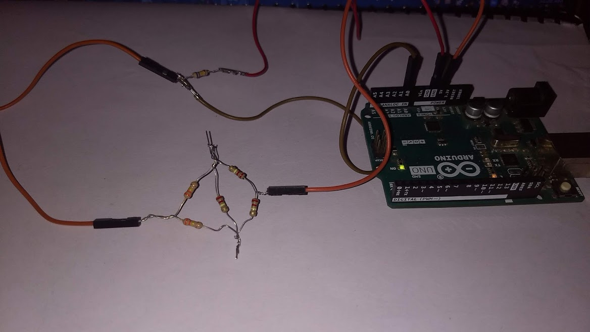

Building the OHM - MeterThe below circuit is made and the following code is flashed into the Arduino
Schematic & Code on simulator AutoDesk TinkerCAD
  • Actual Circuit and Code ,oberving values & OHM-Meter in action

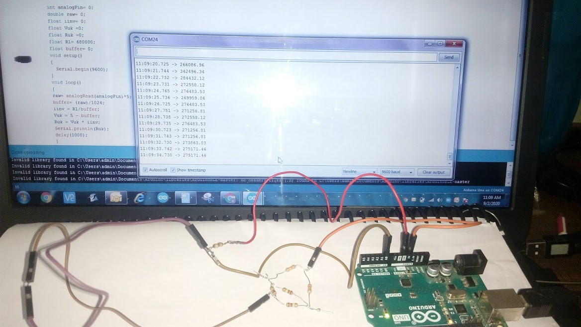

Code & it’s working
Basically we first initialise variables(known resistance is of 680k ohm) in the code , then we also start the serial communication , First we take the value measurement of voltage drop by Known Resistor through the Analog Pin (A0) , which is in 8 bit relative form (where 1024 represents 5v) , so we multiply with 5v(input) and then divide by 1024 in buffer variable to get the voltage drop , then iinv stores inverse value of current by calculating value using OHM’s Law , the Voltage drop by unknown part is calculated by subrating drop caused by known resistor(buffer) from input voltage(5v) , then the unknown resistance value is computed by  using OHM’s law again and dividing voltage from current (ie V/I) by taking product of Voltage of unknown resistor(Vuk) and current inverse(iinv) , we get the value of the unknown resistance and its displayed on serial monitor and reiterate after 1 second.
Verifying the Build with Wheatstone Bridge

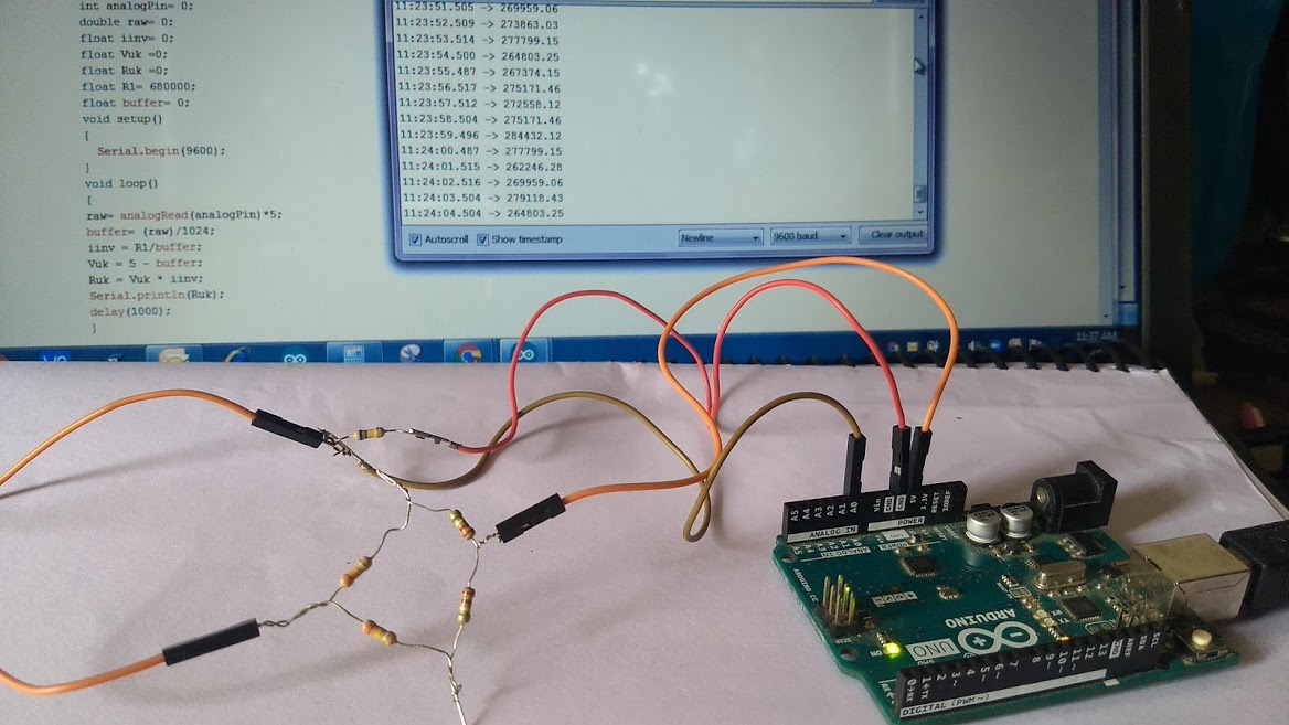

In the project to measure the values of unknown resistance  we use the wheatstone circuit (it was chosen because it is one of the most common and is widely used for accuarte measurements of unknown resistances),as the unknown circuit to verify the calculated resistance by OHM-Meter is correct or not .(Known Resistance=680k Ohm)imageR1=220k ohm, R2=220k ohm, R3=220k ohm, R4=330k ohm, R5=330k ohmAs here (R1/R4)=(R2/R5) which satisfies the whetstone bridge condition , which implies the both ends of R3 are at equipotential thus no current flowed through it and it doesnt cause any voltage drop , so we can ignore it while calculating net resistance , the equivalent resistance is Req = ((R1+R4)*(R2+R5))/(R1+R4+R2+R5)On putting values here we get 275k Ohm , while the readings are in approx range of 269k-277k ohm , which verifies that the build is successful and results are pretty accurate.
Results and ConclusionThe results observed in the measurements using OHM-Meter are preety accurate , the error percentage is less than ± 5% which is very good considering that all resistors used here in project also had tolerance of ± 5% ,therefore the obtained results are acceptable for measuring resistances.The conclusion of this projet is that this OHM-Meter can be a very useful tool to measure resistances but also has its limitation that the known resistance that is used for reference for measurement should be in significant range of the known resistance , if the difference is higher between both of them then the error percantages increases drastically.This limitation can be be overcomed two ways
