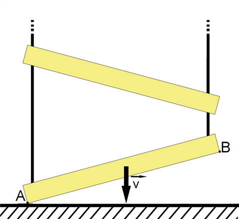

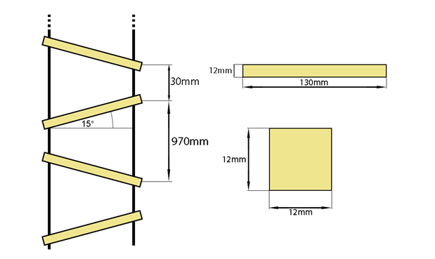

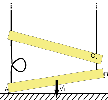

     Before we get into the experiment let's see why this phenomenon occurs and what are some of the relevant parameters that we can look at. The problem is really simple, we have a chain that falls on a flat surface so let's examine what happens when one of the wooden blocks hits the surface.

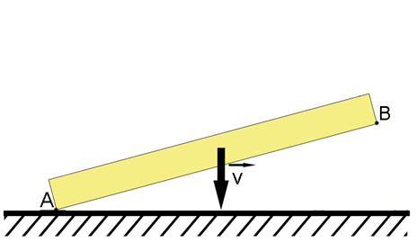

In the picture above we can see a single wooden block at the moment of impact with the surface. Right before the impact, the block was going at some velocity v, in the ideal situation as the block hits the surface, the point A will stay "glued" to the surface while in reality we will have a small bounce, with point A going up after the impact. But we can look at it like it starts swiveling around point A, which means the velocity of point B will increase. There is a lot of things happening here at the same, the whole block slowing down upon impact as well as then having a small increase in speed of point B. Let's look at the bigger picture now with multiple blocks of wood in a chain like it was described.
Now if we look at this picture we can see the same block we talked about before, but this time, with another block above it. The wooden blocks are firmly attached to the string, so, as the first block hits the ground and starts going down, the right string, where the point B is, will start puling on the whole chain above, making it increase its velocity.
Here we can see how that looks, as the lower block start going towards the ground it will pull on the right string, then the next block will pull onto the left string and so on. This is an idealized model on so many levels, we are looking at strings like they can't be stretched, we are looking at blocks like they are completely homogenous and that they don't bounce as well as that every block hits the surface perfectly, but of course in reality, there will be deflection when bouncing even blocks hitting one another during a bounce back and so on. But still, this is enough to theoretically explain why this phenomenon occurs.

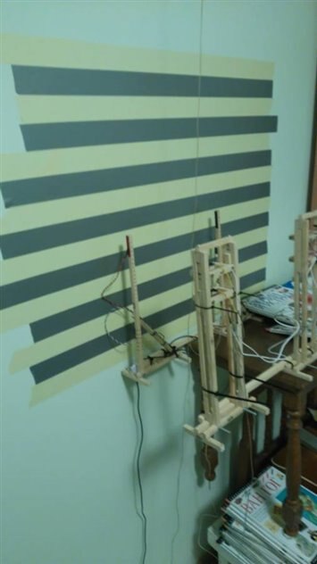

     Now we're getting to my favorite part, designing and making the experiment setup. The experiment is not mandatory on the competition, but of course, it is highly valued. This was one of the experiments that wasn't that easy to replicate because it required a lot of making stuff and a lot of set up for it to show some results that the effect exists. But for me again, this was the reason why I like this competition so much. I will be using 2 different methods for proving this phenomenon, one being a camera at 120fps and the other one being Arduino laser gates that I made.
Idea
{tabbedtable} Tab Label Tab Content
Experiment Set-Up

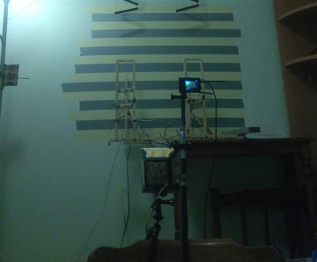

Camera

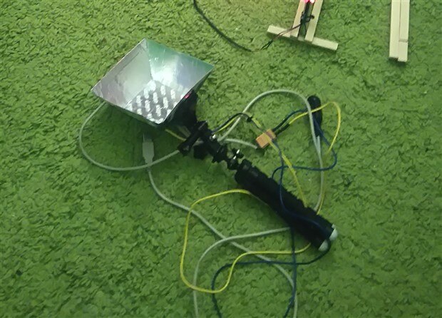

This was the approach inspired by so many Myhbusters experiments. I used my action camera which can record 120 fps and just made a background using 2 types of tape so I can easily track the speed, besides that I came up with a cool little idea of adding an LED with a button cell at the last wooden block which made a huge difference in recordings as I will show later.
Laser Gates
Besides the camera I wanted to make a set of laser gates, putting it short, I used 4 IR LED-s and 4 IR transistors which react to the IR light. How I made the holders and interfaced with Arduino will be covered in the build section coming after this. I was dropping 2 chains at the same time, so I had sensors positioned at the same height for both chains to make the results valid, here is my idea of the set up:
Quick Release
Besides that I just made a small quick release mechanism at the
Experiment Analysis and Set-Up
Experiment Design
As I've already stated, I wanted to use 2 approaches for gathering data for this experiment, one being the camera and the other being the laser gate system. But that can't be all, there is some background stuff needed for everything to work correctly (this was 3 years ago, I have a lot of pictures and videos but not everything). Some of the questions I needed to answer when designing this experiment set up were:
  1. How do I drop the chains simultaneously every time?
  2. How do I make sure they are dropped from the same height every time so I can compare results?
  3. Background for filming with the camera?
  4. Lighting for filming with a higher FPS?
  5. Mounting the camera?
  6. How easy is it to set up the experiment again?
  7. Gathering Data?
  8. Constructing chains with proper geometry?

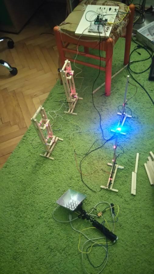

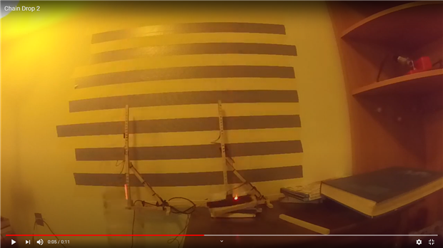

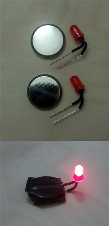

Camera Set Up
Considering the camera, we have to look at a few of the points made above, specifically points 3,4,5. Let's start with question 3, this is where I drew a lot of inspiration from the Mythbusters, I took 2 kinds of tape that were the same thickness and glued them one underneath the other giving me a scale of my wall which made it much easier to know what I was looking at because I had a reference in the background of the shot. The camera needed a bit more light for the 120 fps video so I made a small LED reflector where I mounted a 4x4 grid of LEDs on a piece of cardboard covered in aluminium foil, sadly I don't have any clear pictures of that, and as for mounting the camera, I managed to mount using a ski pole in location where it was both easy to access but with a good shot. Here is how that set up ended up looking like:
Here is kind of blurry shot that I have of the light that I mentioned:
For the camera part, this set up turned out to work pretty good, but I had a cool little idea which proved to give some extremely good results. I took the standard 3mm LED and with some electrical tape attached it to a button cell, and then just attached that to the highest wooden block. It really made a huge difference when looking at the videos, since we can look at the position of the LED mark as well as how long of a streak it left due to the camera shutter.

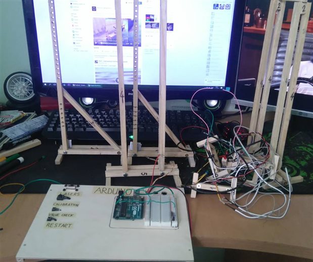

Laser Gates

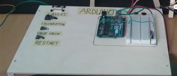

We now come to the laser gates, to make this, I used an Arduino Uno, 4 IR LED-s and 4 IR transistors. My idea was for both of the chains as they are falling to break the IR beam with the center of the chain giving us valid results that we can then compare to each other. It was a bit tricky aligning everything together, but it was doable. It was critical for the sensors to be positioned at the same height so the results can be compared, but I made holders which enabled me to do that into which I'll get into in the next part of this blog, here is how that set up looked like:
I made a small control board out of plywood to which I attached a few buttons, Arduino and a protoboard, to make everything a bit easier to set up every time. The Arduino would be powered via the USB cable, so I saved all of the data on it at first and then printed everything out onto the serial monitor, I then took that data, put into Excel where I saved everything and later did some plotting using various software I had. Here is a picture of the set up on the ground, where I was testing out alignments and stuff like that:

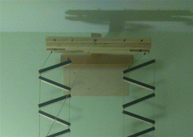

Now we have to tackle question 1, 2 & 6. To make the experiment repeatable where we drop the chains from exactly the same height every time simultaneously I designed a simple quick release mechanism, here it is here in the picture:
And here is how it works, there is a base that is mounted to the wall with slots on both sides with holes going through both of those slots. Besides that, there is a moving rail, which has to pins which go into those holes and hold the 2 chains in the slots on the side until I pull on the string hard, making the pins go out of the slots letting the chains fall. It's a pretty simple mechanism but it really worked perfectly for what I needed, I managed to get many tests with it without having any issues at all!

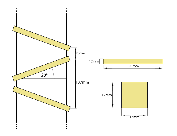

Chain Template

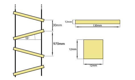

To solve the final problem, number 8 I had to make somehow these chains, multiple versions, but I needed to make sure they had the right geometry. To do that I made a template (don't have any pictures of it), where I glued a couple of pieces of wood onto a plywood sheet and just slot in the 2 pieces of wood there and tie them up with string. To be able to compare different chains, I watched out for one thing, and that was that the distance between the centers of the wooden blocks on every chain had to be the same. Here are some measurements I used:

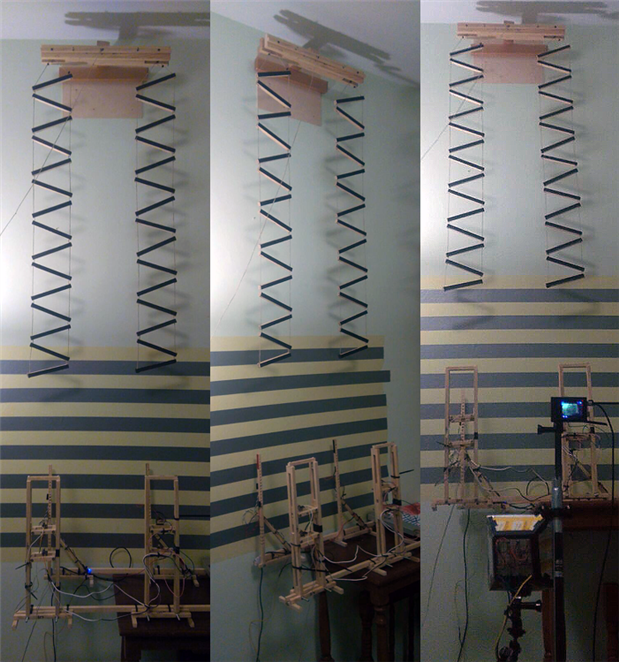

In the part above I explained the whole experiment set up and what I needed, the only thing that needed making were the holders for the laser gates. I made them out of wood planks that were 10x10 mm and I just cut a lot of them to size and glued and screwed them together. I needed 2 sets of them that were exactly the same so I could get the same comparable data. Another thing I needed to make was the quick release mechanism which was also just a couple of planks, nothing complicated when it comes to the mechanical build here.
This is the setup how it looked like while being used, a lot of books and everything else I could finally to level the table up, but surprisingly, it was pretty sturdy in the end. The back vertical planks had multiple holes drilled down it where I was able to put in the IR transistor, while the front had something like a rail down which I can slide the IR LED until I got a precise hit. The bigger the distance between these 2 beams, the better the overall accuracy of my apparatus, but than we wouldn't have such a good look at the speed at that very moment, so our measurement wouldn't be that good. With the chains mounted on the quick release mechanism here is how the whole set up looked like:
And of course to gather all of the data I used the Arduino Uno on the control board that I made
The control board consisted of a few buttons which were used for checking out how good the alignment was, restarting the data acquisition process as well as turning on the lasers.

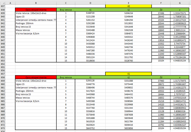

The code was pretty bare bones, as much as I can tell from it, I used analog pins to read the data off of the sensors and saved them until the end when I then went out and printed the data out on the serial monitor. I printed out raw data, because I remember I had problems with converting that raw data into normal data using the Arduino, so I used Excel after that. Here is a picture of how one of those excel tables looked like:

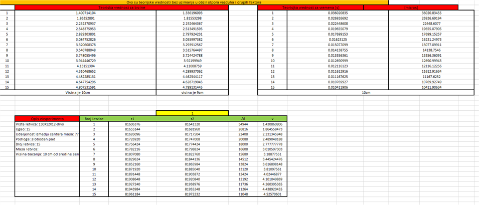

In the end, this is how many of those tables I ended up with:
41 tables in total. Not all of them good, on some I had where it didn't register one of the blocks, or it had some other kind of bug, or the release mechanism didn't work perfectly and so on, but I managed to get a lot of data out of the laser gates, which I will be covering shortly. The 2 red tables at the top are theoretical values that can be easily calculated for free fall which I used to see how precise my apparatus was. With all of that out of the way, it was time to drop the chains and see if we get some good results. Here are a few videos and pictures which showcase the phenomenon pretty good.

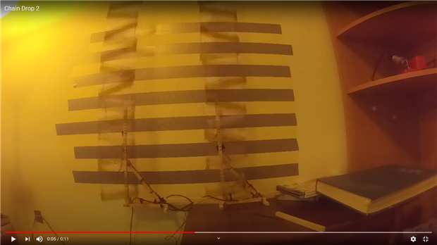

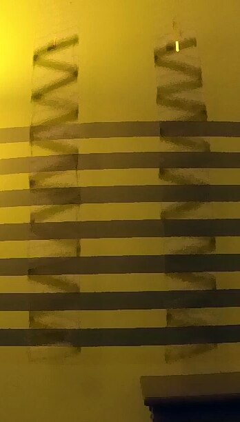

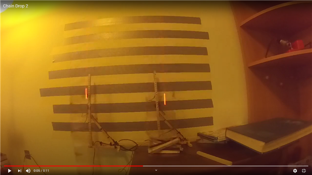

     Here are a few videos of me performing the experiment, in the first video you can see the chains falling between the sensors and lasers sending out that info to the Arduino where I later use that data to make graphs which I will be showing later.
Not much can be seen in this first video, except the chains falling, but take a close look at the 2 upcoming videos now.
I suggest you use the 0.25 speed of the video on YouTube for the chain fall and compare the 2 chains. Here are the screenshots from one of the videos which we can use as a proof of phenomenon. In the first screenshot which you can see here:

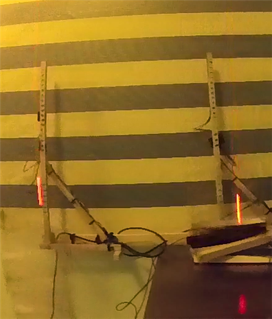

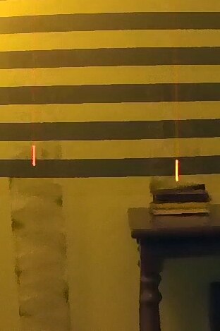

This is right before the impact with the table, if you look at the first wooden block, you can see they are pretty much at the exact same height, as expected, because they are both the same chains and free falling, but if we go down the video a bit further, things get a lot more interesting, take a look at this frame:
In this frame, you can see that the light trace on the right is both lower than the one on the left, and longer than the one left, which means it's lower and has a higher velocity which means that the chain on the right is going faster than the chain on the left, if we go a few frames further, we come across this:
In this frame we can see that the chain on the right is completely flat on the table, while in that time the chain on the left just got to the height of the table, further proving that the the chain does in fact speed up when it hits a raised surface, proving that the phenomenon that we are testing out is true. This is more than enough to call it true, but now, let's get into some results and analysis of the data that I got using the Arduino and the laser gates.

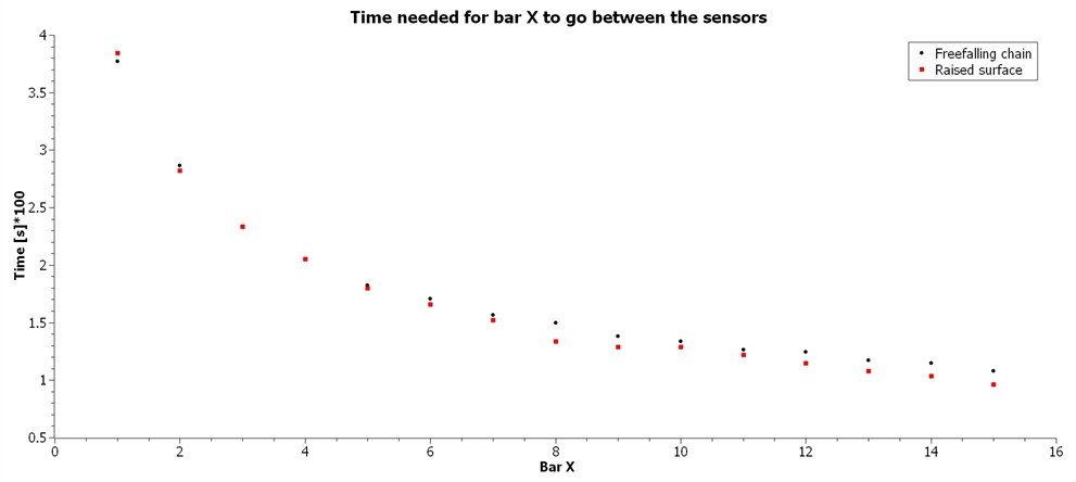

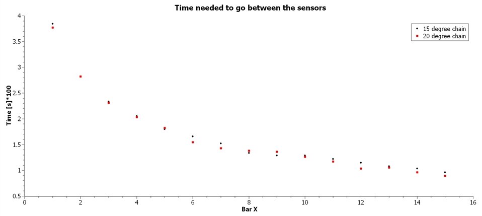

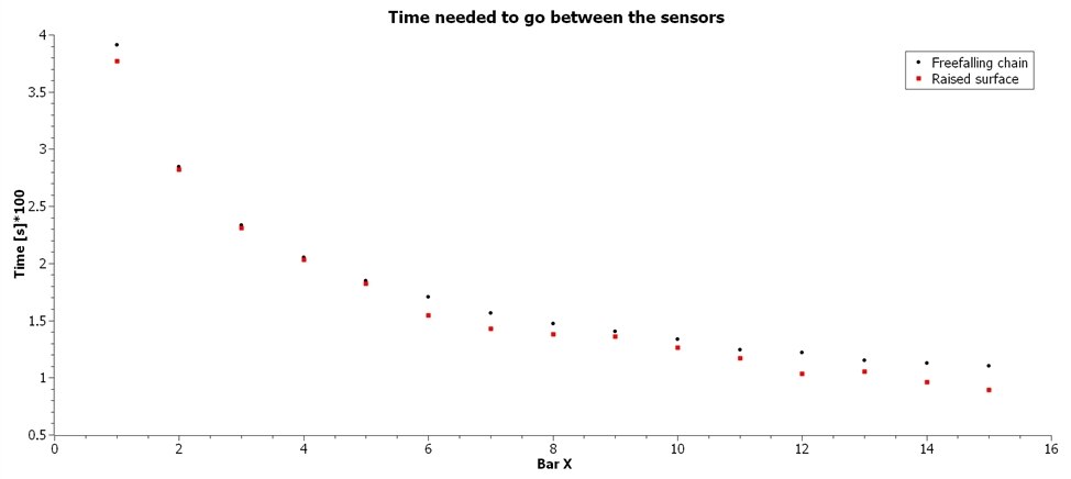

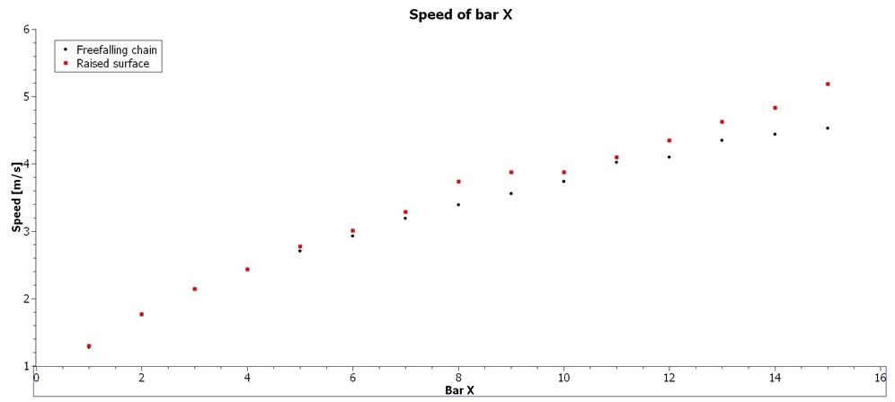

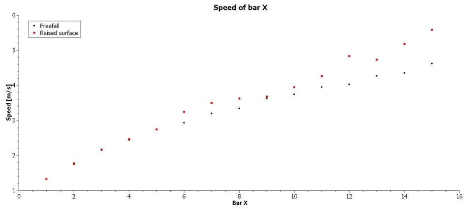

6. Results & Analysis
     This is the part where the laser gates really shine and where they prove they really got some serious results, to start off, it's best to start with a calibration run. A calibration run is a way for me to drop the chain, measure the times, and compare them to the theoretical values that I've calculated. This can easily be done for a free falling chain with the most basic high school physics and a bit of time, this way, we will both check out how good the laser gates are as well as how good the chain is made, because if there are any imperfections anywhere, they will show in the results.
Free fall calibration
Comparing with the 15 degrees chain
Comparing with the 20 degrees chain
Comparison between the 2 chains

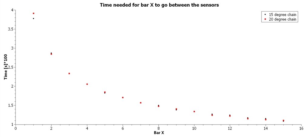

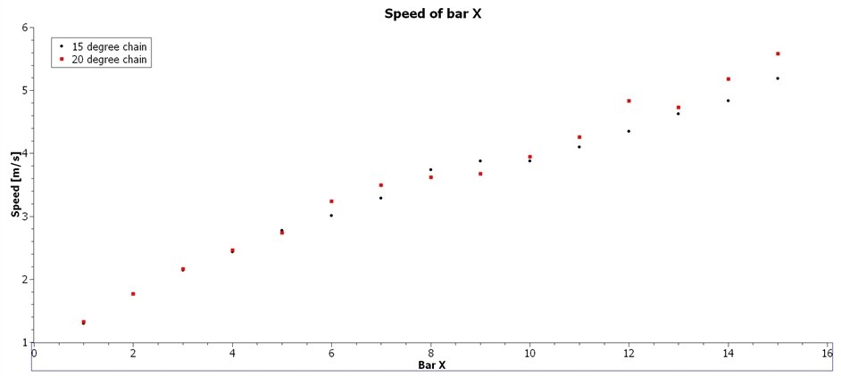

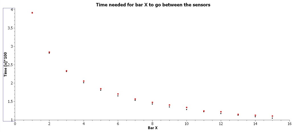

On the graphs above we can see the time comparisons, the first graphs shows us the difference between theoretical values and the 15 degrees chain, the second one shows us the difference between the theoretical and the 20 degrees chain, and the last one shows us the difference between the 2 chains. As we can see from all of the graphs, the results are extremely good, (the string I used wasn't completely unstrechable, so I could never make a perfect chain). Satisfied with these tests we can go and look at the values when we have a raised surface.
15 degrees chain
15 degrees chain experiments

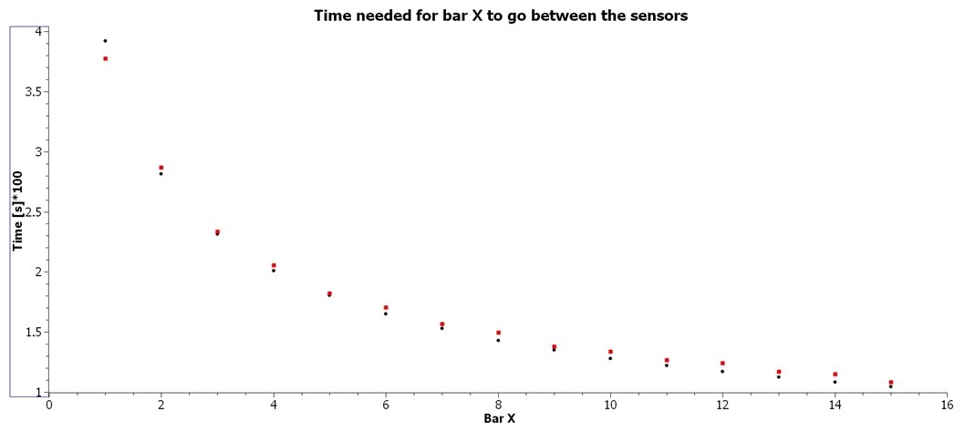

Here I will show the results I got for the chain with the 15 degrees wooden blocks, here are the graphs representing the time and the speed for this chain, comparing it to the free fall values:
If we look at both graphs, we can see that at the beginning there is no difference, since the laser gates are a bit above the surface, so the first few wooden blocks won't be affected by this phenomenon. After a few blocks, we can see a trend where the time needed for the wooden block to pass between the 2 sensors in always smaller on the chain falling on the raised surface, compared to the free falling chain, if we calculate that into speed, the effect can be seen even better, but the time difference is a much more significant thing. And with that, we again have proof that this phenomenon is correct, this time with actual data to back it up using an Arduino Uno! To further experiment with this chain, I tried putting foam on the table, to simulate a softer surface, but it showed no difference when it came to the results, as you can see from the graph below:
20 degrees chain
20 degrees chain

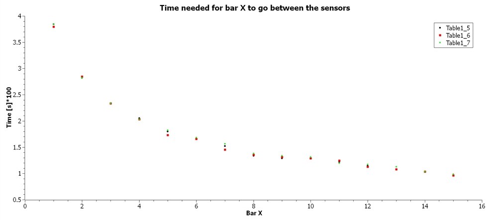

On the graphs above for the 20 degree chain we can see exactly the same thing as we did for the 15 degree chain, it's a pretty much exact value until we get a few wooden blocks in when the effect starts taking place, where we get the effect of the chain falling of the raised surface going faster.The time difference we see on the graphs accumulates with more wooden blocks we have. Here is what we can see when we compare the 15 degree chain with the 20 degree chain:
On these graphs, we can see as we expect, no difference between the times or speeds at the beginning, but as we go further, we can see some inconclusive results because the chains aren't perfect and they don't always behave as expect on the every single link, but we can in the end see a significant different in speed when we look at the last link of the chain, meaning that the 20 degree angle gives us a bit of a better effect than the 15 degree chain.
Camera Results
Camera Results
These are the results I've already showed in the blog, but here are a few more pictures showing us how the camera captured the difference between the 2 chains. The things to look out here for is what trace is longer compared to the 2, that shows us speed because the camera shutter is a constant time, so the length of the trace is proportional to the speed on the wooden block, as well of course as the position of the trace itself.
That would be one set of results, and here is another set for different chains, the first ones for the 15 degree chains and the second ones are for the 20 degree chains
On this picture we can see the chains floating in air completely at the same height, have in mind because I was using an action camera it has a fish eye lens which gives the curvature seen, but using the background we can see they are at the same height.
And on this picture we can see at the very end how further down the chain on the right is compared to the chain on the left, also it has a longer trace, meaning that it is actually going a bit faster at that moment than the chain on the left.
With that we can conclude the experiment and problem solving finished, I defined the problem a short theoretical explanation and using the experiment set up proved the phenomenon, proved the experiment set up was valid with the calibration test and using 2 different methods did experiments for different set ups with a few different parameters. I am really happy or better said, astonished by the results I managed to get with a set up like this. Further than this, we can try out different wood type blocks, different height drops and so and so on, but these are some basic parameters I had time to test out.
