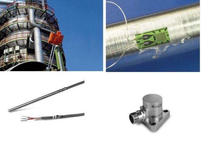

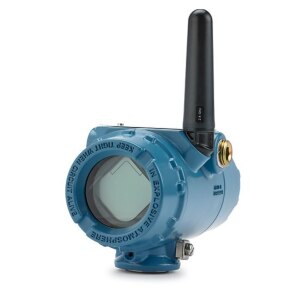

Luckily, some other technology has emerged:  wireless industrial transmitters.  They can be used to automate the monitoring needed as well as make it easy to install without a major capital project.  The transmitters meet all the electrical classification requirements of Class I Div II Areas - which means their enclosures can contain an explosion inside of them if they were to spark - and they would keep out external gases that could ignite.  So, one would never have to worry about the atmosphere around the devices or require a Low Energy permit as long as the enclosure stayed closed - just as any control box in the field.
Rosemount 648 Industrial Sensor Transmitter - Loving to Meet the Arduino
By taking Rosemount 648 Wireless Transmitters used for normal internal process condition monitoring, one can establish an adhoc strategy to measure the fixed equipment vital conditions where the hurt is:
  • Surface Temperature
  • Strain
  • Vibration
  • Thickness
They just need to pair with sensors made for permanent installations as shown below.
Top Left:  Permasense Thickness Monitoring
Top Right: Strain Gage
Bottom Left: RTD temperature sensor
Bottom Right: vibration sensor
Normally, control systems monitor what is in the pipes and vessels - not the assets themselves (with the exception of large furnace tubes and rotating equipment).  As stated before, inspection technicians are sent out with hand held devices to take X-rays, shoot IR guns for temperature, and measure thickness with UT meters.

Here's the big bummer - the gateway doesn't store data!  For permanent installations, versus this project's adhoc freaky increased monitoring, it would normally be hardwired into a site's Distributive Control System (DCS ) to allow its data historian to do the logging.
Emerson 1410 Gateway:  Pretty Much a Boss for Industrial Wireless Data Brokering
The Wireless version of the Rosemount Wireless Transmitters make for a great solution for ad hoc freaky, intense fixed equipment vital health monitoring.  But, you have to have a way to collect the data, not just monitor it.  In walks good ole' Arduino.

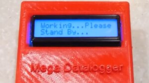

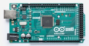

DESIGNING A FIXED EQUIPMENT VITALS ARDUINO MEGALOGGER
The idea of going from every 18 months of human based monitoring to every minute of mega awesome monitoring is an easy sell.  But what good is monitoring if you don't record the data!
Rather than just use this in my office, I'd also like to have the gateway mobile as well.  So, when powering the Emerson 1410 Gateway with a practical amount of batteries, I got about 7 days.  So that is my Project 14 challenge - make a datalogger of 24 sensors logging data every one minute that could run without mains power or human intervention for 7 days with no wires.
Looking at the Arduino Mega, an SD/Ethernet Shield, a Real Time Clock, the math worked out:
A Spreadsheet to Estimate How Often The Datalogger Would Need Attention
One could get 1002 days of data every minute for 24 sensors and 2004 days with 12 sensors.  Also, using the Real Time Clock approach to shut off the Arduino in between datalogs, one could get 18 days of run time versus just 7.  With just a couple more 12V batteries in the suitcase, one could basically only have to check on it twice a month.  Now we're talking true ad hoc freaky, intense fixed equipment vital health MEGA monitoring!
Of course, one could acquire a control system datalogger at the expense of 5 figures of costs and services - but then I wouldn't be able to present this Project 14 Maker Remote Logging challenge solution, would I? image

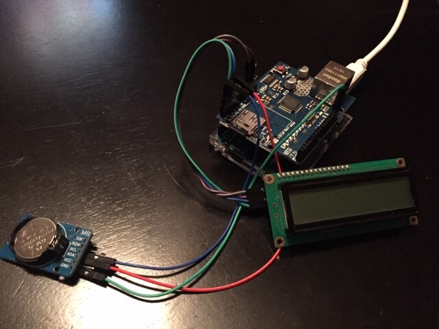

THE ARDUINO MEGA DATALOGGER SOLUTION
I first prototyped my solution with an Arduino Uno.  I found an existing Arduino library that handled all the heavy lifting of communicating using ModbusRegistered using TCP/IP.  I used a common shield (W5100) to handle the SD card logging, ethernet communication, and a Real Time Clock triggering a MOSFET to provide a deep sleep cycle.
Left to Right:  DS3231 Realtime Clock, Arduino UNO with W5100 SD/Ethernet Shield, 2x16 LCD Screen
Here was the code used in prototyping:

As you can see, there is a lot of code and libraries.  I surpassed the UNO dynamic (RAM) memory.  The UNO couldn't handle the load of an LCD, SD card, ethernet port, and Real Time Clock all under one board.  In my 8 years of using Arduino, I finally had a project that outgrew it!
So, based on the math above...and the overall RAM I needed for my code to pull it off, I selected an Arduino Mega 2560 Rev 3 to pull it off.
Arduino Mega 2560:  Selected it for its Low Power and High RAM to handle all my code
Using the Arduino, I can hit a Modbus controller of any brand through the gateway's TCP/IP port to read the current values of its registers. All I need to know is the slave id (typically 1) and the address of the registers I want to read.
You may think, how do you know you don't have bad data coming in?  Well, they thought of that all the way back in 1979 when they developed the ModbusRegistered protocol.  At the end of its bit packet is a checksum.  If the prior bits don't sum up to the checksum value, we trap and handle it.  So far, I've never lost a bit.
After uploading the code to the Mega and adjusting for my particular registers and SD write timing, I powered it by batteries and achieved the goal of 1 week datalogging.

Fully Assembled Arduino Mega Datalogger
Running the Code

    Good explanation of the problem and the background information. The great thing with Rosemount equipment is they can operate in a wide range of temperatures and last for decades because they are so well…
  • Sean_Miller
    Sean_Miller over 7 years ago in reply to mp2100 +4
    Because the network gateway is wireless, it can be 120 feet from the nearest wireless transmitter. One can install multiple wireless transmitters as "wifi" repeaters every 120 ft between the suitcase and…

    This is very interesting! What sensors are you using? How do you measure strain and thinkness?

  • Sean_Miller
    Sean_Miller over 7 years ago in reply to neuromodulator
    I do think there is space for competition in remote corrosion monitoring and one could make a better solution than what is on the market.  The prices definitely reflect lack of competition.  The designs appear to be in their "first gen" look and feel.
    As for solving the corrosion issue - there definitely is an entire industry around living with it:
    • Universities sell Material Science BS and Masters degrees for it
    • Third Party Corrosion Control companies such as Nalco exist to sample chemistry and sell/operate additives that inhibit corrosion
    • Companies make probes that corrode and measure the rate in the process stream (I never recommend them)
    • Companies have NDE technicans to detect thinning of pipe and vessels
    • Engineers like me manage around it
    • Craftsman repair it.
    • etc.
    Depending on your culture in the industry, you may focus on handling it, or you may have long ago gone to alloys that are compatible.  The Chemical Industry tends to "alloy up" and it not be as much of a concern.
    For other materials, Plastic can't hold up to the longevity needed.  There are vessels from the 40's still around.  Plastic tends to embrittle in 10 years and not be applied in pressures greater than 80psi.  There are processes that operate at 2000psi and even 10000psi such as Tyvek.
    For fiberglass, its strips of material can start delaminating.  Often a new tank is internally inspected within its first year just to make sure compatibility with the process.
    Cost drives the metal choice as well.  For example, its cheaper to epoxy coat a carbon steel tank every six years than make it out of Hastelloy once.
    The bummer with many solutions is that there are conditions that one can create a cracking mechanism such as if the process is taken down too quickly or chlorides are introduced.  So, you can't totally get away from inspection.
    However, those companies that still have carbon steel and require chemical treatment need to "alloy up" if they want to reduce the entourage of services required to keep it in the pipes.
