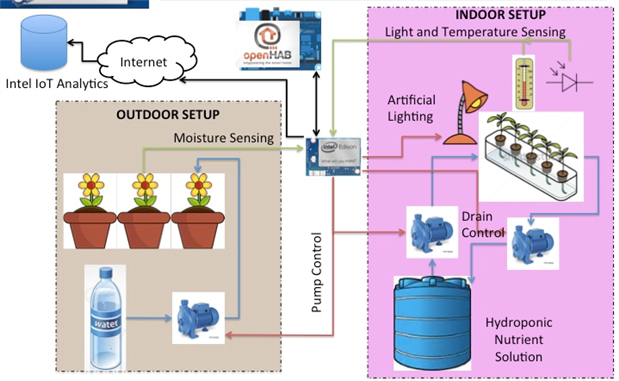

Block Diagram
This is where things get interesting.
The diagram shows there are two sub setups which are explained as follows:
The outdoor setup.

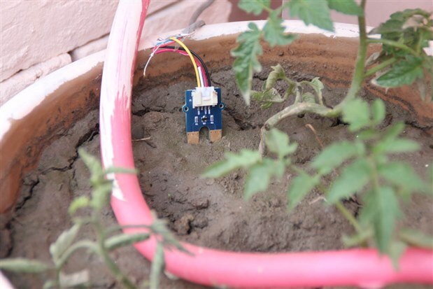

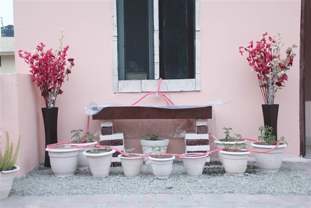

The outdoor setup consists of a soil based configuration for growing plants. We have chosen large pots with soil and fertiliser and these are placed outside in the sun. A water reservoir has a pump that can be switch on and off using the intel Edison and we also have a moisture sensor to detect the condition of the soil.
The Indoor setup.

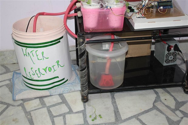

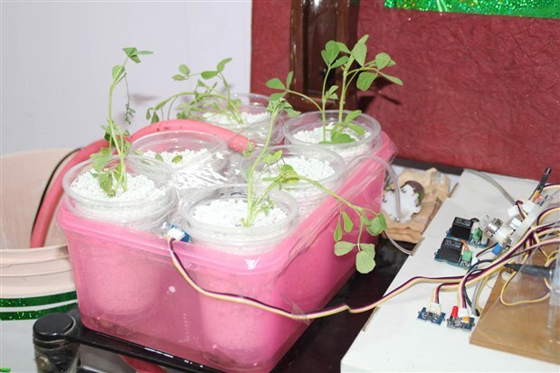

The indoor setup consists of a hydroponic setup with a nutrient solution tank, a flooding pump to fill the hydroponic tray, a drain pump to empty it. We also have a artificial lighting lamp with a UV light as well for indoor lighting and sensors to detect the correct operation with a light and temperature sensor. The Flood tray also as water sensors to detect incomplete filling of the tray indicating insufficient water or a defective water pump.
In addition to these, we have the Intel Edison with the SeeedStudios grove sensors which is connected to a local Intel Galileo. This Galileo hosts an existing home automation setup using OpenHAB. It is also connected to the internet via the local network and Wifi and talks directly to the Intel Analytics Cloud to log and graph data.
The Intel Edison runs a Node.js script that initialises the peripherals, drives the sensors and actuators, converts the data into human readable form and exposes an API to remotely control everything. Essentially, the Node.js script subscribes to an MQTT broker on a particular topic and waits for commands. There are some low level tasks taken care of as well such as making sure nothing overflows etc but the API is used to get and put data from the Intel Edison. In addition to this, there are dedicated sub tasks to post sensor data periodically to the Intel IoT Analytics Cloud. Hence the cloud analytics section can function independently of any control.
The sensor data is also retrieved by OpenHAB which has a set of rules that are used to control the system. The logic part as well as the GUI is created using OpenHAB running on the Intel Galileo. A local version of the data is also captured in a MongoDB for creating graphs etc.

Outdoor setup: Veggies in large pots with sensors and a water hose with cuts
SOIL MOISTURE SENSOR : ()
Hydroponics setup: Indoor hydroponics setup with some DIY stuff
Plants in a tub for hydroponic infusion with sensors

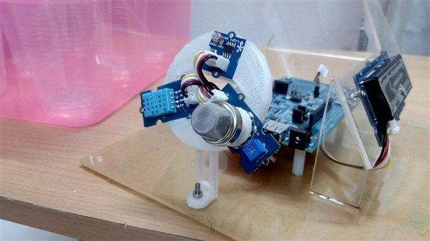

Indoor sensor : ()
