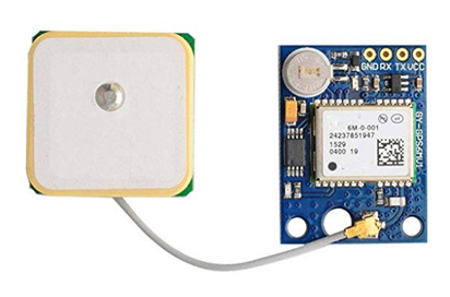

GPS Module
The GPS that I am using is a Neo-6M board with a ceramic antenna.
The module communicates with the MKR 1300 via a UART so the connections are just 4 wires: 3.3V, Gnd, Tx and Rx.

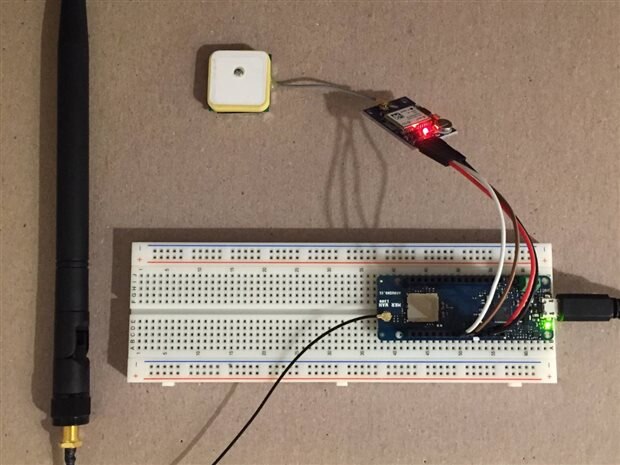

Test Setup
Here is my test setup.  The breadboard is just used to physically anchor the MKR 1300 so it doesn't get pulled around by the USB cable.

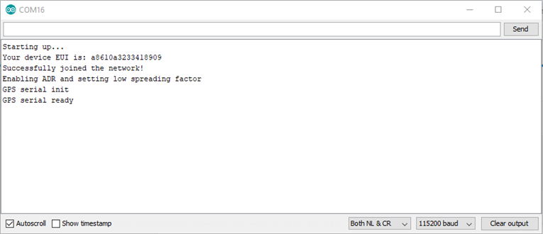

Initially nothing seemed to be working.  The MKR 1300 would not connect to the TTN network.  I finally figured out that I had to reset the MKR 1300 twice and then let the LoRa modem try multiple times to get a reliable connection to the gateway.  I'm not sure about resetting twice, but it appears that multiple connect tries are required because of the frequency (channel) hopping of the Things gateway.  I think it is a synchronization problem because when it does not connect it registers a very low signal strength (less than -110dBm).  I can get a good signal strength on the same channel on a later pass (about -45dBm for my current test setup).
With some software tweaks (and a double reset), I can consistently connect to TTN.

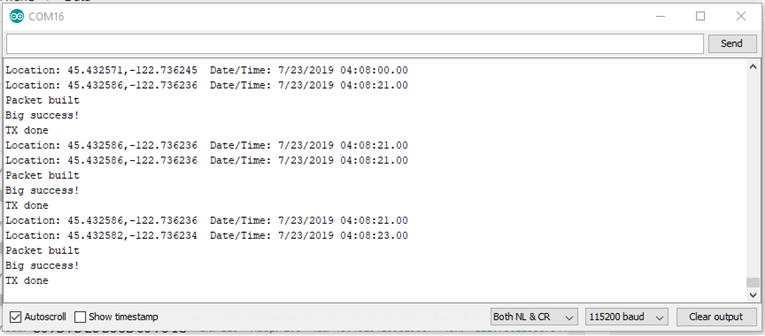

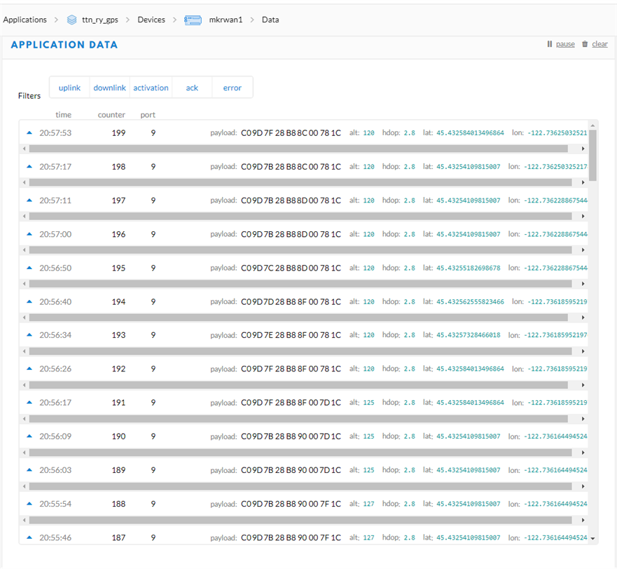

However, I was not getting any GPS data.  I waited for an hour with no success, moving the device location periodically.  I gave up for the night and the next morning I was happily surprised with location data spewing forth.  It turns out that TinyGPS library requires acquiring 4 satellites before sending GPS data (this requirement is needed to determine altitude).
And the data arrives successfully in the TTN console:

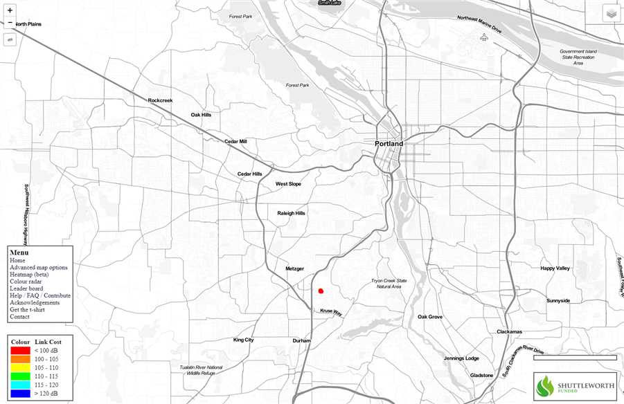

TTN Mapper

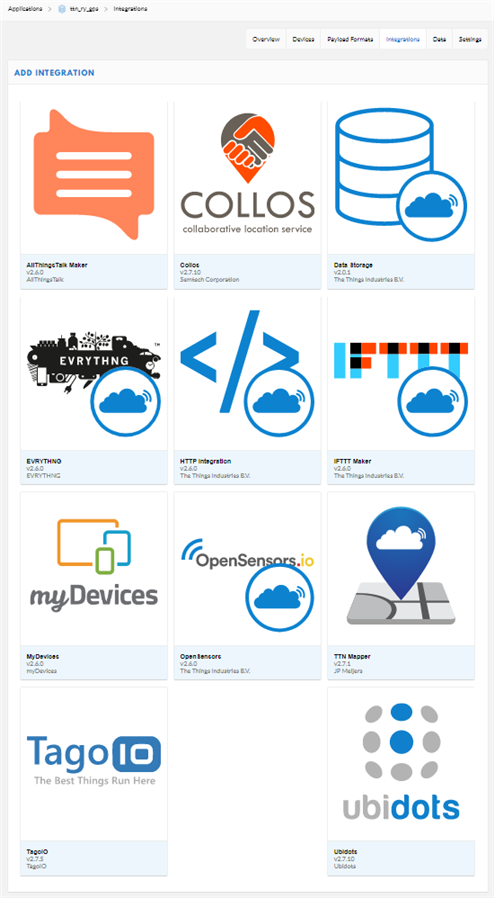

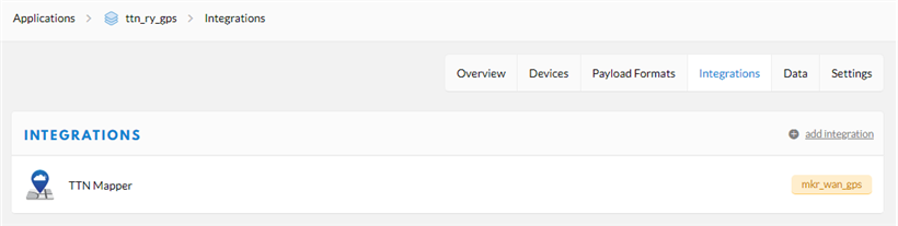

JP Meijers has written a TTN Mapper integration and a payload decoder to format the received data.  Integrations are programs that tie your TTN device to other applications or even external platforms like AWS, Azure, or Watson.  Here is a sample of available integrations.  I'll be using TTN Mapper to plot my GPS data, but I can already think of uses for IFTTT.
You just need to add the integration to your application.  In this instance my application is ttn_ry_gps and the process id for my device is mkr_wan_gps.

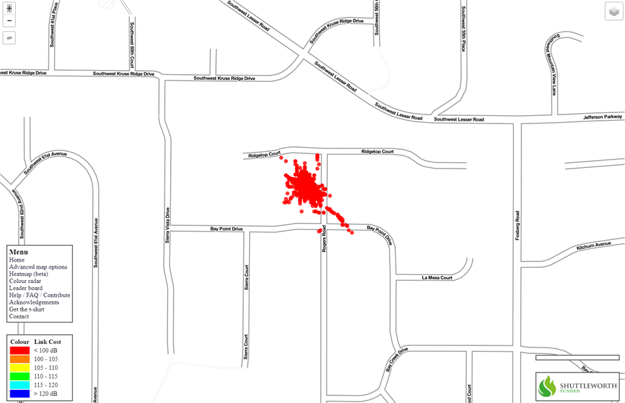

Device on TTN Map:
Zoomed in:
The one bothersome thing about this data is that while the average location is correct, the outliers in the data are 40-60 meters out.  I'll need to investigate what's going on.  I suspect I may be losing satellites periodically.  Hopefully the GPS performance will be substantially better outdoors.
