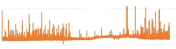

FIELD RESULTS
The data was absolutely useful.  I stripped it down for academic discussion of the trend without giving units, scale, or time.  You'll have to do it on your own if you want all that or join my team.  :-)
Academic Version of the Data
A few observations:
  • Due to the dusty environment, many readings showed error.  However, the error couldn't be more convenient in that it rarely can error lower than the actual distance.  This is because when it fails, its because the fastest path for the sound to get back was obstructed and a relfection (which is a longer path back) was recorded instead.  In turn, I just need to look at the bottom of the data.  It is a great smooth trend following process physical conditions of the drum showing healthy movement in a safe range.
  • The bottom trend against temperature of the process (not on this graph) can tell you if you have an unhealthy mechanical stop.  Stoving up the bottom of the drum can lead to cracks on the drum skirt that pins it down to the building structure.  If that were the case, my next step would be to inspect the large can and its buddies to ensure they are not gagged or at their max compression in the cold empty state.
