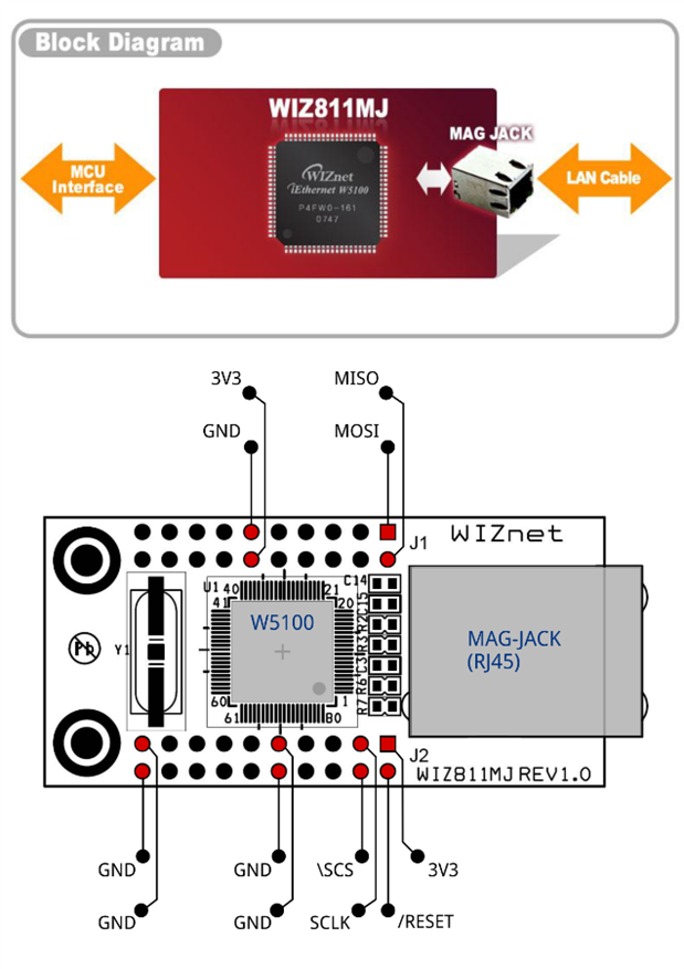

The Wiznet (WIZ811MJ) Ethernet Module
The WIZ8MJ is an Ethernet-based network module consisting of a W5100 (TCP/IP hardwired chip , include PHY ) and MAG JACK JACK (RJ45 with X’FMR) with MCU interface logic (MCU bus Interface and/or SPI Interface). The nice thing about this module is that it is powered with 3.3V but the pins are 5V tolerant.
