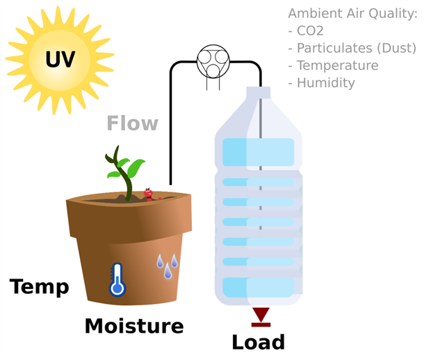

Metaphorically speaking the title refers to an idea. It relates to an idea that helped solve my total ineptness at looking after plants.
It all started about 5 years ago when a colleague brought in a large plant to the office and assured me that this plant was rather robust and did not require much looking after but could I look after it anyway. Needless to say, after a good while of total neglect in the corner it did look rather sad and this prompted immediate ideation to try and resolve this problem.
What this required was an automated means to monitor the vital signs, such as soil moisture and amount of sunlight as well as other secondary signals, which may cause the plant to require more or less water, such as temperature. Other aspects related to plant health such as soil nutrients were deemed too difficult to measure with sensors and so were ignored. Then I needed a means to water the plant automatically if the vital signs dropped below optimum levels. As all this was rather new to me, and nothing was found online that defined exactly what the optimum levels were, I adopted a more stochastic approach by applying fuzzy logic to determine when to water and by how much.
And so the fuzzy plant watering system was born.

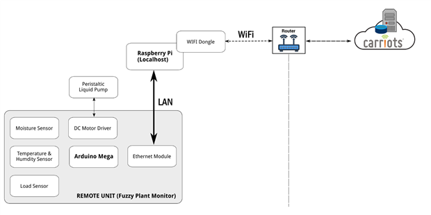

Also back in 2014 I had just purchased my first Raspberry Pi, so to learn the ropes I decided to incorporate this into the mix to act as my local server for data capture and local access (not quite Edge Computing, but close). It was also possible to then connect the RPI to the Internet with the help of a much cheaper WIFI USB dongle, which you would typically use with your laptop, for example (as shown in picture on the right - source TP-LInk).
I then was able to also send data to the cloud for remote storage. At the time I used the Carriots IoT Platform – which is now called the Altair Smartcore platform (https://www.altair.com/newsdetail/?news_id=11375), as it was free to use back then.
The network topology looked as follows:
Let me let now walk through each of the main component blocks.

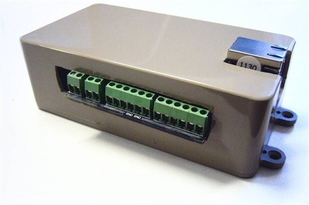

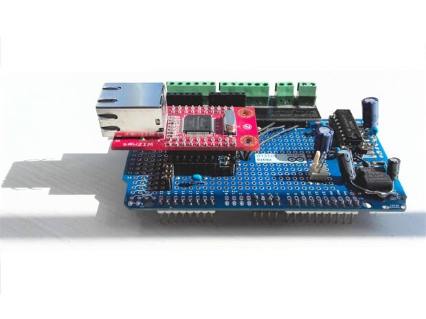

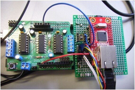

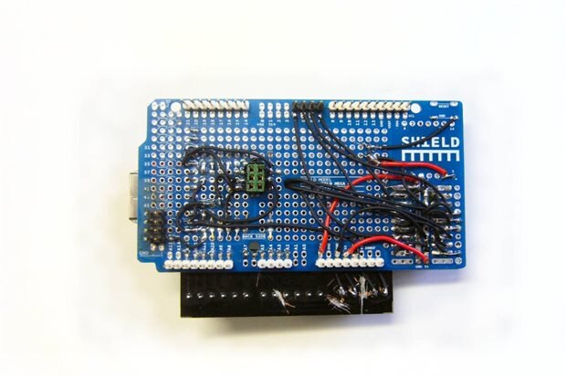

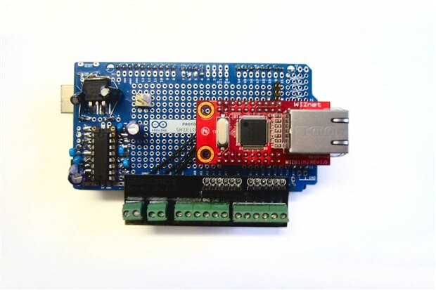

The Remote Unit (Fuzzy Plant Monitor)
{gallery:autoplay=false} Fuzzy Plant Monitor

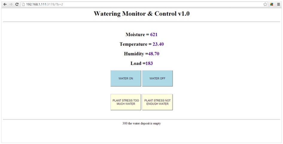

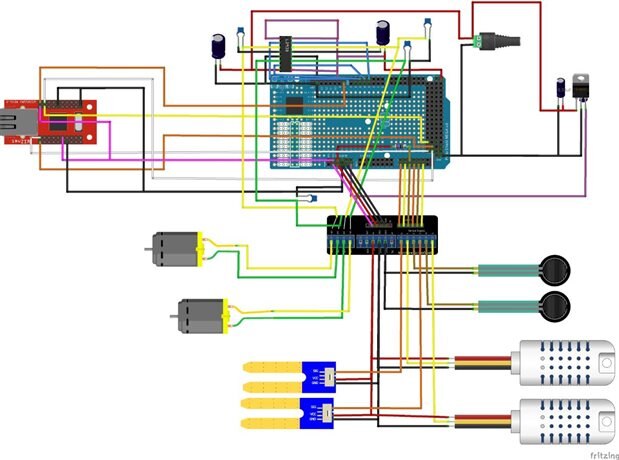

Then as the Arduino Mega provided plenty of capacity the design also allowed for two pot plants to be monitored and controlled from the same remote unit.
Let me now delve a bit deeper into some of the different modules and sensors used.

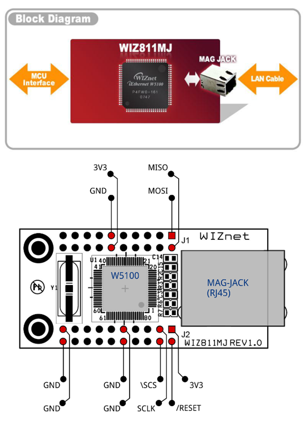

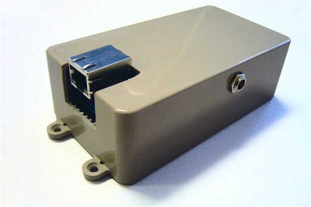

The Wiznet (WIZ811MJ) Ethernet Module
The WIZ8MJ is an Ethernet-based network module consisting of a W5100 (TCP/IP hardwired chip , include PHY ) and MAG JACK JACK (RJ45 with X’FMR) with MCU interface logic (MCU bus Interface and/or SPI Interface). The nice thing about this module is that it is powered with 3.3V but the pins are 5V tolerant.

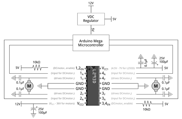

The L293D DC Motor driver
If I remember the TI L293D was used, simply because it was on an Arduino Motor shield from Adafruit, which was used to initially test the peristaltic liquid pumps. It also happens to be a great chip to drive two DC motors offering up to 600mA per channel (1.2A peak).
The DC Motor circuit that was used on the Arduino Mega shield was a copy from the motor shield as follows:

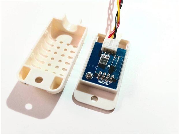

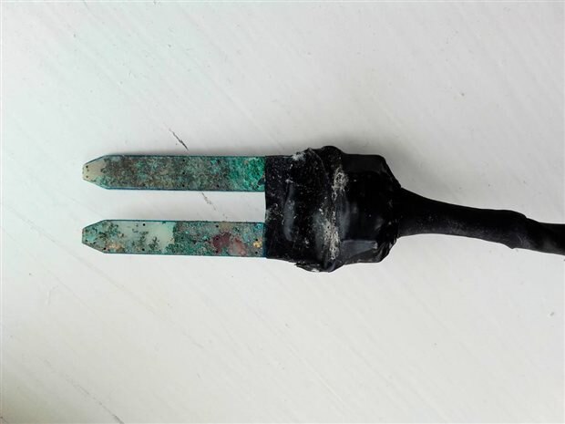

The Sensors
The sensors used included:

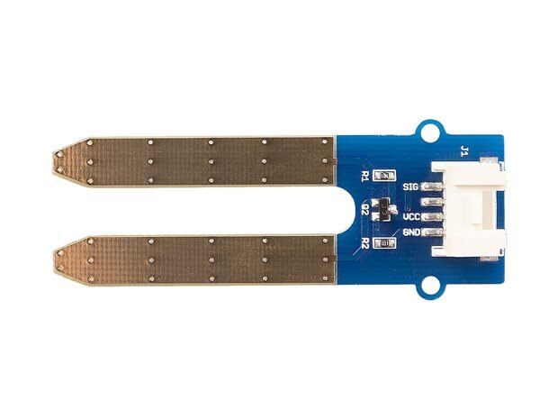

  • Grove Moisture sensor from SeeedStudio - this sensor consists of two probes, which allows current to pass through the soil and a resistance value can be measured that then correlates with soil moisture content. Unfortunately these sensors a prone to corrosion.

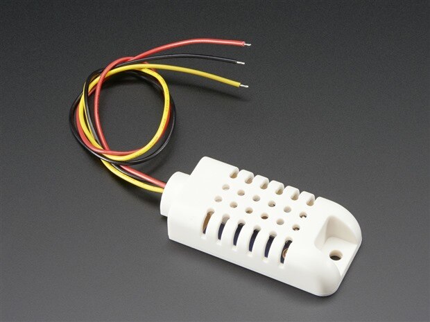

  • AM2302 (wired DHT22) temperature-humidity sensor from Adafruit - this sensor uses a capacitive humidity sensor and a thermistor to measure ambient conditions, and then spits out a digital signal on the data pin.

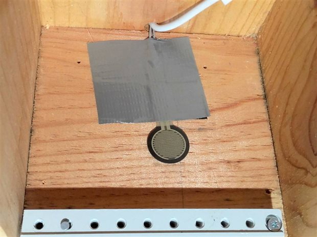

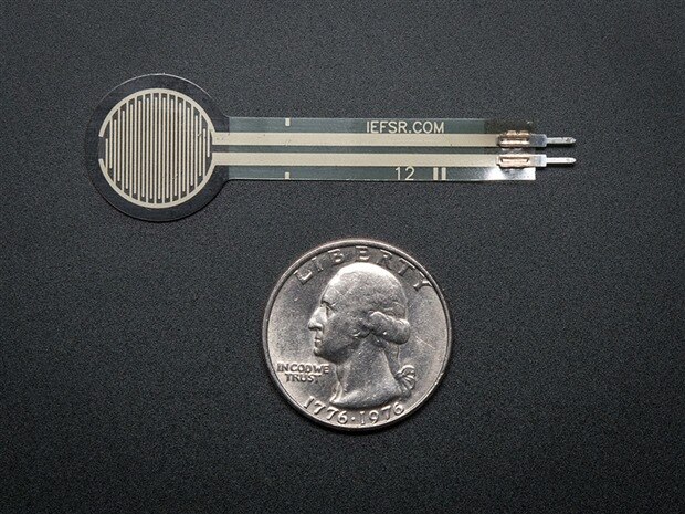

  • Round Force-Sensitive Resistor (FSR) - Interlink 402 from Adafruit - this sensor is basically a resistor that changes its resistive value depending on how hard its pressed.

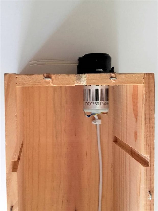

The Water Pump
To water the plants a 12VDC Peristaltic Liquid Pump, from Adafruit.com, was used. This type of DC motor was chosen as it could drip feed a pot plant (according to spec, the flow rate is up to 100 mL/min) and thus unlikely to cause a flood in the office if something went wrong. The pump also came with silicon tubing which was needed for this project.
At the time (as in back in 2014) only a 12V DC version was available. I see that you can now purchase a 5V to 6V version which would make powering the system a little easier.
source: https://www.adafruit.com/product/1150

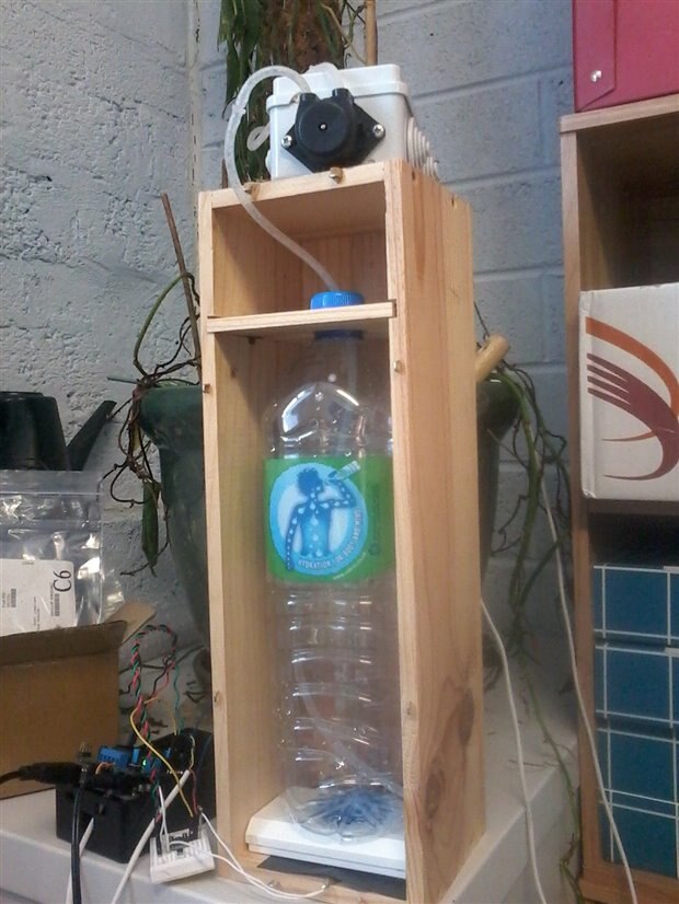

For the initial prototype, I mounted the motor in a separate enclosure:
But, this enclosure seemed superfluous to requirements and so the motor was mounted directly on the wooden box.

For the moisture sensor, we applied the values given to us by SeeedStudio to get us started as the fuzzy logic then applied its own rules as the real data became available, namely:
  • DRY Soil: 0 - 300 as analog reading
  • WET Soil: 300 - 700 as analog reading
  • IN WATER: 700-950 as analog reading
As the Force Sensing (load) Resistance sensor was used to determine if the water bottle was empty we simply applied an analog threshold value. So basically the harder the force, or a full bottle of water, the lower the resistance and therefore the lower the analog input value and when no pressure is being applied to the FSR its resistance will be larger than 1MΩ. This FSR used can sense applied force anywhere in the range of 100g-10kg making it suitable for a 1.5 litre bottle of water, which happens to fit neatly inside the wooden box.

The Local Server (Raspberry Pi) and Cloud (Platform as a Service)
As it was back in 2014, a LAMP stack (Linux Apache MySQL PHP) was installed on the Raspberry Pi (RPI) as that was what I was familiar with, having created my own website etc. There were and still are plenty of online instructions on how to do this. Here's one I found on the raspberrypi.org website.
To access the local server you just typed on your web browser:  192.168.1.200:3178. As this was an office prototype on the office LAN no sign-in was required (wouldn't do that now). Then once you had the webpage open you could water your plant by clicking water on and then clicking water off. The webpage also provided the current moisture level of the soil, the current temperature and humidity, and the level of load of the water bottle that supplies water to the system. There were two additional buttons for adjusting values. If you clicked the "plant stress too much water", the fuzzy parameters changed to water the plant less often by making the moisture threshold levels for the plant lower. If the "plant stress not enough water" was clicked then the fuzzy parameters changed to water the plant longer to match a higher moisture level.
To be honest, if I wanted to use a RPI again as a local server (my next version does away with a local server - reasons explained in next blog) and would probably use Node-Red instead.
As mentioned earlier, a cloud Platform as a Service (PaaS) was also used to allow remote storage of data. Basically, the RPI acted as a bridge and sent the data it received to the cloud service using a JSON structured payload. From the Carriots dashboard you were then able to extract the data and you could view whether the RPI was online (connected) or not.

    Thanks for the tips, especially about the voltages.
    Yes, I plan to use capacitive moisture sensors as these are now commonly available.
