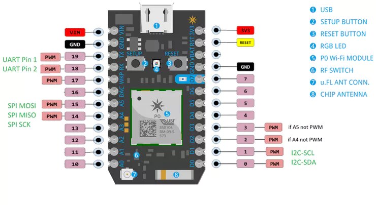

1.Particle Photon
Photon is a popular IOT board available from the Particle platform. The board houses STM32F205 120Mhz ARM Cortex M3 microcontroller and has 1 MB flash memory, 128 Kb RAM and 18 mixed signal general purpose input output (GPIO) pins with advanced peripherals. The module has on-board Cypress BCM43362 Wi-Fi chip for Wi-Fi connectivity and Single band 2.4GHz IEEE 802.11b/g/n for Bluetooth. The board comes equipped with 2 SPI, one I2S, one I2C, one CAN and one USB interface.
It should be noted that 3V3 is a filtered output used for analog sensors. This pin is the output of the on-board regulator and is internally connected to the VDD of the Wi-Fi module. When powering the Photon via VIN or the USB port, this pin will output a voltage of 3.3VDC. This pin can also be used to power the Photon directly (max input 3.3VDC). When used as an output, the max load on 3V3 is 100mA. The PWM signals have a resolution of 8-bit and run on a frequency of 500 Hz.
Pin Diagram
Pin Description

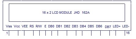

2. 16X2 Character LCD
The JHD162A LCD module has 16 pins and can be operated in 4-bit mode or 8-bit mode.
  • Ground pin of the LCD module.
  • Pin2(Vcc) ==> Power to LCD module (+5V supply is given to this pin)
  • Pin3(VEE) ==> Contrast adjustment pin. This is done by connecting the ends of a 10K potentimeter to +5V and ground and then connecting the slider pin to the VEE pin. The voltage at the VEE pin defines the contrast. The normal setting is between 0.4 and 0.9V.
  • Pin4(RS) ==> Register select pin.The JHD162A has two registers namely command register and data register. Logic HIGH at RS pin selects data register and logic LOW at RS pin selects command register. If we make the RS pin HIGH and feed an input to the data lines (DB0 to DB7), this input will be treated as data to display on LCD screen. If we make the RS pin LOW and feed an input to the data lines, then this will be treated as a command ( a command to be written to LCD controller – like positioning cursor or clear screen or scroll).
  • Pin5(R/W) ==> Read/Write modes. This pin is used for selecting between read and write modes. Logic HIGH at this pin activates read mode and logic LOW at this pin activates write mode.
  • Pin6(E) ==> This pin is meant for enabling the LCD module. A HIGH to LOW signal at this pin will enable the module.
  • Pin7(DB0) to Pin14(DB7) ==> These are data pins. The commands and data are fed to the LCD module though these pins.
  • Pin15(LED+) ==> Anode of the back light LED. When operated on 5V, a 560 ohm resistor should be connected in series to this pin. In arduino based projects the back light LED can be powered from the 3.3V source on the arduino board.
  • Pin16(LED-) ==> Cathode of the back light LED.

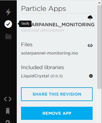

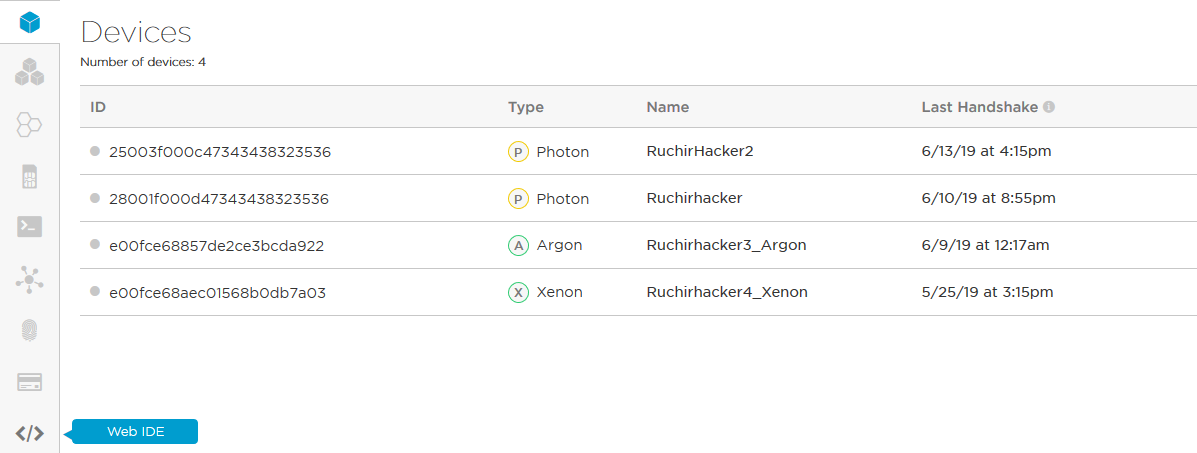

Web IDE

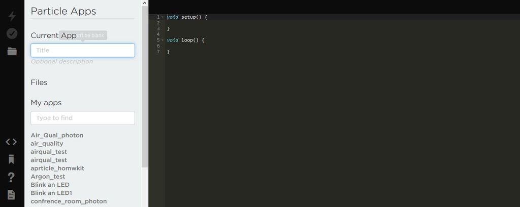

Particle Build is an Integrated Development Environment, or IDE that means that you can do software development in an easy-to-use application, which just so happens to run in your web browser.
  • To open build, login to your particle account and then click on build as shown in image.

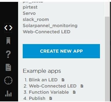

  • Once you clicked you will see console like this.
  • To create a new create app, click on create new app.

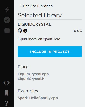

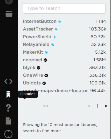

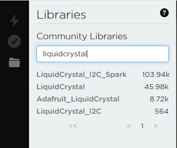

  • To include library in program, go to libraries section.
  • And search for liquidcrystal.

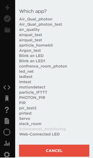

  • Select an app in which you want to add library. In my case it is solarpanelmonitoring.
  • To verify the program. Click on verify.

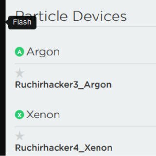

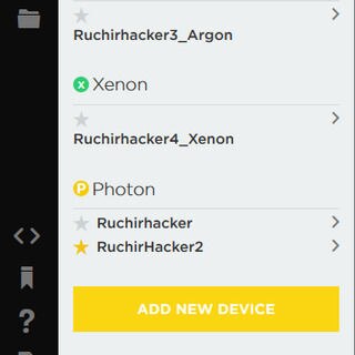

  • To upload the code, click on flash but before doing that select a device.If you have more than one device you have to make sure that you have selected which of your devices to flash code to. Click on the "Devices" icon at the bottom left side of the navigation pane, then when you hover over device name the star will appear on the left. Click on it to set the device you had like to update (it won't be visible if you have only one device). Once you have selected a device, the star associated with it will turn yellow. (If you only have one device, there is no need to select it, you can continue.

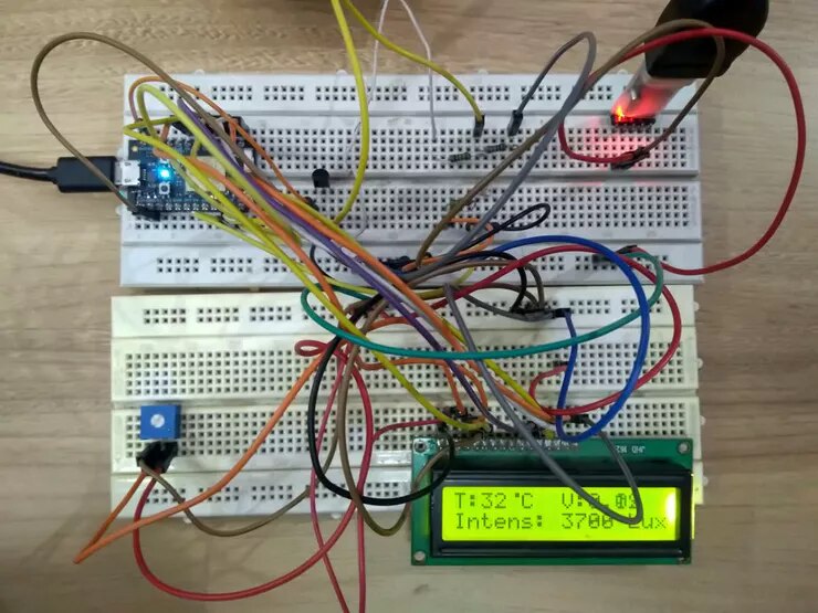

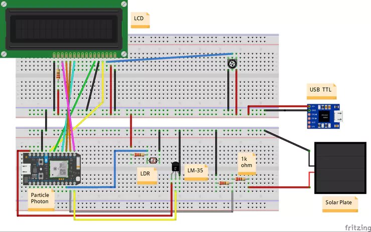

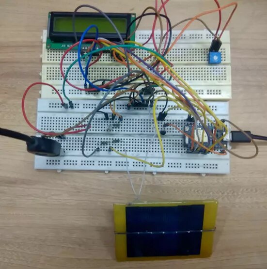

How the circuit works
In the circuit, 6 GPIO pins of the module are used to interface the character LCD and three analog input pins are used to interface LM-35 temperature sensor, Solar Panel and the LDR sensor.
Once the circuit is assembled, it is ready to deploy along with the solar panel. While the solar panel keeps generating electricity, the attached to the device. The device is powered from the mains supply that is managing the other performance enhance equipment as well. Once the device is powered on, some initial messages are flashed on its LCD display indicating the intent of the application. The power output of the panel, temperature and the incident light intensity are measured by the Voltage Output pin of the solar panel, LM-35 temperature sensor and the LDR sensor respectively. The Voltage Output pin of the solar panel, LM-35 temperature sensor and the LDR sensor are connected to the analog input pins A1, A0 and A2 of the Particle Photon.
The respective parameters are measured by sensing the analog voltage at the respective pins. The analog voltage sensed at the respective pins is converted to digital values using in-built ADC channels. The Particle Photon has 12-bit ADC channels. So the digitized values can range from 0 to 4095. Here, it is assumed that the resistive network interfacing LDR sensor with the controller pin is calibrated to indicate light intensity by direct proportionality.
The LM-35 IC does not require any external calibration or trimming to provide typical accuracies of ±0.25 °C at room temperature and ±0.75 °C over temperature range from −55 °C to 150 °C. Under normal conditions, the temperature measured by the sensor won't exceed or recede the operational range of the sensor. Due to low-output impedance, linear output, and precise inherent calibration of the LM-35, the interfacing of the sensor to a control circuitry is easy. As the LM-35 device draws only 60 uA from the supply, it has very low self-heating of less than 0.1 °C in still air. Typically in the temperature range from −55 °C to 150 °C, the voltage output of the sensor increases by 10 mV per degree Celsius. The voltage output of the sensor is given by the following formula.
                                                            Vout = 10 mV/°C*T
where,
Vout = Voltage output of the sensor
T = Temperature in degree Celsius
                                                             T (in °C) = Vout/10 mV
                                                             T (in °C) = Vout(in V)*100
If VDD is assumed to be 3.3 V, the analog reading is related to the sensed voltage over 12-bit range by the following formula.
                                                             Vout = (3.3/4095)*Analog-Reading
So, the temperature in degree Celsius can be given by the following formulae.
                                                             T (in °C) = (3.3/4095)*Analog-Reading *100
The voltage output of the solar panel should be typically 3 V which can be directly sensed by the Particle Photon. The Particle photon can directly sense voltage up to 3.3 V. For digitization of the sensed analog voltage, it is again internally referenced to the VDD. The digitized voltage reading is scaled over the 12-bit range i.e. 0 to 4095.
The sensor data is first displayed on the LCD display and then is passed to the Particle Cloud via Wi-Fi connection. The user needs to login into the Particle registered account in order to view the read sensor values. The platform allows connecting to a board from the registered account. The user can monitor received sensor data in real time and can also log data.
Connections
Photon ==> LCD
D6 ==> RS
D5 ==> Enable
D3 ==> DB4
D2 ==> DB5
D1 ==> DB6
D0 ==> DB7
Photon ==> LM-35
A0 ==> Aout
Photon ==> LDR
A2 ==> Vcc
Photon ==> Solar plate
A1 ==> Vcc
GND ==>GND
Note:- USB TTL is used to provide 5V to the LCD and LDR
