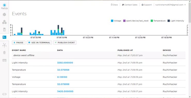

How the circuit works
In the circuit, 6 GPIO pins of the module are used to interface the character LCD and three analog input pins are used to interface LM-35 temperature sensor, Solar Panel and the LDR sensor.
Once the circuit is assembled, it is ready to deploy along with the solar panel. While the solar panel keeps generating electricity, the attached to the device. The device is powered from the mains supply that is managing the other performance enhance equipment as well. Once the device is powered on, some initial messages are flashed on its LCD display indicating the intent of the application. The power output of the panel, temperature and the incident light intensity are measured by the Voltage Output pin of the solar panel, LM-35 temperature sensor and the LDR sensor respectively. The Voltage Output pin of the solar panel, LM-35 temperature sensor and the LDR sensor are connected to the analog input pins A1, A0 and A2 of the Particle Photon.
The respective parameters are measured by sensing the analog voltage at the respective pins. The analog voltage sensed at the respective pins is converted to digital values using in-built ADC channels. The Particle Photon has 12-bit ADC channels. So the digitized values can range from 0 to 4095. Here, it is assumed that the resistive network interfacing LDR sensor with the controller pin is calibrated to indicate light intensity by direct proportionality.
The LM-35 IC does not require any external calibration or trimming to provide typical accuracies of ±0.25 °C at room temperature and ±0.75 °C over temperature range from −55 °C to 150 °C. Under normal conditions, the temperature measured by the sensor won't exceed or recede the operational range of the sensor. Due to low-output impedance, linear output, and precise inherent calibration of the LM-35, the interfacing of the sensor to a control circuitry is easy. As the LM-35 device draws only 60 uA from the supply, it has very low self-heating of less than 0.1 °C in still air. Typically in the temperature range from −55 °C to 150 °C, the voltage output of the sensor increases by 10 mV per degree Celsius. The voltage output of the sensor is given by the following formula.
                                                            Vout = 10 mV/°C*T
where,
Vout = Voltage output of the sensor
T = Temperature in degree Celsius
                                                             T (in °C) = Vout/10 mV
                                                             T (in °C) = Vout(in V)*100
If VDD is assumed to be 3.3 V, the analog reading is related to the sensed voltage over 12-bit range by the following formula.
                                                             Vout = (3.3/4095)*Analog-Reading
So, the temperature in degree Celsius can be given by the following formulae.
                                                             T (in °C) = (3.3/4095)*Analog-Reading *100
The voltage output of the solar panel should be typically 3 V which can be directly sensed by the Particle Photon. The Particle photon can directly sense voltage up to 3.3 V. For digitization of the sensed analog voltage, it is again internally referenced to the VDD. The digitized voltage reading is scaled over the 12-bit range i.e. 0 to 4095.
The sensor data is first displayed on the LCD display and then is passed to the Particle Cloud via Wi-Fi connection. The user needs to login into the Particle registered account in order to view the read sensor values. The platform allows connecting to a board from the registered account. The user can monitor received sensor data in real time and can also log data.
