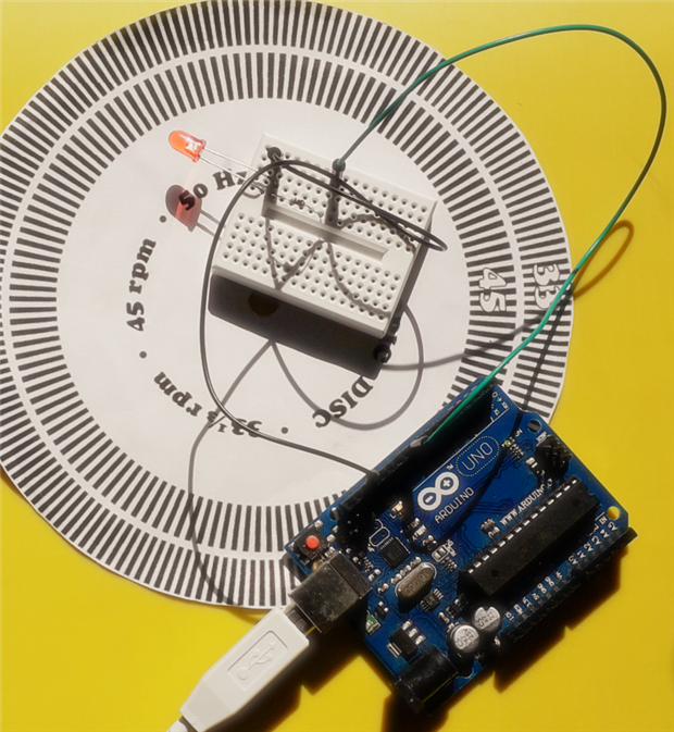

Long intro to say that I made a blinky that blinks 100 times per second image.
2 flavours of the same project: with an Arduino UNO and with a Hercules LaunchPad.

First Project: The Arduino UNO Design
This is very very simple. I tried to stay within the Project14 spirit.
It's in essence the well known Blinky. The version that uses the hardware timer instead of the delay() function.
Here's the sketch:

Pin 9 is used to power the LED. This is because Pin 9 on a UNO is connected to the output of TIMER1.
In the setup(), the pin is set to output, and then the timer is configured.
This sneaks a little bit of advanced controller development in Project14, but it's a good opportunity for yourself to have a look at those hardware timers.
What happens is that in line 10, the timer is configured in simple PWM mode.
In line 11, the 16 MHz I/O clock is divided by the prescaler to slow down the speed a first time.
Then, in line 12, I divide that clock again, by setting the timer's counter. The result is a 100 Hz signal.
Last, in line 13, the duty cycle is set to 50%.
From that moment on the pin 9 starts behaving as we want it. No further config or logic needed. It will do that until the Arduino is powered off.
As a consequence, the loop() does not have to do anything and there's no code needed there.  phoenixcomm  , you will not like this image .
I just let it delay for the maximum time (max unsigned long), at each loop cycle.
Wiring for Arduino
Very simple. An LED with a 330 Ohm resistor between digital 9 and GND.
source: edited https://www.arduino.cc/en/Tutorial/blink
To use it, place the turntable in a location without bright lights. On a normal day, closing the curtains is good enough.
Print and cut out the strobe disk. Place it on the turntable.
Switch it on, and bring the led as close to the strobo disk as you can. I used a little breadboard and long wires.
If your turntable is spinning correctly, the corresponding circle on your strobe disk (or at least the part directly lit by the LED) appears to stand still.
If you have speed control on your turntable, you can now use that to correct the speed until the dots become stable.
