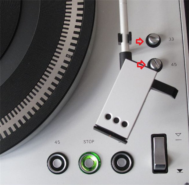

The first fixable thing is that both speed correction dials don't work.
image source: a UK Audio Mart auction
This issue can have different causes. It can be electronic - either the circuit or the potentiometer defect.
More likely, it's a mechanical issue caused by not properly assembling the TT after opening it.
