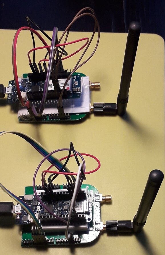

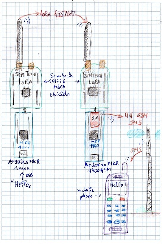

Project Goal: React on receiving a LoRa message and forward it as an SMS.
A transmitter will send LoRa messages on demand.
A receiver will listen for messages and when it picks up a communication, sends the payload as SMS.
Components:
  • 2 SemTech LoRa MBED shields with Antennas
  • 1 Arduino MKR 1040 GSM with Antenna
  • 1 more Arduino MKR 1xxx or any 3V3 model.
  • 16 jumper wires
  • 1 data enabled active SIM card
Scenario
There are two Arduinos with a SemTech LoRa shieldSemTech LoRa shield connected.
One Arduino will be the transmitter, the second one the receiver.
When the transmitter receives a request to send (in my example it gets that request via the USB serial port), it creates a package and beams it out as a LoRa radio signal.
The other Arduino ( the receiver, has to be a MKR 1040 GSMMKR 1040 GSM or another Arduino with a GSM shield) is continuously polling for LoRa traffic.
When it picks up a payload, it sends that data to a predefined telephone number (my mobile phone).

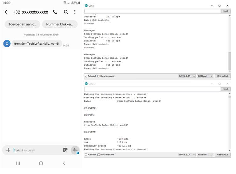

You can see the result in the screen captures below.
The right upper monitor shows the transmitter. I typed "from SemTech LoRa: Hello, world!"
The lower monitor shows that the receiver got the message and forwarded it as an SMS.
My mobile phone on the left has received that payload as a text message.
I've used 434 MHz, antennas need to be matched and mounted on the LF connector of the shields.
If you prefer to use the 868 or 915 band, you just need to change a few parameters in the sketches and mount a matching antenna on the HF connectors.
Connections
The connections you make are identical for sender and receiver.
The table below shows the required links to be made.
The sender does not have to be a specific Arduino type, as long as it's 3V3 version. Don't use an Arduino UNO.
If you choose a non-MKR Arduino, take care that you pass the pins that nSS (nCS), DIO0 and DIO1 are connected to, as parameters to the constructor.

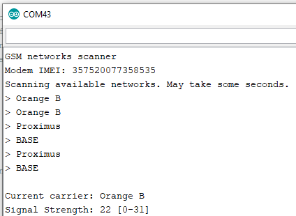

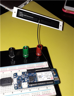

GSM Antenna is Required
Put antennas on the radios and the GSM board, please. Without antenna, the Arduino will behave badly.
Measurements with different antennas from the Molex evaluation kit - all on a scale from 0 no reception to 31 best reception:
  • Without antenna (don't do this at home - bad behaviour):       1
  • With Molex 146185 Cellular Band antenna;                            22
  • With Molex 105263 Cellular 6 Band antenna:                         23
  • With Molex 146220 GPS + WIFI combo                                  23
  • With Molex 146186 GPS + WIFI combo                                  14

    Jan Cumps over 6 years ago
    I got a set of antennas from Project14 &lt;3.
    Here's the reported connection strenght for a GSM connection from Arduino MKR GSM 1400 and my operator:
    image: with Molex 146185 antenna mounted
    Here are some signal strenghty  comparisons - all on a scale from 0 no reception to 31 best reception:
