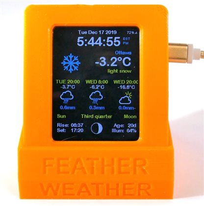

This super cool little project illustrates just how far the maker industry has progressed since the first Uno appeared.
This tiny ESP8266 MCU module has the horsepower to run a QVGA color touchscreen while running a WiFi stack to access the internet and continually parse the JSON (JavaScript Object Notation) data it retrieves. And the whole project can be assembled in about 1 minute. Of course a few parts need to be pre-3D printed and a couple of headers need to be soldered, and some firmware needs to be loaded, but the actual labor involved is astonishingly small, especially given how much infrastructure is being controlled and how sophisticated the application is.
Background
Tariq had sent me a a swag package for being featured on Makevember that included a couple of MCU cards and an invitation to participate in the RF Project14 contest. One of the MCUs was an Adafruit Feather Huzzah which is based on an ESP8266. I'm sure that from element14's point of view and probably most of the membership as well, the best thing we can do with modules provided by element14 is to blog about what we did with them. So this blog is partly to pay homage to element14 for giving us such great modules and reinforce the motivation to keep it up.
This powerful little MCU includes WiFi capability, so I figured why not do an "RF" project with it. I decided to to implement a device to retrieve weather data from the internet and display it continuously, but while researching how to to do this, I came across others who had already done it, including a great project by Daniel Eichorn that used a Huzzah.
I seem to have an obsession with weather stations, I have bought several and I have built several. I just never seem to get all the features I want in one device. Where I live, if you don't dress appropriately for the weather, you could be in for a world of pain. Maybe this build will finally have most of the features I need.
Eventually I came across an Adafruit version of Daniel's project which used a Featherwing TFT display. It included a 3D print file for the case. All this really paid off in simplifying what I needed to do, in fact the only unique creative things I did for this project were to design a nice 3-D printed stand and come up with the Feather Weather name.
There was still some work to do to install all the correct libraries and 3D print all the plastic parts and put it all together, but I ended up with a great little device for the amount of work I had to do. I, and my family, are very happy with the result.
Thanks for the Feather tariq.ahmad and for the prodding to do something with it.

Packaging
Adafruit has designed a 3D printable case for the device - located here:
I printed it on a very coarse setting, which was fairly marginal - it might be worth printing on a bit finer mode.
I also designed a stable stand for the device  - the stl file "feather1.zip" is attached to this blog.

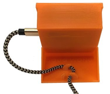

Update
The original case designed by Adafruit was adequate for display, but I needed a case that was sturdy enough to be handled. So I designed one with stiffer (thicker) walls, better circuit board retention and strain relief cable management....
This new case works better in my office application where I expect it will be used as a little display to signify the employee of the week (EOTW). The EOTW selects the next EOTW from a different department.
I also updated the software to add different graphics, text and colors.
Note one of the new stands is named Weather Feather instead of Feather Weather - I haven't decided which I like better.
Here is a picture of the cable management hooks that prevent strain on the USB connector and also prevent the cable from tipping the device over:

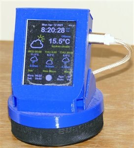

Another Update:
This version uses a puck in the base for more stability....
Note this stand is printed in this orientation with no support, which means the cavity for the puck requires the printer to bridge across 3 inches with no support.
