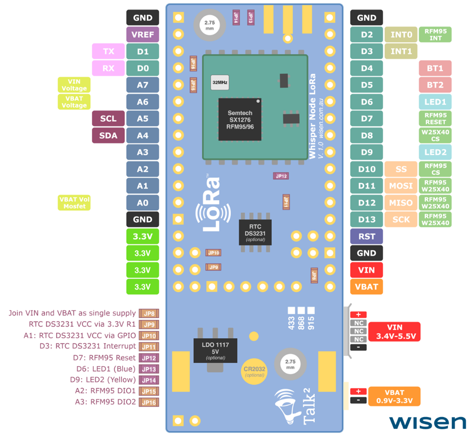

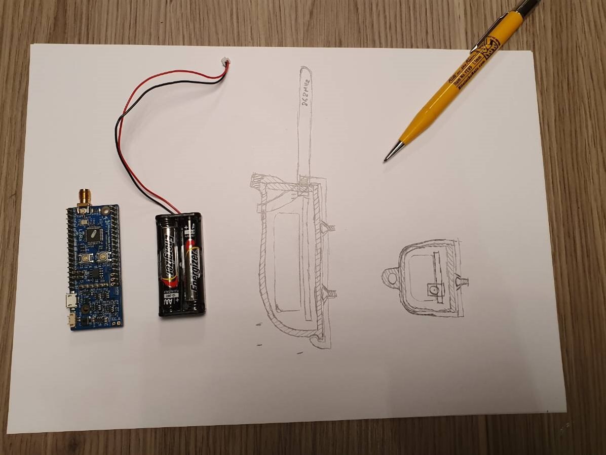

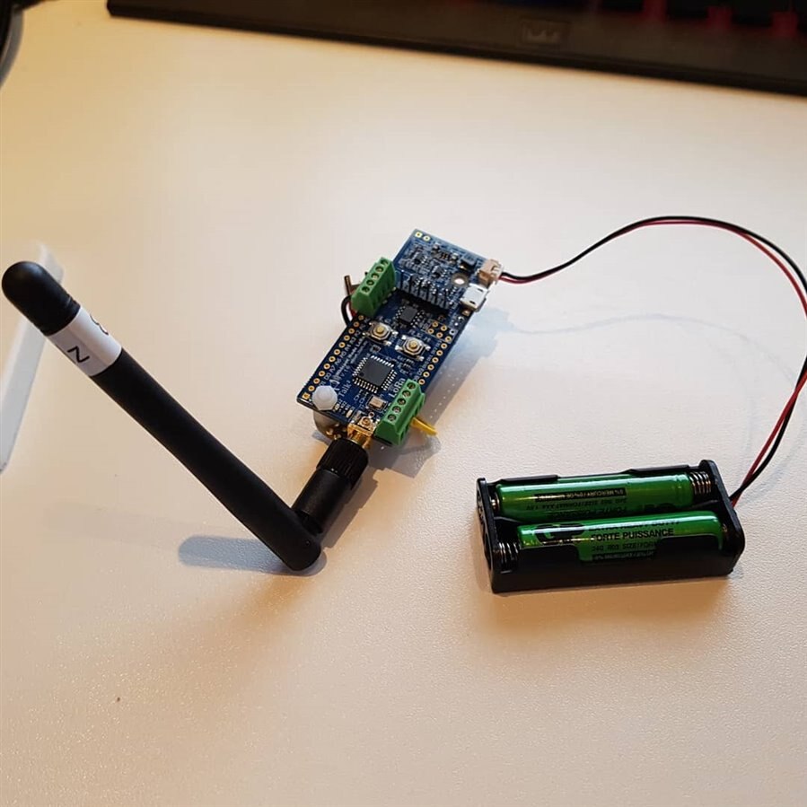

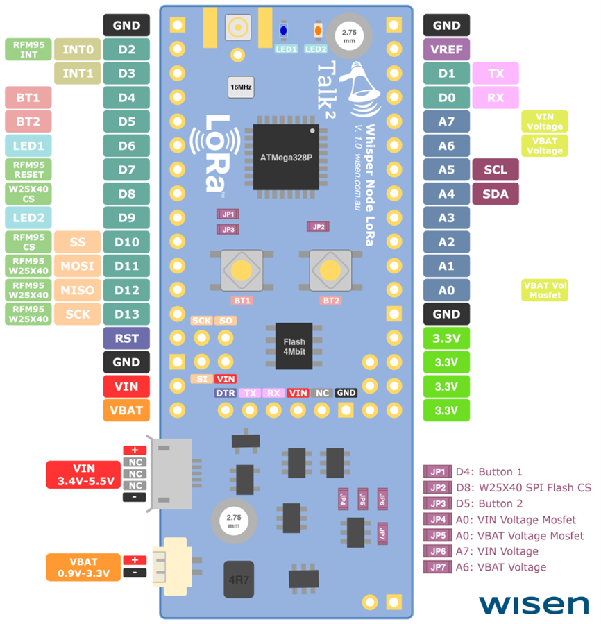

Microcontroller

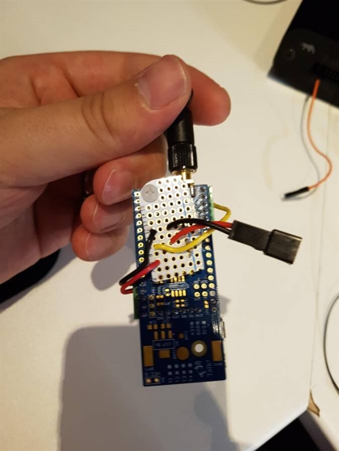

For this project I used the development board Talk2 Whisper Node by Wisen. It is by no means high-tech or small but the components offer the best option for low-power consumption I have tried so far. Featuring a tried and proven Atmel AVR ATMega328p it also features highly efficient step-up regulator and a RFM95/96 LoRa Radio (Semtech SX1276). For board setup in Arduino environment, libraries and excellent documentation go here.
Pinout

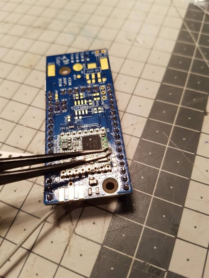

To use it as a LoRaWAN device you need to close jumper 15. This requires some SMD soldering with the supplied zero-ohm link.
I used a Weller SMD tip, but you could probably get away with a much larger tip. The problem arises as you can hardly heat up only one side and the link has a tendency to come off with the soldering iron. I held it in place with a pair of pliers.
3 volt battery supply
For powering the device I have used 2 AAA Energizer batteries. I highly recommend using some quality batteries as the first cheap no-brand set I tested stopped working after having been out in sub-zero temperatures. For an introduction to measuring current consumption in the mA and uA range, please allow the creator of the board Mike Musskopf explain:

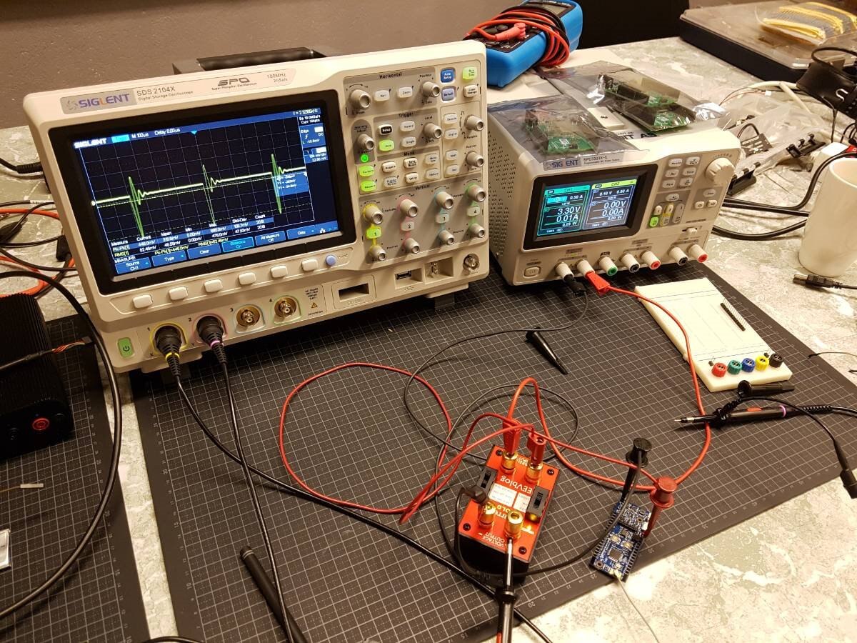

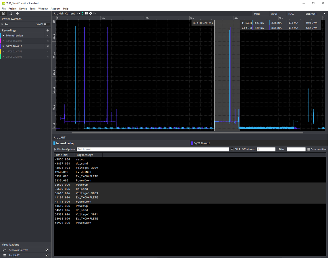

uCurrent Gold and multimeter/oscilloscope
I found using a multimeter for monitoring power consumption a bit coarse, as it was hard to tell what was going on on the MCU at a given point in time. I experimented with combining uCurrent and an oscilloscope. First it was hard to make out the weak signals, and it turned out the step-up regulator was draining what I was looking for in noise. When I bypassed the regulator it worked pretty well. Then only problem now was that I was not measuring the whole system, so I could not trust the results to be representative of real-life operations. The other problem I faced was to display the power consumption alongside serial output, using the scope's serial decoder. This would allow me to know what part of the code was running with simple println's. It worked in theory, but in practice it was hard to scale in any usable manner on the time scale.

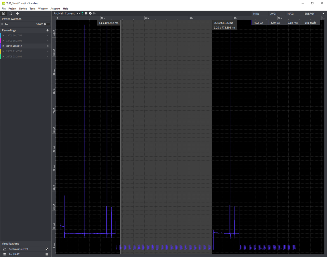

Otii Arc from Qoitech
The Otii Arc combines power supply, ammeter, voltmeter, serial decoder, graphing tools and many more things into one easy to use package. It is even good for nA values.
I have slightly improved power consumption in sleep mode (now average of 8.31uA) and while transmitting by simplifying the circuit and some minor code changes. Using the Otii Arc in this way is a great workflow to take the guesswork out of power optimization. I only wish I could program the board over FTDI with the Arc.
I believe you can download and install the client to view my power profile.

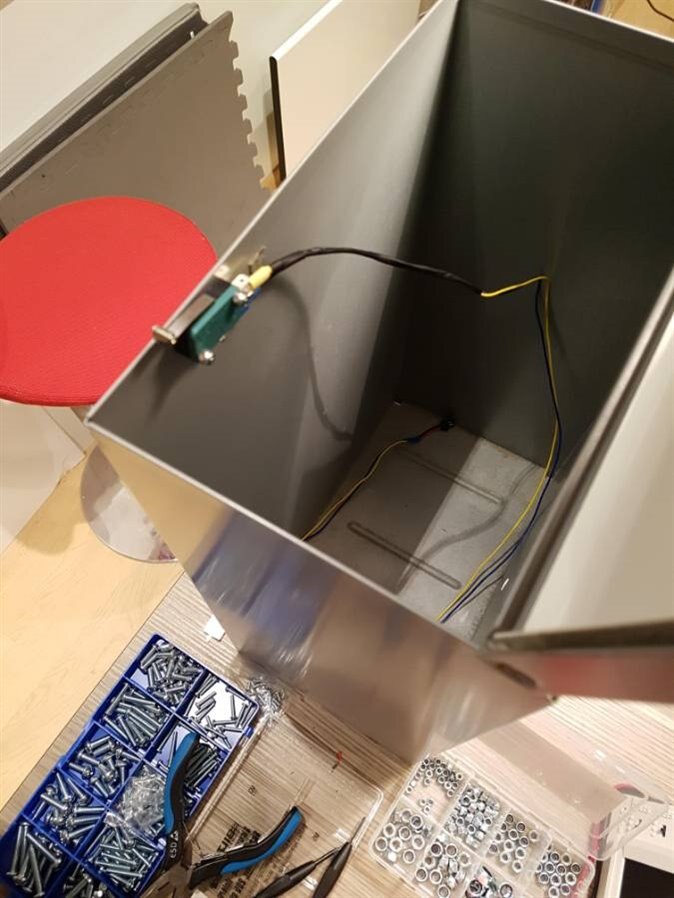

Mechanism
I started this project by creating a mock post box using foam board. This is a great way of quickly prototyping physical mechanisms and gave me room to experiment without losing mail - pluss my kids still play with it! image I made a list of possible mechanisms of detecting if mail had been received. Most solutions were either too power hungry or too fragile, or both:
  • Infrared - power hungry, hard to cover all the space
  • Ultrasonic - same as infrared
  • Weight - too fragile for small pickup notes, would probably get misaligned from dust etc.
  • Camera - forget it
I was left with reed switch and micro switch. My initial experimentation with reed switches proved they would be a bit problematic to mount and to align right.
Micro switch
So a micro switch will not actually tell if you have got mail or not. It can't tell if the post carrier has deposited mail from someone having opened the lid to check. I can only tell you that it has worked well for this application and I am going to keep it. Basically the switch is connected in a Normally Open configuration. When the lid is opened the switch goes to closed (not depressed) and this closes the circuit. The Arduino-compatible microcontroller is sleeping and waiting for a falling edge interrupt. The circuit is connected between an interrupt capable pin (D3) and GND. The pin is pulled up, using built-in resistor.
The following pictures are from when I first experimented with micro switches so it is connected Normally Closed, but the mounting has stayed the same.

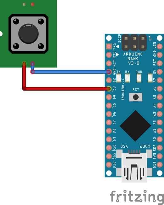

Circuit
For some reason I did not know about the built-in pullup resistors on the MCU, or I didn't understand how to use them. Therefore I made a simple external circuit that did the same. I had used a 10k Ohm resistor, for who knows what reason.
I used the opportunity in this revisit to get rid of this all togheter. Now I only use a digital pin on the board and configure it with 20k Ohm internal pullup. This is connected to GND via wires and the switch.

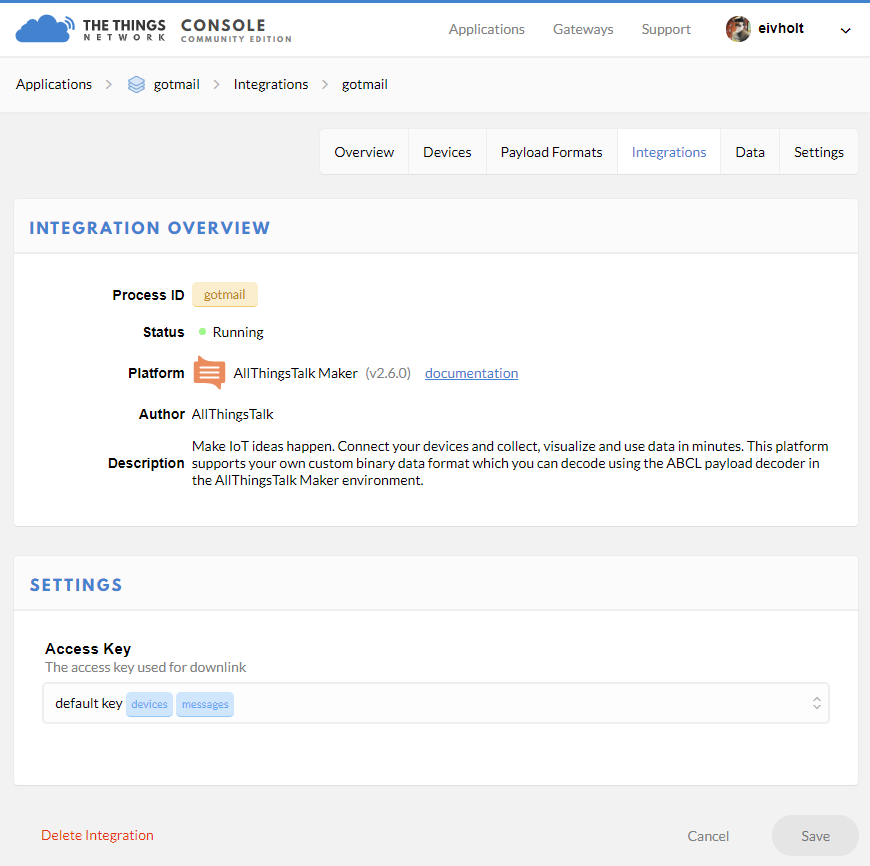

The Things Network
There are many great guides on setting up a TTN application. After registrering a device in the usual manner a custom payload decoder has to be defined to piece together the voltage measurement. Source code.
function Decoder(bytes, port) {
    // Decode an uplink message from a buffer
    // (array) of bytes to an object of fields.
    var decoded = {};
    if (port === 1) decoded.battery = (bytes[0]<<8 | bytes[1]);
    return decoded;
For this project I have experimented with many different integrations. In the end all I needed was a notification on my devices. AllThingsTalk provided this in a pretty simple manner. I refer to the documentation on how to set up the integration and define devices.
A custom decoder has to be defined on the ATT side also, it does exactly the same as the former decoder, but in ABCL. Source code.

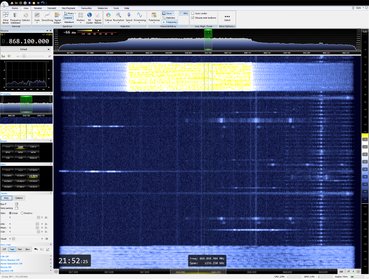

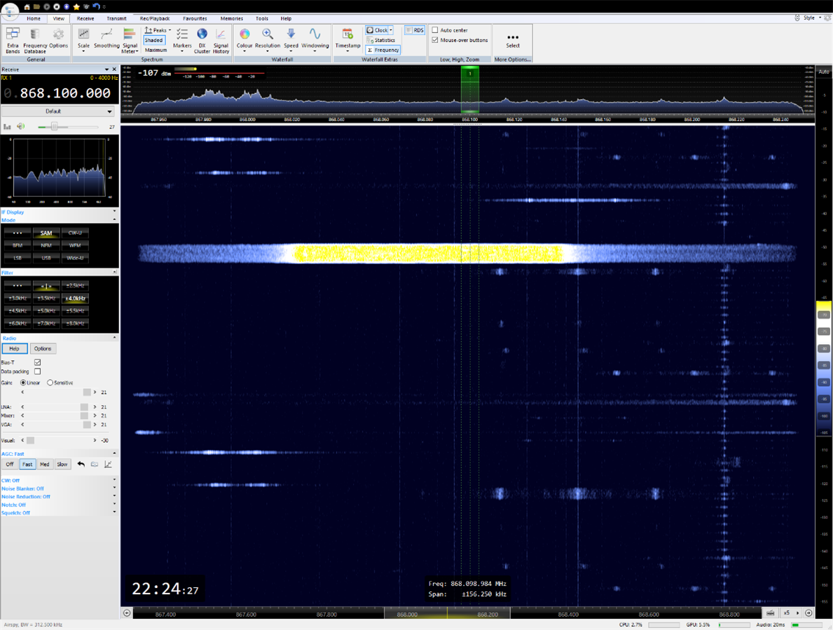

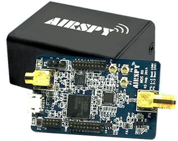

Debugging with SDR
Whenever I take on a new development environment I reach out for debugging tools. For the microcontroller the Otii Arc and Atmel ICE are examples. For LoRaWAN I have experimented with visualizing the radio signals using Software Defined Radio. So far I have a setup of the Airspy R2, a 868MHz filtered preamp from Uputronics and a omni-directional antenna Sirio OMNI 900. Using SDR# and SDR-RADIO I have been able to identify my transmissions. Although I can't decode the actual payload there are a few handy advantages in development:
  • Are my devices actually transmitting?
  • At what band/frequency and spreading factor?
  • Gauge approximate signal strenght
  • Airtime
  • Collisions
Another really valuable tool is to get a sense whether the device antenna is appropriate. I have gathered that a lot of (cheap) LoRa-devboards are sold with incorrectly tuned antennas. A spectrum analyzer would be a better tool, but my lab is missing this, for now.. image
I have made some attempts in actually being able to visualize the chirping of the signals. Without a spectrum analyzer I believe I need to use a transceiver that can transmit with SF 12 and 7.8 kHz bandwith to be able to see it live.
More on reverse engineering LoRa (not WAN).

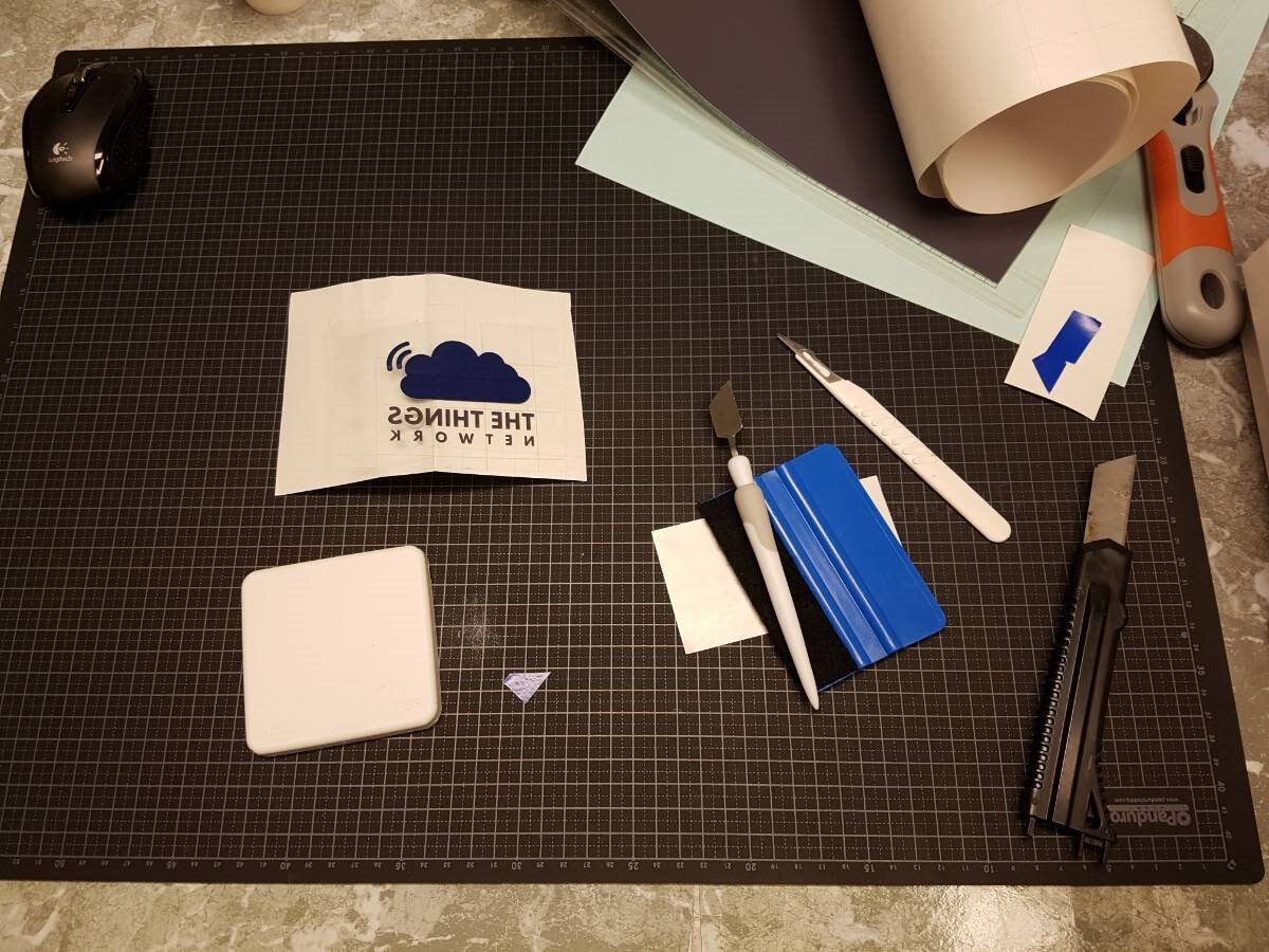

Enclosure

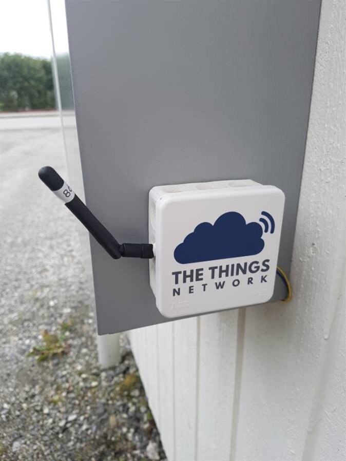

For the enclosure I have relied on a simple weather proof electrical box (ABB). It is IP65 rated, but after making holes for antenna, wire and screws I can see a tiny amount of dust has penetrated.The main thing is that it has not shorted or corroded the electronics. After  having heard Ben Ward talk about his experience with deploying home made sensors with the Oxford Flood Network, I do admit I was somewhat nervous if the bomb squad would be waiting for me when I got back after the first deployment.
A while later my local makerspace (Makerspace Bodø) bought a vinyl cutter, Silhouette Cameo 3, and this enabled me to make it look a bit less threatening. Please keep this in consideration if you are planning on deploying a project like this in public.
It consists of two layers of different color vinyl aligned with transfer tape.

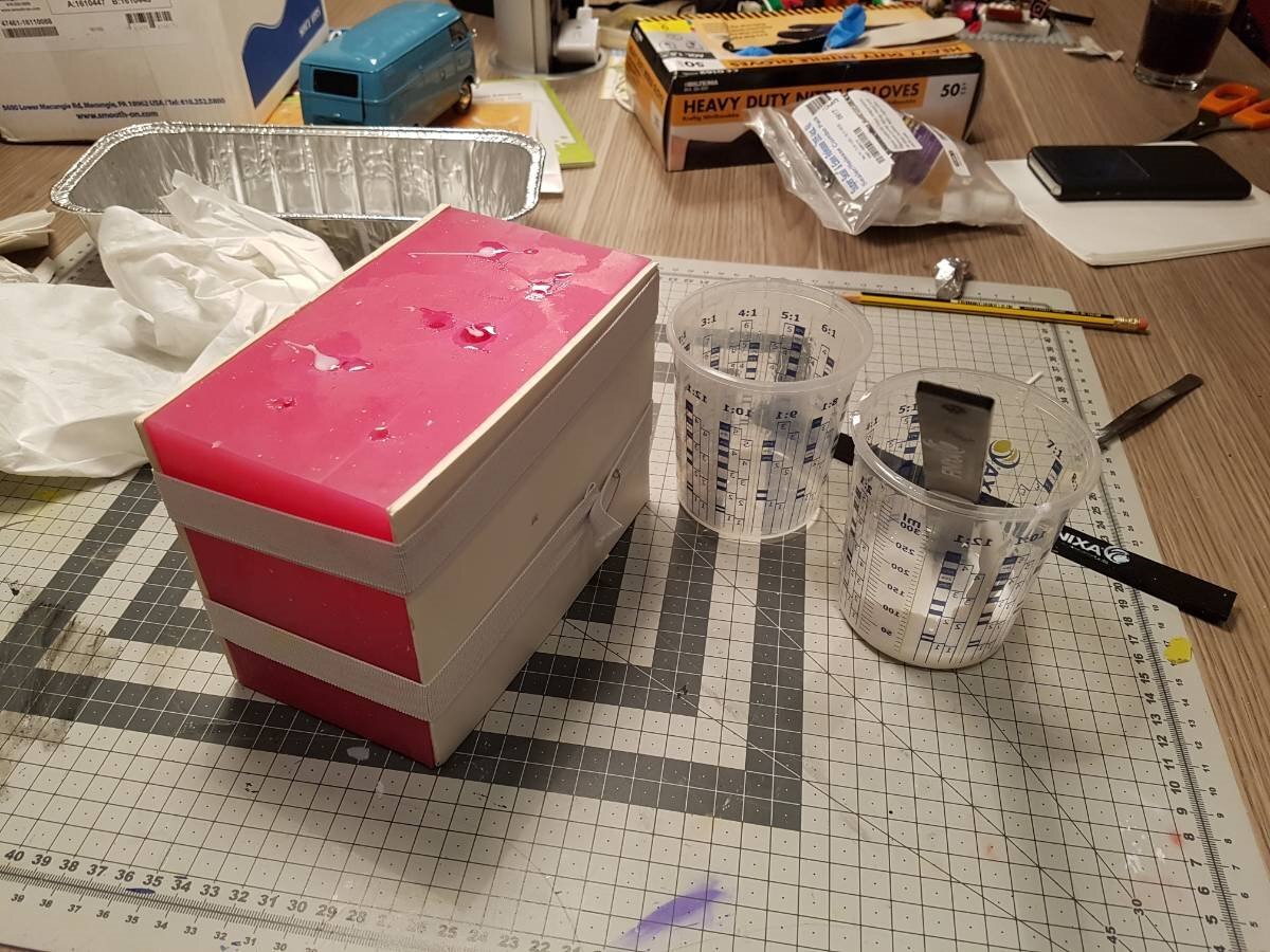

Resin casting custom enclosure
Update: I have written a blog detailing how I 3D-printed a custon resin enclosure.
Lastly I have started designing a custom enclosure. This will be 3D printed and sanded with filler before I make silicon molds. Then I can cast using resin. Here is a sketch of what I have in mind, including some teaser pictures of previous castings I have made for what's to come.
