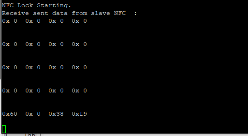

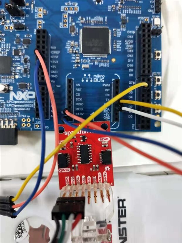

1. Brief
The NFC tag reader works on 125kHz, if read tag via I2C match the authorized ID, the lock is opened until next detection loop.
The servo used in this project runs with 50Hz PWM frequency and dutycycle  Percentage of 2.5% ~ 12.5%. In this design 5% vs 10% as On state and OFF state .
#define LOCK_ON 5
#define LOCK_OFF 10
Then update the PWM period for servo control.In which the last bit of rxBuff is set to 0xFF if the NFC ID is matched.g_master_rxBuff[I2C_DATA_LENGTH-1]g_dmvfvva g_master_rxBuff[I2C_DATA_LENGTH-1]ster_rxBuff[I2C_DATA_LENGTH-1]
updatedutyCyclePercent= LOCK_ON ? (g_master_rxBuff[I2C_DATA_LENGTH-1]==127):LOCK_OFF;
g_pulsePeriod = (g_pwmPeriod * (100 - updatedutyCyclePercent)) / 100;
2. Hardware
2.1 LPC55S69 dev board
2.2 NFC tag reader ID-12LA, on 125kHz
3. Main Code
3.1 With I2C and ctimer PWM, the NFC lock can be coded as follows,

    PRINTF("Receive sent data from slave :");
while (1)
    for (uint32_t i = 0U; i < WAIT_TIME; i++)
    {        __NOP();    }
    /* Receive blocking data from slave */
    if (kStatus_Success == I2C_MasterStart(EXAMPLE_I2C_MASTER, I2C_MASTER_SLAVE_ADDR_7BIT, kI2C_Write))
        reVal = I2C_MasterReadBlocking(EXAMPLE_I2C_MASTER, g_master_rxBuff, I2C_DATA_LENGTH - 1, kI2C_TransferDefaultFlag);
        if (reVal != kStatus_Success)
            return -1;
        reVal = I2C_MasterStop(EXAMPLE_I2C_MASTER);
            return -1;
    for (uint32_t i = 0U; i < 4; i++)
    //for (uint32_t i = 0U; i < I2C_DATA_LENGTH - 1; i++)
        if (i % 8 == 0)
            PRINTF("\r\n");
        PRINTF("0x%2x  ", g_master_rxBuff[i]);
if (g_master_rxBuff[i]== g_match_id[i] ){g_master_rxBuff[I2C_DATA_LENGTH-1]=127;}
    PRINTF("\r\n\r\n");
