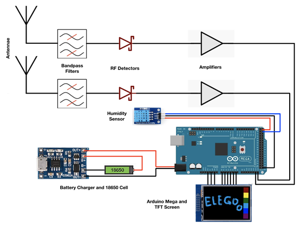

PDTect_RF is a detector that fits firmly into the first category. It allows large areas of switchgear and plant to be quickly monitored but will be subject to picking up noise around the area emitted by other RF apparatus. It can also be utilised alongside another detection methodology to give further indication that the activity may be genuine and warrants further investigation. As a guide, using apparatus that works to methodology 1, I can sweep a 20 bay high voltage distribution board within one to two hours using multiple methodologies. If I were to go straight ahead with the second methodology, that 20 bay board would probably take me a couple of days to collect data and analyse it.
Therefore the general methodology is to sweep apparatus rapidly with method 1 to identify potential areas that warrant further investigation using method 2.
There are numerous papers researching the RF wavelengths from partial discharge activity. The vast majority of my research for this project has come from the University of Strathclyde in Scotland in conjunction with a paper from The European Electromagnetics Conference in January 2019.
Partial discharge activity emits RF from in a wide spectrum from  low Mhz up into multiple GHz, dependent upon the type of apparatus and the type of discharge activity. Predominantly, I am interested in partial discharge activity in air insulated apparatus which puts my detection needs between 50 MHz and 900 MHz. At the higher end of this bracket, around 700 to 900 MHz the discharge tends to be surface discharge, usually referred to as corona. Below the 700 MHz band, the activity tends to be more representative of discharge within solid insulation systems. Above the 900 MHz, the discharge activity tends to be within gas insulated switchgear, as I do not cover much GIS apparatus, this current model of PDTect_RF will not include this band.
Construction

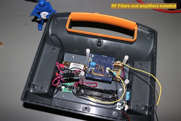

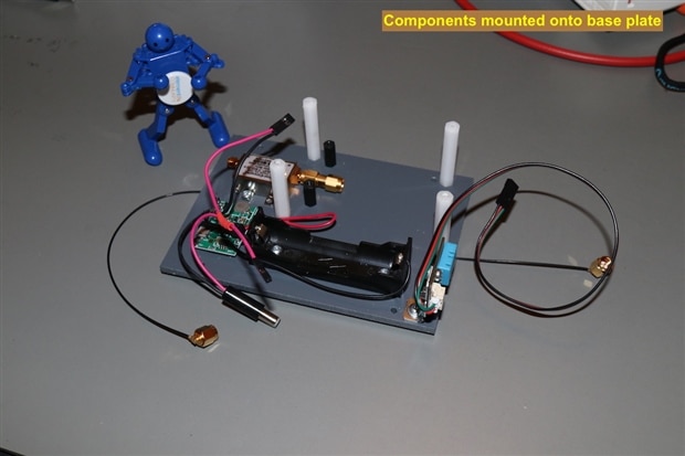

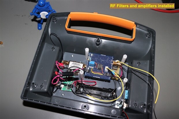

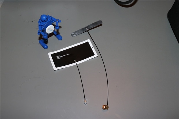

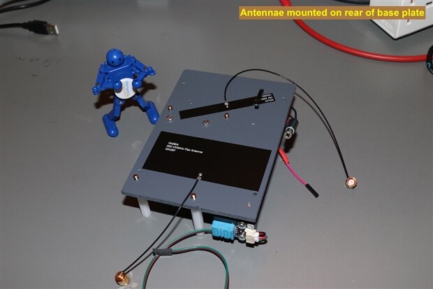

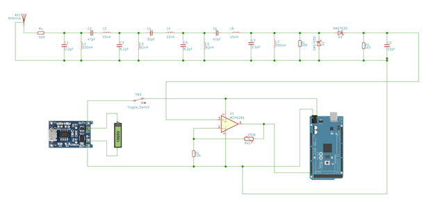

The construction of the detector is relatively simple, I plan to have to bandpass filters, one to cover 50 to 700 MHz and the other to cover 700 to 900 MHz. These will each feed into an RF detector, that will rectify the signals received. Each rectified signal will be fed into a signal amplifier to output a higher, more easily detectable voltage. The voltage will be read by an Arduino, that will display the reading in a graph format.
I had planned to utilise some of the antennae that Tariq had sent to me, but I am a little concerned that these do not have a wide enough bandwidth and would limit the response of the detector. I will carry out some trial with these antennae and may look for some wider bandwidth units to test alongside.

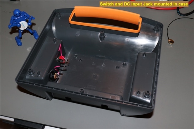

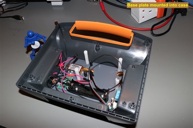

The unit will be powered by an 18650 lithium cell and I will utilise a remanufacture combined voltage boost and cell charger board I have in my collection action of parts. As partial discharge activity is greatly affected by ambient conditions, especially humidity, I am going to build own a DHT11 sensor unit into the device. AN Arduino Mega and 2.1" TFT screen will be used to display the data in a bar-graph style. To finish with, I have a nice carrytec case from OKW to try and squeeze it into. The basic concept is shown below.
I did carry out some design work for some bandpass filters as I have struggled to find pre-manufactured bandpass filters with the frequency bands that I desired. These were all 7 stage Butterworth filters. I did find a 600 to 900 MHz standard bandpass filter from Mini-Circuits, so opted to utilise this to ease the build process a bit with the added bonus that it has RF shielding, that I will struggle to manufacture. Below is the schematic of the 50 to 750 MHz bandpass filter connected to the amplifier and then Arduino.

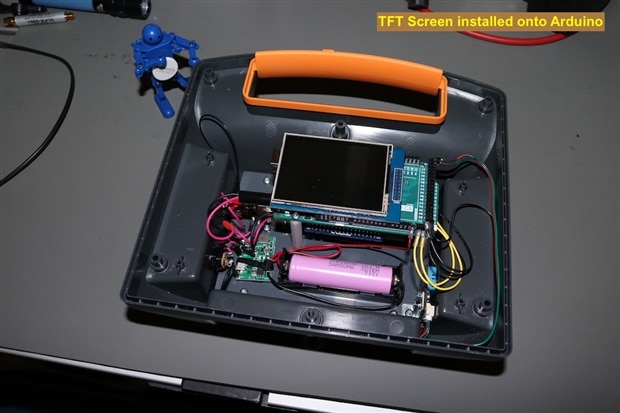

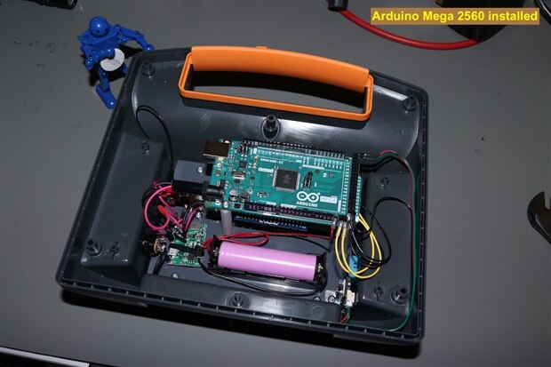

The following pictures show the build of the unit.
{gallery} PDTect_RF Build in Pictures
Switch and DC Jack Fitted to Case
Battery holder, charging circuit, RF Filter and humidity sensor fitted
Antennae fitted to rear of baseplate
Baseplate fitted inside case
RF Filters, detectors and amplifiers fitted
Arduino fitted
TFT Screen fitted

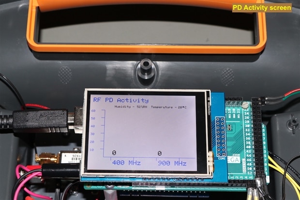

Arduino Code
The majority of the code for the Arduino came from a blog on the Arduino Project Hub - TFT Graphing: Bar Charts. The code is very clever and is basically a module that allows a bar chart to be personalised by modifying a few elements of the code and the module will do the rest. I have tweaked this to add in the code for the humidity and temperature sensor. At the moment this sensor is only read once just after the detector has started up.

At the moment I haven't made any really alterations to the code from the original other than to change the titles and the range to suit my application. The screen is actually very nice and clear when it is all booted up.
I have not had chance to set up a high voltage test and do some measurements, these take quite a while to arrange. I had tried some of the lower frequency meters that I have transmitting around it, but these did not produce any reaction so I may have some calibration to do with the amplifiers. I do need to set up some tests with the 3 Series MDO on high voltage cables, so I will hopefully be able to test with PDTect_RF at the same time.
