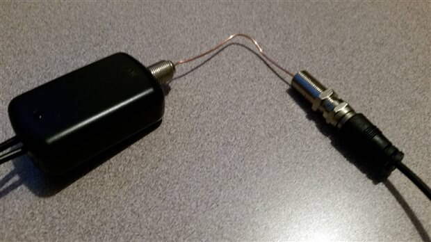

First off I thought I would try the old fashioned VCR with a powered antenna.  This didn't work but it probably could have but due to not finding the issue in my powered antenna this was passed over for now possibly revisit this again after.

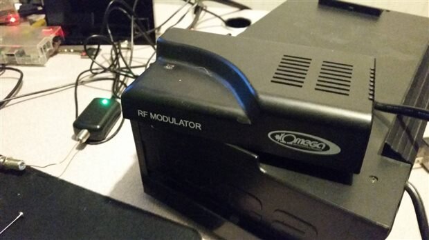

Secondly I decided I would try a RF Modulator with the powered antenna on it.  Even after finding the fault in my antenna this didn't work  I had plugged RCA out from the pi to RCA in on the modulator then on the coaxial the powered antenna.
Seems I got a lot to learn when it comes to RF but sure if fun to play with.  Slowly finding more and more connectors and items while working on this project seems I had more thing then I thought that would be useful but will visit that down the road when experimenting a bit more.

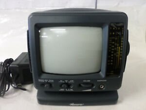

The tv I used is silver but the same as this one here.

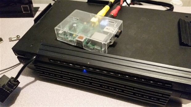

So with the raspberry pi connected to the icc2 (integrated command centre)  to the input we then plug in the antenna to the tv out on the coaxial rf.  I thought at first I would run it through the RF Modulator then into the ICC2 but after testing it wasn't going to work I thought I might get a bit of a power boost that way.

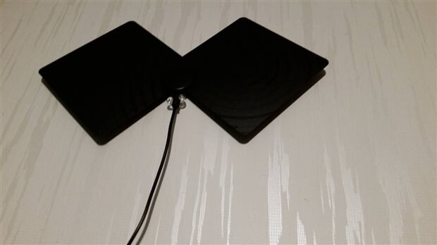

I had issues with the antenna and I really wouldn't suggest anyone buy it here is a link to it just for reference of what not to buy.  https://www.amazon.ca/gp/product/B07CLGB8WY
So after testing and pulling it apart the only simple solution to get it working was this.

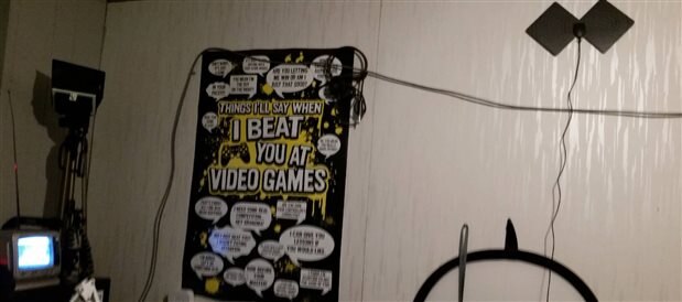

I mounted the antenna on the wall in my office as high up as I could cause that just made sense to me and its just a odd antenna in my books.
OK so when I was first testing I did run a coaxial cable from the tv out and then was able to touch the antenna so that I could tune in the channel before seeing if I was able to broadcast to it without any cables this worked but i noticed the tv might have seen better days as well.  I thought I had another around but I must have put it in the recycling pile at some point since I had 3 of these tv's just laying around forever.  You just never know when a project comes up and you want to use them right?

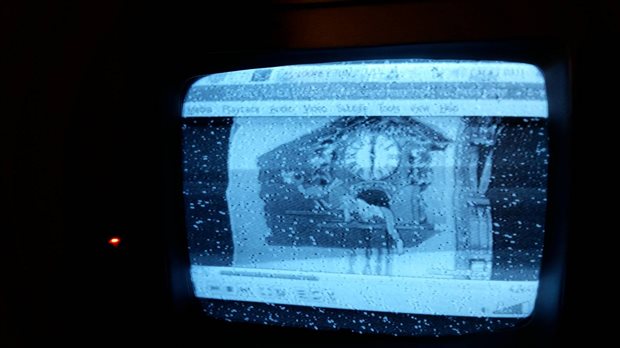

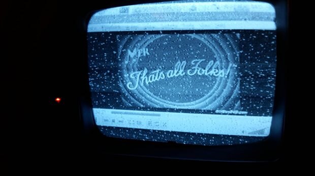

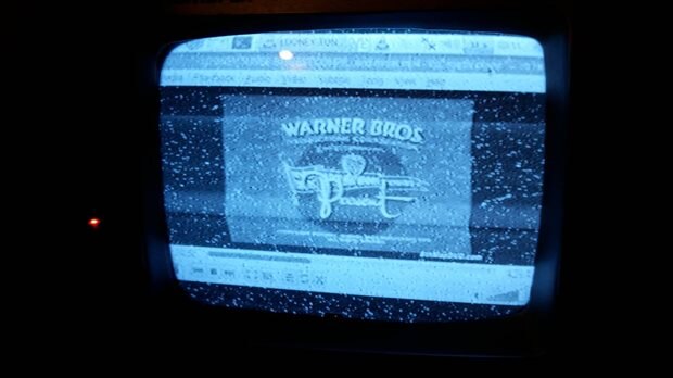

Now it was on to the moment of truth with how well it ended up looking.  Now I know there is lots yet to explore and play around with which I will get to as I am  having lots of fun with it and love being able to broadcast on older equipment you never know what will end up on the bench that might require some old school flavor.
Well that's not that bad I wasn't sure I was even going to get to this part as I have just been playing with this in my spare time. I had planned to make my own antennas and try to make something a bit more portable but that will come in time as I learn more and more cause really there is just so much I had forgotten and so much I didn't know that I have to learn now.
So possible options going forward would be to attempt to try on the VCR again I did have a VHS playing (flash dance) which was pretty clear when I first attempted to run coaxial to the antenna so will have to see on that.  I would love to just build my own board and powered antenna's that is on my list of things to do for sure.  Now I might not know as much as most on the subject I have to say its still fun to play with and with parts that I had laying around plus a junker antenna from amazon I was able to get it working.
I would certainly like to test on a few other TV's as well as I really do think there is something up with my TV.  There we go a pi1 still working away broadcasting some good ol WB Cartoons. There is lots to learn and lots of fun to be had with playing with old equipment but for now until later......

    I wasn't sure what the ICC2 was, not much info on it via google search! I believe it is a product with a modulator though, right?
    If so, the results you're getting are pretty good, considering they are designed to be low-power. It's nice to see the old-school snow on the TV signal : )
    As you say, it's great that you now have a setup you can experiment with, to see the effects of antennas and so on.
