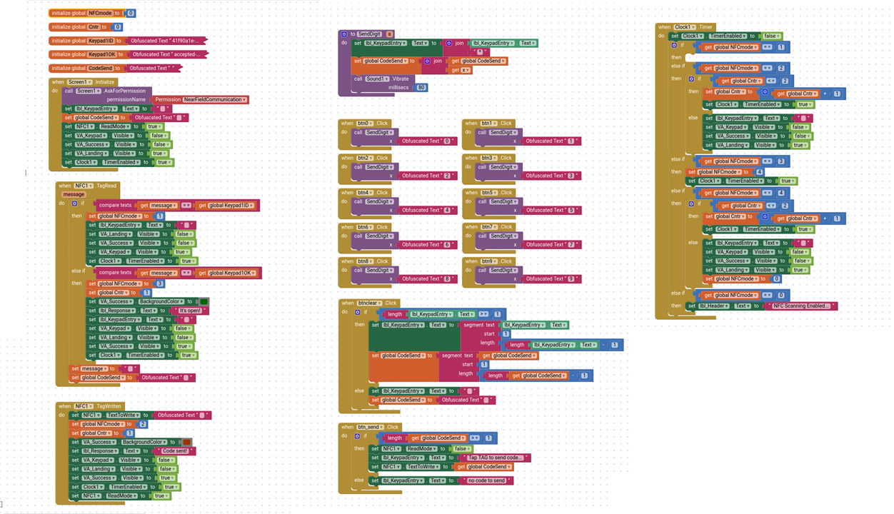

  • Building the virtual keypad Android app

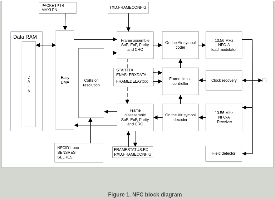

Now, what’s far more interesting is how the payload data is stored in memory and how it’s then used by the NFCT peripheral driver.
The nRF52 NFCT peripheral driver uses DMA (direct memory access) to store NFC data when powered then you have to explicitly write this data to flash memory for storage after power down. In other words, nRF52 NFCT memory access behaves very differently to say an NXP NTAG or a ST25DV NFC tag, which uses EEPROM for general data storage or SRAM in pass-through mode.
This can be seen in the callback function within the Writable NDEF Message example. When the NFC_T4T_EVENT_NDEF_UPDATED event is triggered the data written to the nRF52 device via the wireless NFCT antenna is already stored in DMA. If you comment out the line err_code = app_sched_event_put(NULL, 0, scheduler_ndef_file_update); and then rerun the example you will be able to read the updated data following an NFC write event.
If you then restarted the nRF52 device the original data will then reappear as the previous NFC data write was not stored in flash memory, which would’ve been handled by the scheduler_ndef_file_update function.
Thus you now have an opportunity to receive data via NFC DMA, store it elsewhere for later analysis and then internally change the NFC DMA data so that the next time an NFC read event occurs the written data is out of sight (i.e. hidden from view).
So essentially that is how I used this logic to create my virtual keypad logic.
You will see in the demo that the data sent cannot be viewed and all you see is the token or an indicator that the relay has been activated.
Anyway, further information about the NFCT functionality is provided here: https://infocenter.nordicsemi.com/index.jsp?topic=%2Fcom.nordic.infocenter.nrf52832.ps.v1.1%2Fnfc.html
So in summary, with the nRF52 NFCT peripheral driver you essentially get easy direct access to nRF52 memory blocks as a pseudo pass-through method, which, as I discovered, allows you to use NDEF messaging capabilities to transfer data with a NFC-enabled mobile phone. You certainly cannot readily do this using NTAG’s or ST25DV tags and a common NFC mobile phone app, as these tags use specific memory registers to handle pass through mode and as such you would need to create a low level NFC mobile phone app to enable data transfer to these specified memory registers.

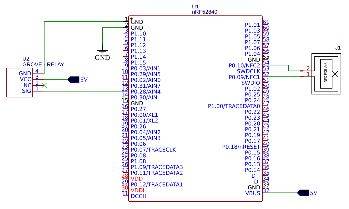

PAN1780 (nRF52840) Firmware
Let’s now dive into the hardware and the firmware.
I had road tested the Panasonic PAN 1780 Bluetooth LE Eval Kit 2 years ago and this evaluation kit included a great NFC antenna.
So I decided to use this evaluation kit to develop my proof of concept design. All I added was a SeeedStudio Grove relay, which required 5V as VIN and one GPIO signal to control the relay trigger.
This evaluation board proved ideal as it also includes a JLink interface so you literally just plug in a USB cable and you are good to go.
For the firmware development, I used Segger Embedded Studio - please see my road test report for further guidance.
As alluded to earlier, the firmware is based on the Writable NDEF Message example. I added in an additional timer component to handle the relay activation trigger and then the timed deactivation.
For purposes of this project demonstration, the encryption part was excluded.
For my proof of concept I wanted to keep things as simple as possible.
As such, I decided to use MIT App Inventor to develop my Android app as it provides a very simple Near Field communication component that will read and write NDEF text messages.
In fact this limited NFC functionality is ideal for my purposes because if the app detects say an NDEF URL message, which I do not need, it simply ignores it and my mobile phone then triggers an alternative NFC enabled app to read this message.
The only logic required is determining when to switch from NFC read to NFC write and vice versa.
The screen design is very basic in that all I need is a table to mimic a keypad. Here I simply used buttons.
Then it was on to testing. Now NFC you cannot use emulate mode. This applies to all IDE's. including Android Studio. You have to build your firmware and side load it onto the phone using the adb install command in your computer terminal.
Demonstration
The first demonstration shows how you can overwrite any NFC write event data so that only an ID value is visible on future NFC read events. The video also shows how the firmware checks the written data to see is a secret keyword has been entered.
The second demonstration shows the Android app in action.
