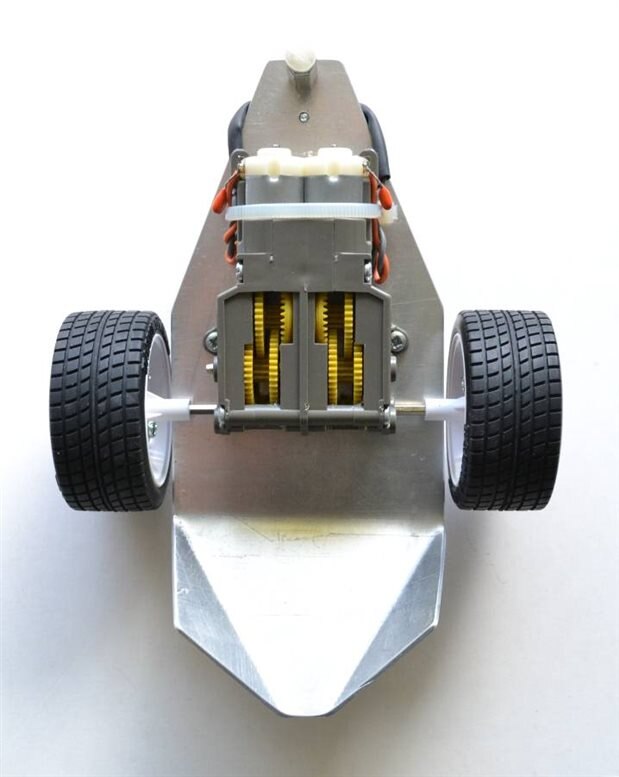

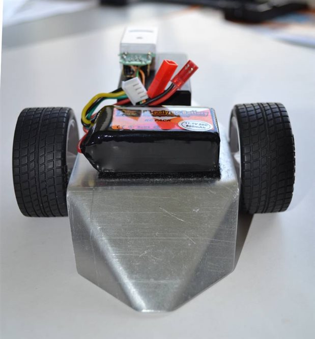

Chassis
The chassis is a lightweight wedge design.
The idea was to lift the competitor rendering them immobile and therefore securing a victory.
I made it oversized and then flipped it upside down and scribed the finished height with a small taper towards the rear.
It is configured as a "tail drager" which is a term used on planes where the tail is supported by a piece of metal and is dragged across the surface, rather than having a proper wheel.
In this case I used a plastic bolt and rounded and smoothed it using a battery drill.

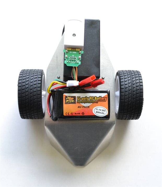

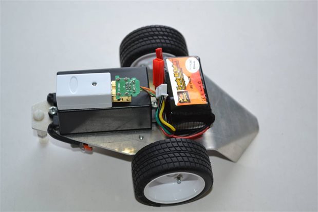

Electronics
The black box houses an Arduino Nano, and some Mosfet driver IC's.
The pictures show an 11.1 volt Lithium battery, but it works on a 7.2 volt battery which is lighter and allowed it to weigh 305grams.
The higher voltage battery was an attempt to eliminate a glitch that caused the loss of connection between the Nunchuck joystick and the receiver.
Sadly it also overtaxed the original mosfet drivers which emitted the magic smoke and stopped working.
