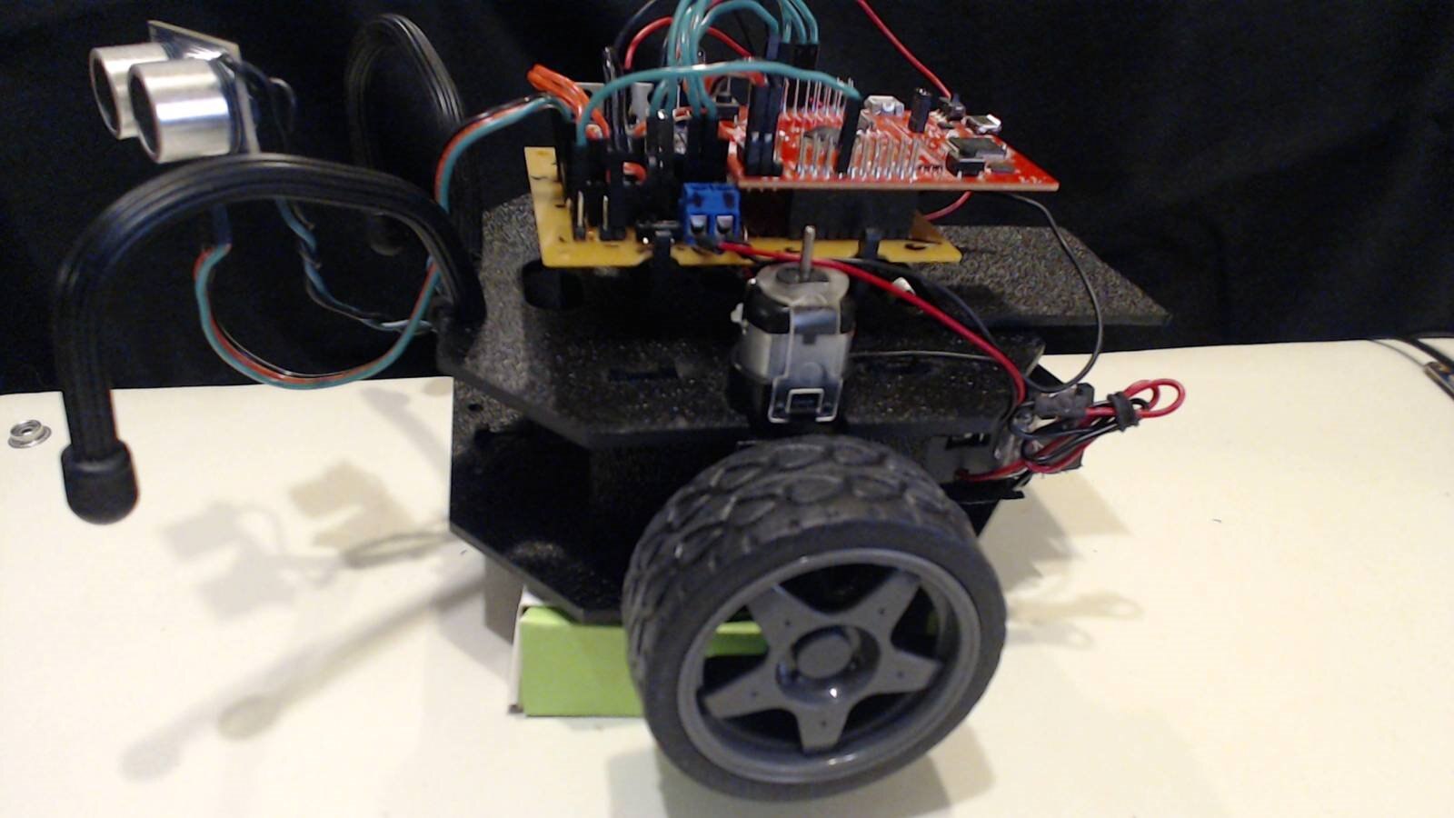

This is my entry into the Robots On Wheels Project14 contest. The PWHBot will be designed to self navigate an area and report its location as well as environmental conditions back to a central node using MQTT. The main brains of the Bot is a TI4C123GXL launchpad that is programmed in bot Assembly and C code. This thus far controls the motor direction as well as the Ultrasonic Sensor (Ping Sensor) located on the front of the bot. IR sensors will be added to enhance the obstacle avoidance capabilities of the bot and a GPS device will be added to collect the bots location. A CC3100(or perhaps CC3120) booster pack will be added for WiFi connectivity which may require a separate board to control such as a MSP432 or MSP430FR5969. I currently have a Pine64 running the Mosquito MQTT Broker as well as Inductive Automation Ignition Edge and intend to use this to keep track of the Bots location and data.

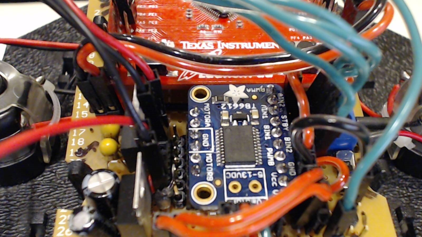

View of the Chassis with Tm4c123GXL and custom perf board installed. I created a board so the Lanchpad could plugin rather than just hang off the end and then added the Adafruit TB6612 H-Bridge along with 3.3v and 5v regulators to step down the 7.2v that is coming from 2 -3.7v Li-Ion batteries. This supplies 3.3v to the Launchpad and 5v for the motors, Ping sensor and IR sensors.

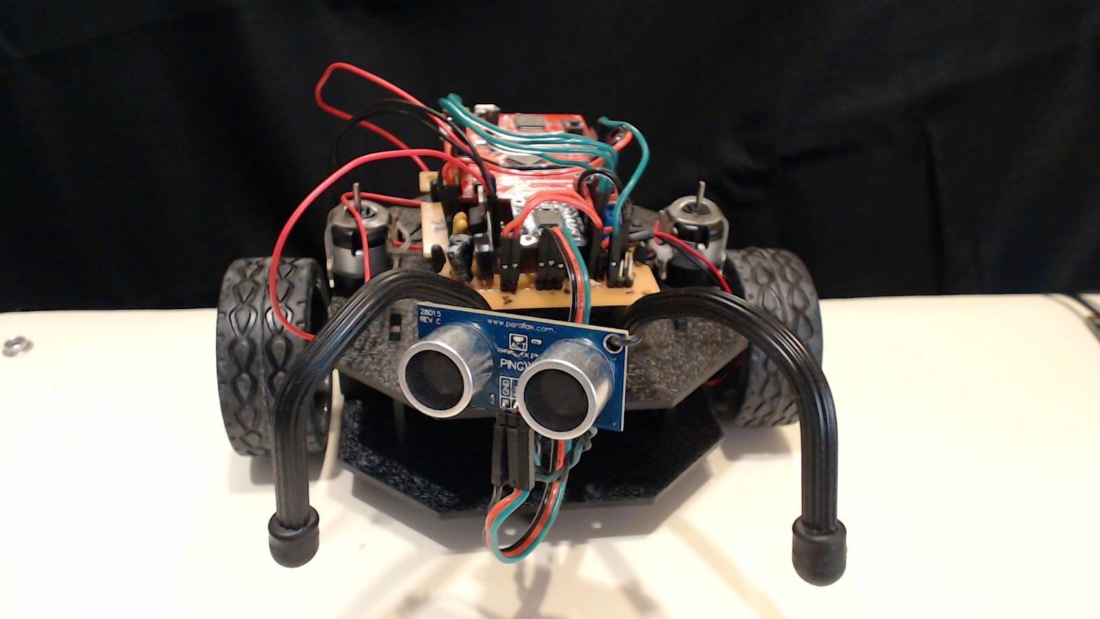

Front view of PWHBot showing Ping sensor and IR Sensor arms.
Close up of Adafruit TB6612 H-Bridge mount on custom board as well as voltage regulators and added headers for connectivity.

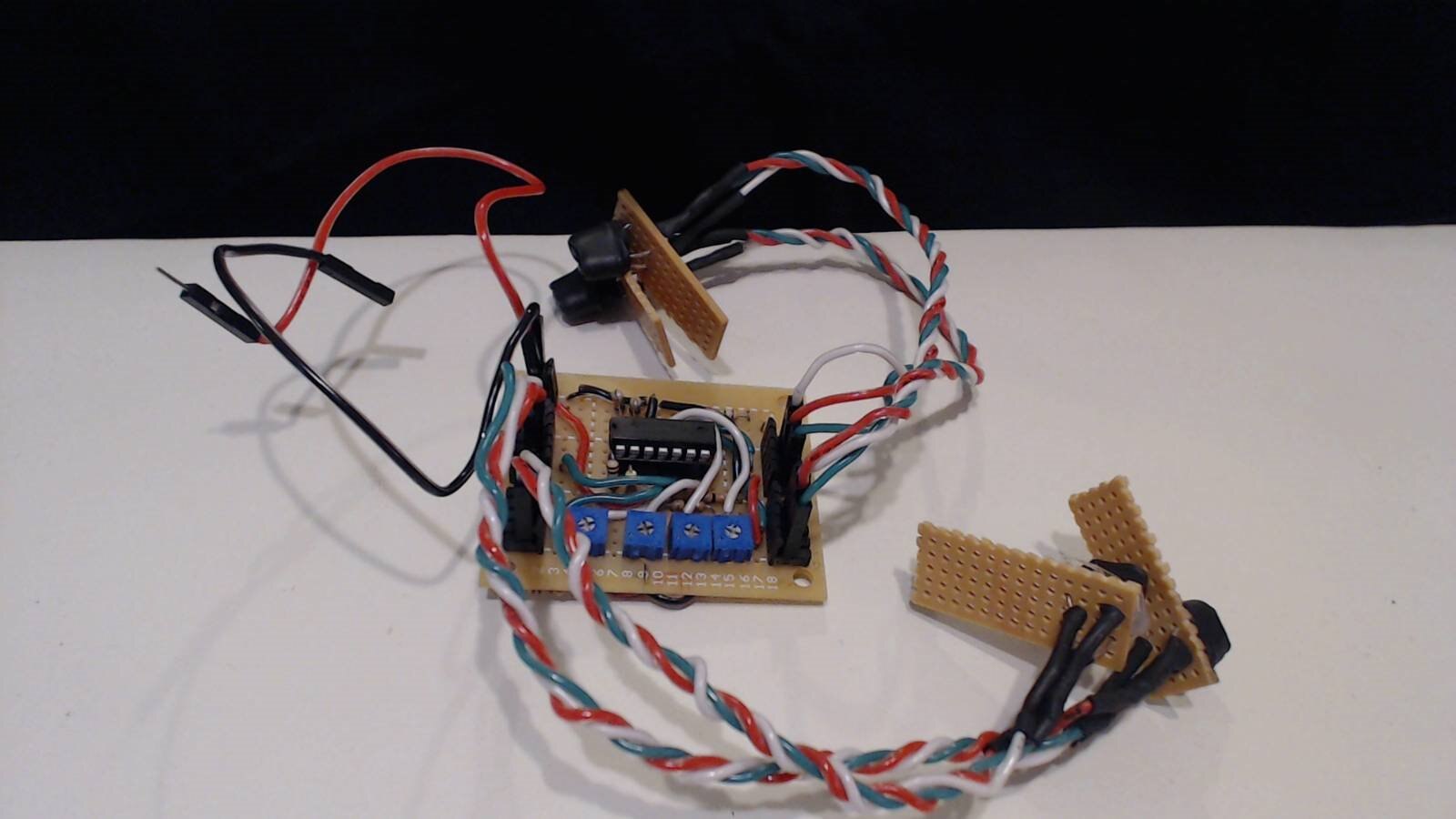

IR Sensor board using a LM339 Quad Comparator  DIP

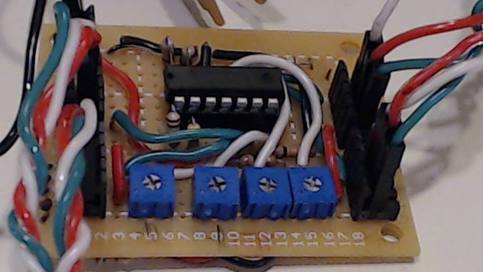

Close up of IR Sensor board

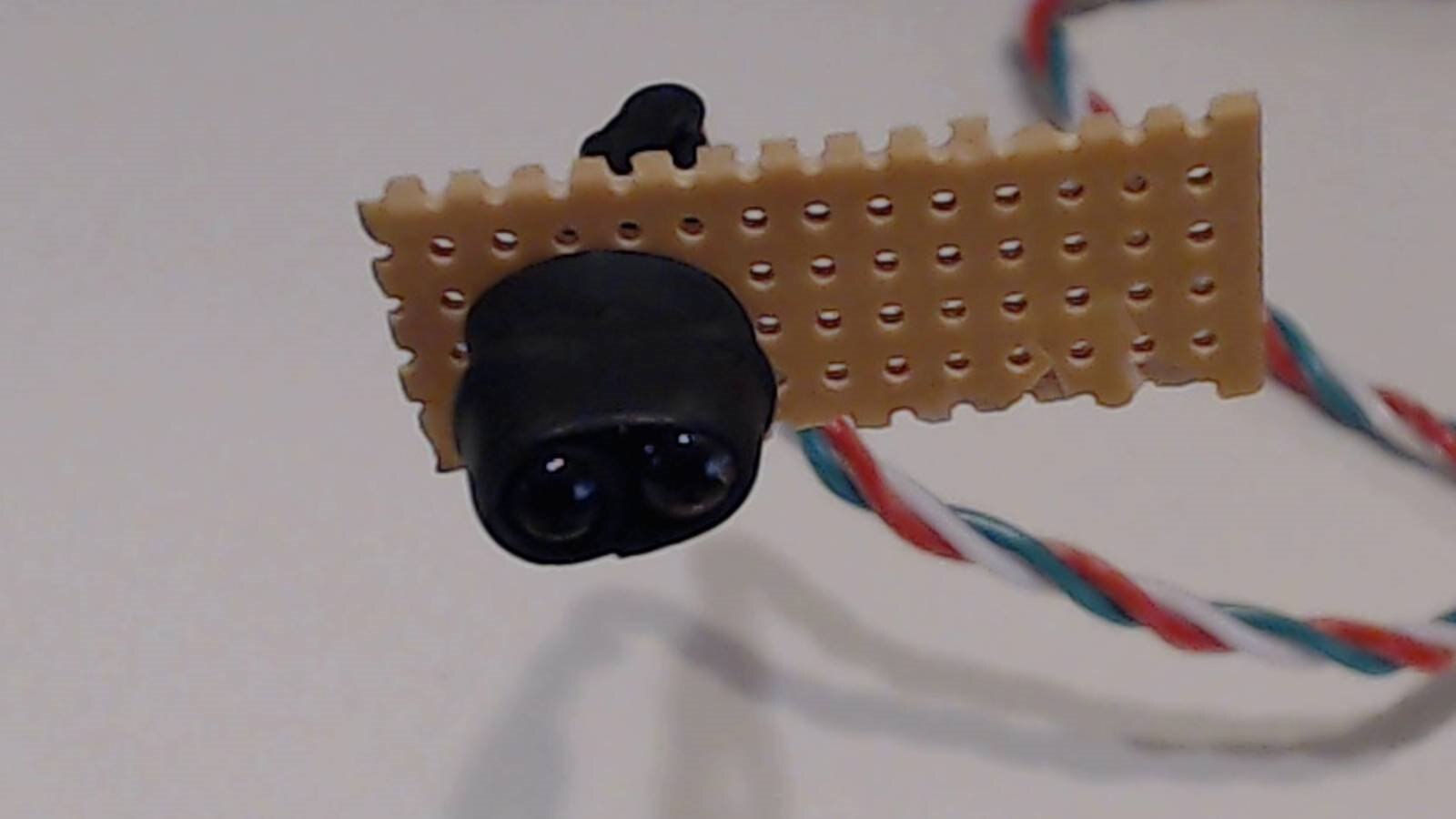

Close up of IR Sensor using a Infrared LED and a Phototransistor wrapped in Shrink tubing
