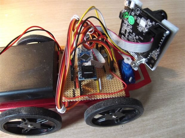

The journey for RoboBobLet for the Robot with Wheels challenge has come to an end for me as there is no more time left. I added V53L0X laser rangefinder to the 3D printed front piece added to the front of the Pixy camera and connected everything to the Nano. Apart from one head-scratching moment when one of the mounting pillars for the strip board was shorting two of the SPI signals (which prevented the Pixy camera collecting data) this final assembly went together quite easily. I would like to say this was the result of good design but I think it was more likely just a coincidence. Below is a photograph showing all the connections at the back of the Pixy camera. You cannot see what is connected to what but I thought I would put this image in to give some idea of the wiring complexity for this final assembly.

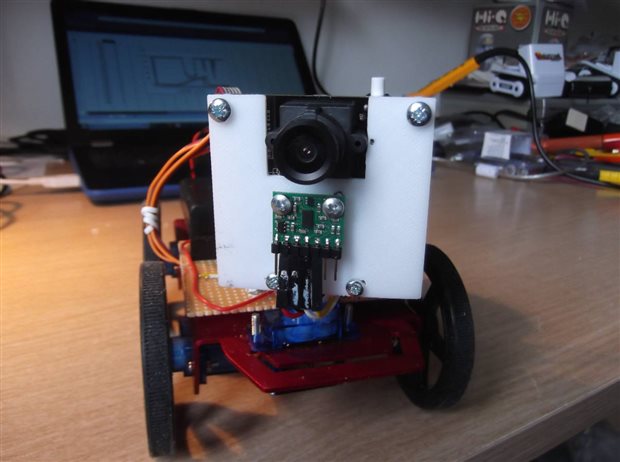

The next image shows the front of the Pixy camera. The white is the 3D printed front piece that fixes to the mounting holes in the Pixy camera. The lens of the Pixy camera is the squarish black plastic object at the top and below that is the V53L0X laser rangefinder sensor. I mounted them in this manner so that I could obtain range data for whatever the Pixy camera was pointing. at

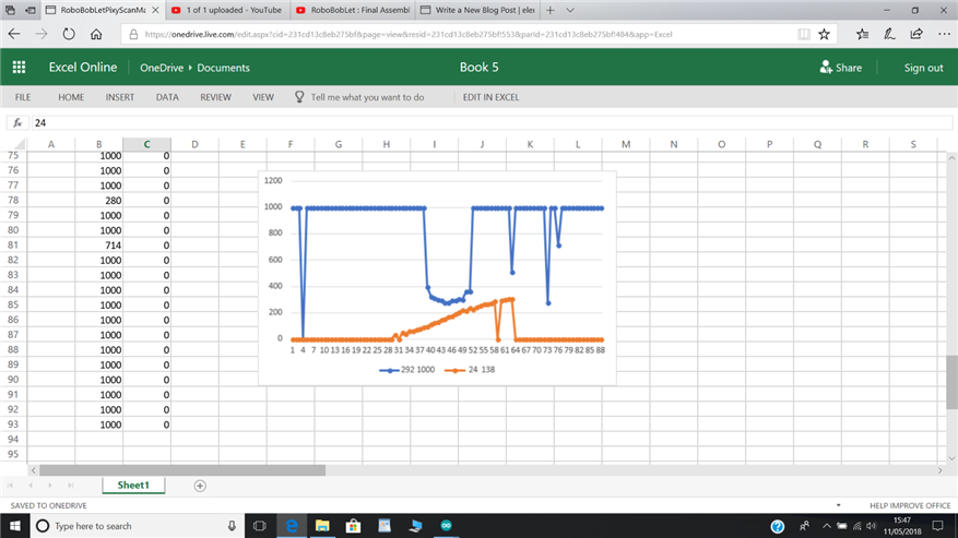

The Pixy camera was trained to detect blue objects. I chose blue because I had a number of children's wood toy bricks painted blue, so I knew they would all be the same colour, shape and size and this simplified the programming requirements. It is always good to start as simple as possible and work towards realism. The existing programme was amended so that when scanning the laser rangefinder through 180 degrees it also checked the image from the Pixy camera and displayed the X coordinate of the first detected blue object. The X coordinate is in camera Pixels which has not yet been related to the scan angle or the RoboBobLet chassis orientation. I made sure that there would only ever be a single blue object to be detected and this avoided all the problems that could occur with multiple objects. Again, multiple blue objects is something that  could be considered later. If no blue object is detected then the X coordinate value of 0 is output to identify this situation. The screen dump below shows a plot of laser rangefinder distance and blue object X coordinate, both plotted against the scan angle.
The top blue plot is the laser rangefinder data and shows the typical data obtained from scanning a single object. There are some spurious single anomalous ranges showing as downward spikes, which is much as seen previously. I did not make any attempt to filter these out as time has run out. Below in orange is the plot of the X coordinate value which effectively appears as a ramp. This is because as the camera is scanning it will detect the blue object at some point so the X coordinate will increase above zero and the edge of the blue object will then progress in a mostly linear fashion across the camera area until the blue object disappears out of view on the other side of the camera image. The blue object was placed at a distance of approximately 300 mm directly in front of the RoboBobLet chassis and this is illustrated correctly in this data. The spike in the camera X coordinate is probably due to lighting effects or maybe just not detecting the blue at that specific moment. Getting the Pixy camera to provide stable results was a challenge as it seems to take at least four consecutive sets of readings taken in quick succession before the image data would stabilise.

    I'm curious if the camera or the Laser determine where you should aim?
    This suggests that the camera needs more time than the laser to identify the target, which tends to make the Laser information important.
    There is no mention about the power supply.
    One of the things we constantly run across is issues whenever a motor is part of a project.
    The solution is usually a rather large capacitor across the supply line.
    Nano's tend ot have very little onboard power supply filtering, and I suspect you'll find the supply line is quite 'noisy' (electrically).
    This may account for spikes and other unexpected results.
